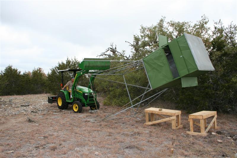

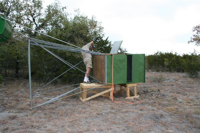

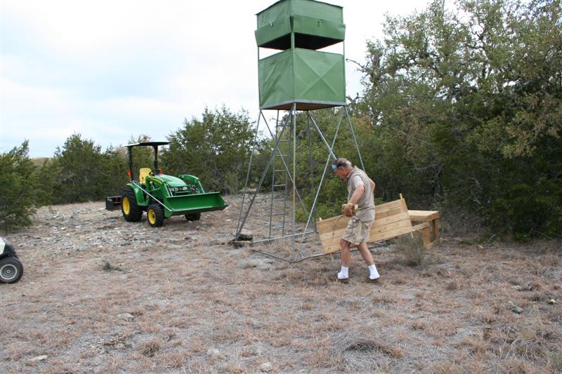

I have seen pictures of someone doing the same thing, I will see if I can post the pictures...........
