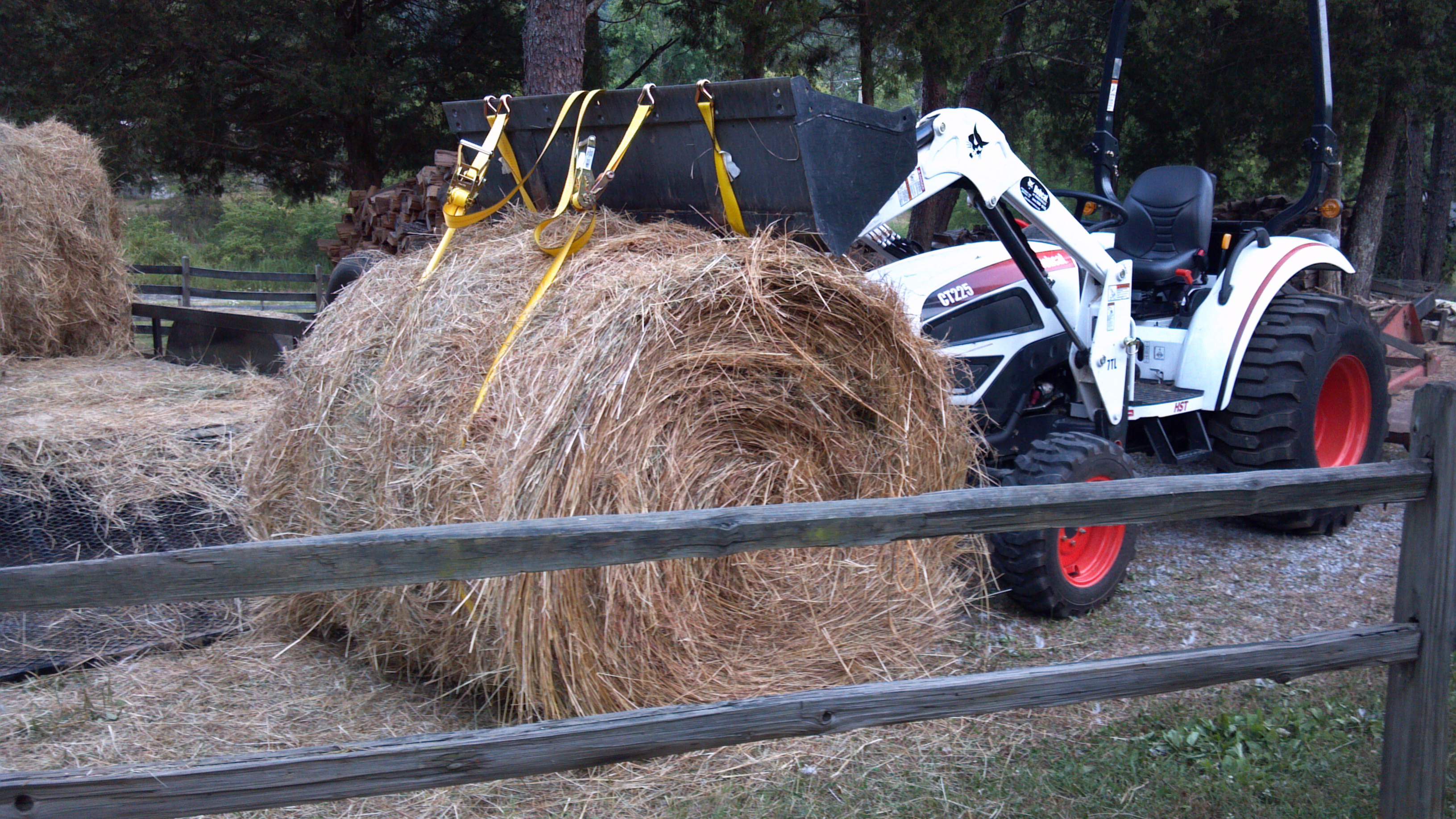

I bought five round bales today and brought them home on my trailer, stacked three-and-two. The top two were (relatively) easy. I parked the truck parallel to the trailer and tipped them into the truck's bed. One, I did with ratchet straps and elbow grease. The other, I tipped some of the way, but it wouldn't finish going, and I didn't have enough extension on my loader to push it, so I hooked it up to the drawbar with a ratchet strap and pulled it over.
The bottom three were going to be a trick, though. In the past, I have handled round bales either by buying them one at a time and shoving them out of the truck wherever they were meant to end up, or parking the trailer as close as possible to where they were meant to be stored and then rolling them into position by hand--sometimes with the help of another person, and occasionally a long pry-bar. It was a lot of work, I don't have to tell you.
One of the things I had hoped to use my tractor for was moving these bales around, but there just hasn't been money in the budget yet for a bale spear. But I got to thinking and applied a little git-r-done. See what you think.
First, I laid some 10k ratchet straps down.
Then I rolled the bale off the back of the trailer, onto the ratchet straps. For the last one, which was all the way at the front of the trailer, I used the loader to lift up the front of the trailer a few feet, so it was easier to roll off. (Don't worry--I chocked the wheels real good before doing this, to avoid any seesaw surprises.)
Next, I pulled the tractor up to the bale and hooked the ratchet straps to the bucket. I curled the bucket all the way to try to limit the amount of stress on the bottom plate of the bucket.
Finally, I moved the bale into position and disconnected it.
As you can see, I put the bushhog on the back of the tractor for ballast, and I'm glad I did, because even with it, if I accidentally moved the loader a little too fast, the tractor definitely got bouncy. I actually intentionally lifted and then jerkily dropped the bale a few times on level ground, just to get a sense of how tippy the tractor really was. It seemed to me like having the loader up high was a risk, but on the other hand, the bale is below it, so I wasn't really sure what the net effect on lateral stability would be. Regardless, I moved at a snail's pace on any part of the property that had any sideways lean at all, and at a turtle's pace everywhere else.
It seems to me like the biggest risk of this scenario is that the bale might get to swinging and cause more of a shift in balance than the operator might expect. I dunno. What do y'all think? Was this an example git-r-done ingenuity, or just a dumb-butt trying to get himself killed?
One other question: I have contemplated whether my loader really has the capacity to lift a round bale. It's rated at just over 1,000 lbs lift capacity (to full height at 500 mm forward of the pins). Seems to me doing it my way puts all the weight at that 500mm-forward-of-the-pins position, but if I was using a proper bale spear, a lot of the bale's weight would be much farther forward of the pins, putting a lot more leverage on the loader. I wonder whether, if I was to get a bale spear, I would need to get a 3ph spear instead of a FEL one. What do you think?

On the strapping, looks like you dodged the bullet with the straps. Looks like you had them going right across the cutting edge of your bucket, so you are very lucky that you didnt cut your straps. You can carry more weight on the 3 point hitch if you are able to get to them with your tractor. With my B-I-L, his were stored under a low shed that he could only reach with the FEL so the 3 pH one was of no use.
I think you're mis-interpreting the picture. I had the hooks hanging off the cutting edge, making a cradle under the bale, but the straps never crossed the cutting edge. I think what you may be seeing is the loose end of the strap, which I tossed up into the bucket just to keep it from getting tangled in anything.

I was not convinced that the baling twine would hold the weight of the bale. I used the baling twine as a tie-off point to tie a ratchet strap to when I was tipping one of the upper bales into the back of the truck, and the twine snapped. Granted, if I did it your way, it would spread the weight out over three sets of twine, but then again, what I was doing was just tipping the bale over, not lifting it.
It's a good idea, though. The straps were cinched up reasonably tight, but the bale was definitely more "cradled" than strapped up.

We have the same tractor and I handle round bales. Take it from me, do not waste your money on a bucket mounted spear. I tried it with 4x4 rounds and at first seemed to work fine, the next time I went to feed 1 I couldn't figure out why the tractor wouldn't move. I had the front wheel drive disengaged and was spinning the rear tires. The first time I was running around on the front axles and didn't realize it. If you do not need to stack the bales and getting them off trailer like you did is not too much trouble then get a 3pt spear or fork. Even if you do get a loader mounted spear you will need much more rear weight than the cutter has. To keep correct ballast for saftey and mimimize load on front axle, to carry that 1000+ lb. capacity calls for 880 lbs. on the 3pt.
Hmm... right. And honestly, of all the things I could spend money on to put on the 3ph, a ballast box is pretty low on the list. I'd rather get something I could work with, like a box blade. These bales are, hands-down, the heaviest thing I have so far considered lifting with the loader. The flip-side is, if I use a 3ph mounted spear, I don't need to max out the ballast. Ehh... I don't know. I really ought to have a ballast box, as much as I use the loader.
