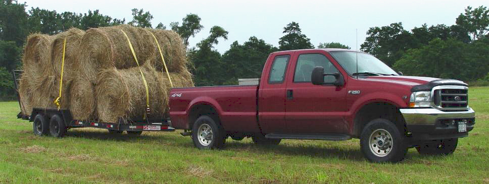

Robert, would you be using a 20 ft flatbed and stacking them 2 high?
That would be 4 double rows on the lower level = 8 bales and 3 double rows on the upper level = 6 bales, for total of 8+6 = 14 bales in one load with a 20 ft flatbed.
Just curious... I recently purchased a 20 ft flatbed and am thinking that is what I can load on it.... haven't gotten it back to the place yet to try.

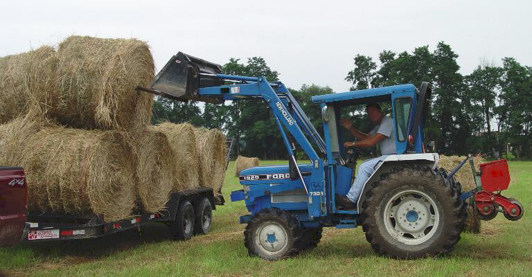

The bales are just over 4' diameter. But yes, they were double stacked but on a 16' trailer. Here are a couple pics. If I was using any larger of a bale I would have needed an over the axle trailer with a 8'6" flat deck. But these bales were going into a vineyard so they needed to be narrow.

This is how we do it now. Hook one on the 3pt, pick one up with the loader, load it then drop the other on the ground and load it later but it is already at the trailer. What I do is drop 3 of them in a line so it is easy to pick up and swing onto the loader. Usually as I back away from the trailer and turn a 90 to head back into the field I drop the arms and let the bale come off as I pull away.
