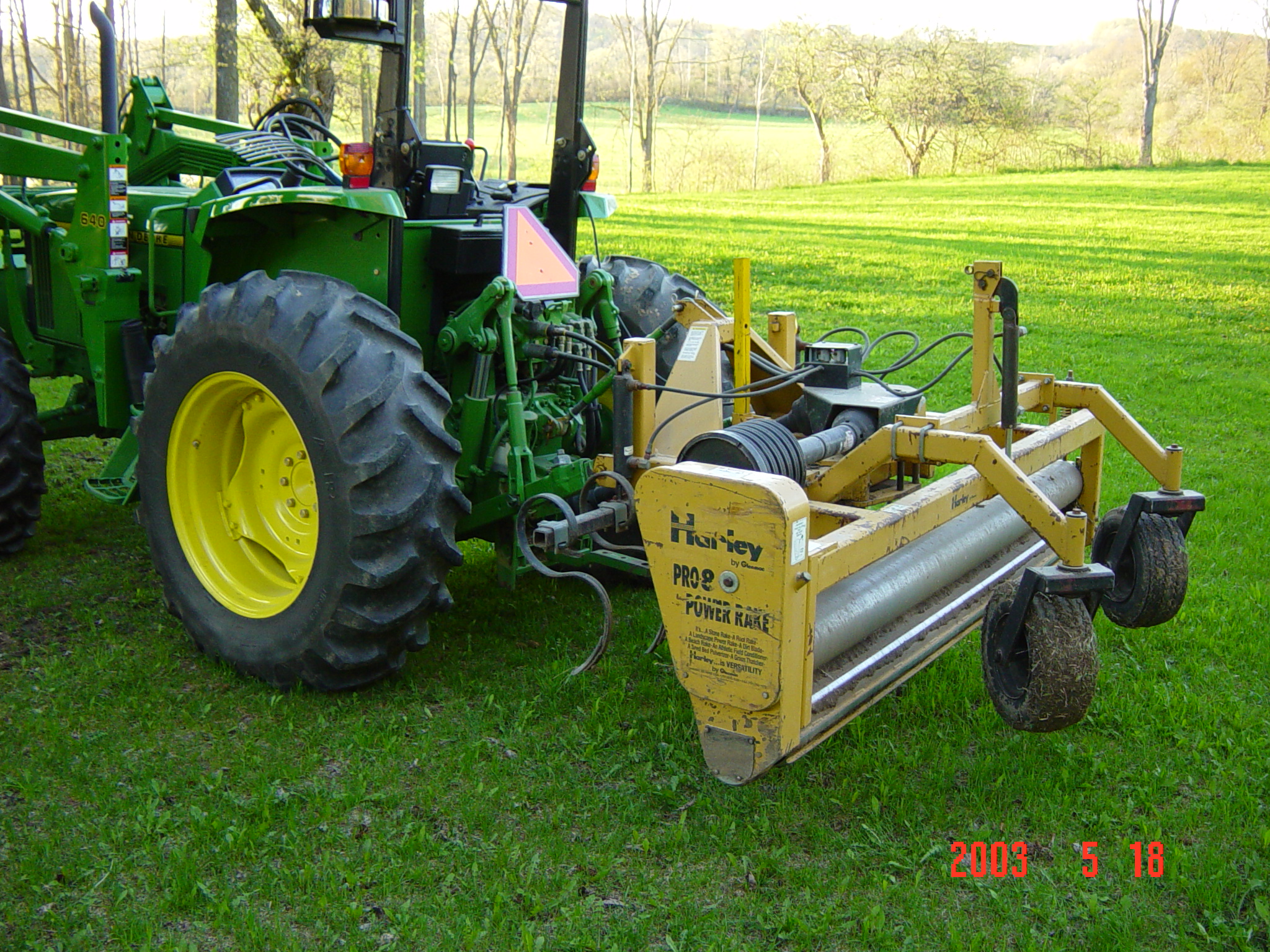

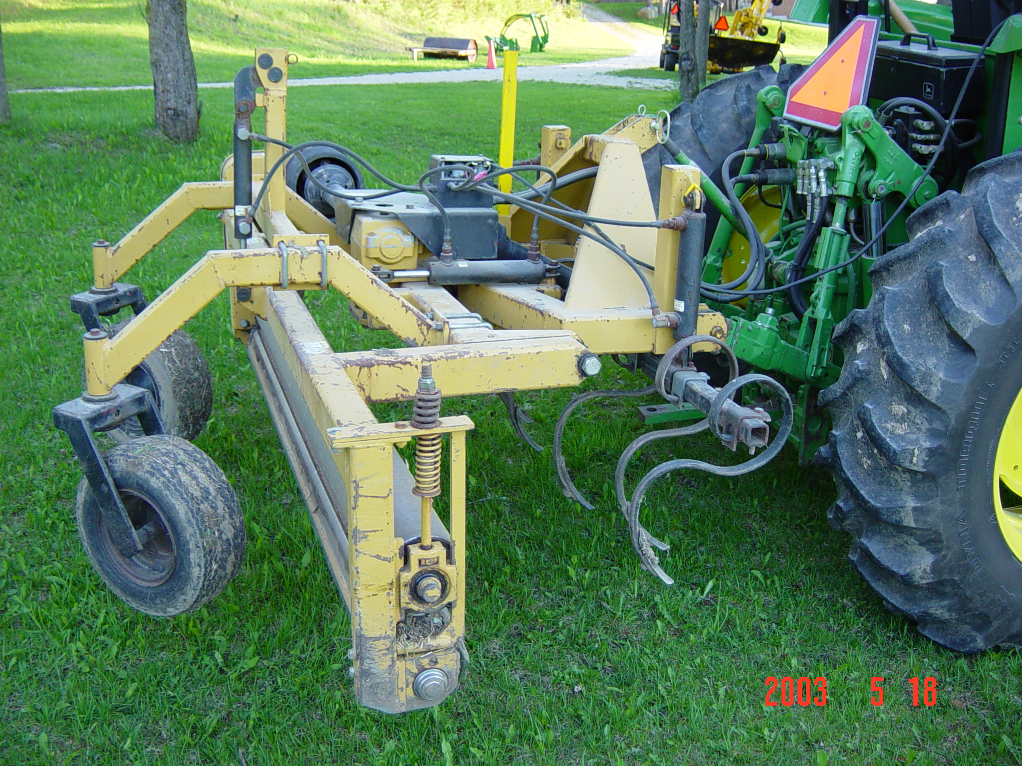

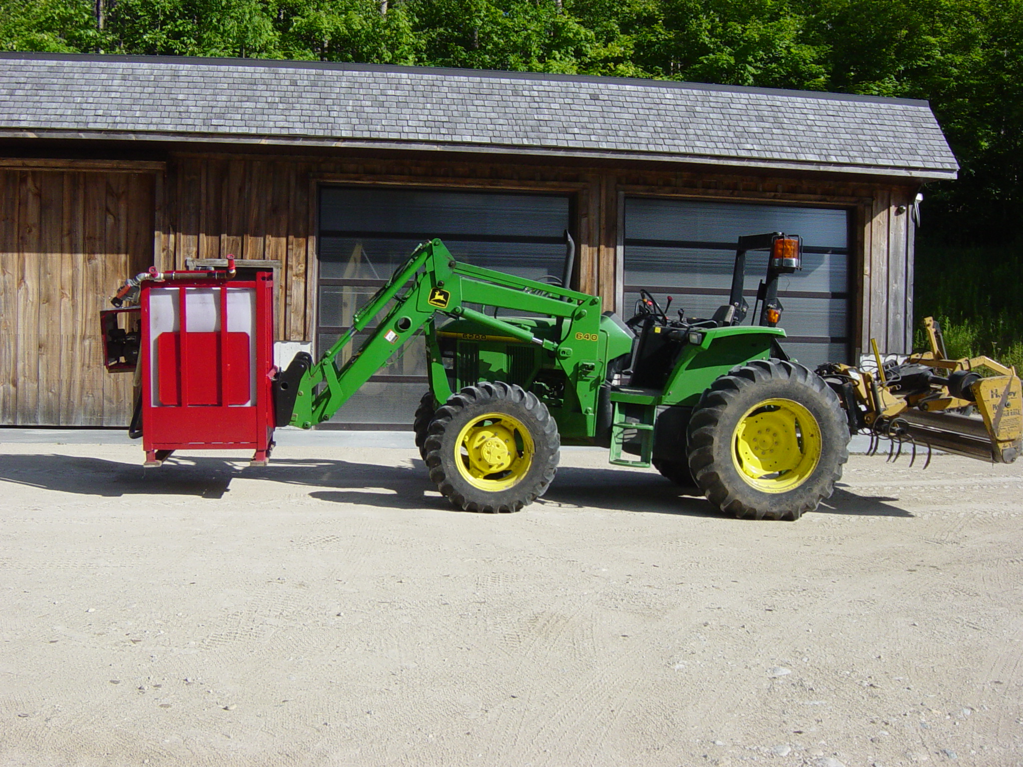

This is EXACTLY what you are looking for on the back of my Rig.
It is exactly the difference between a hand planer and a power planer. Make one pass for every ten you would make with an unpowered attachment.
Harley Rake, or Woods makes one too.
Found some better/closer pictures. Rakes come in smaller and SS sizes too.

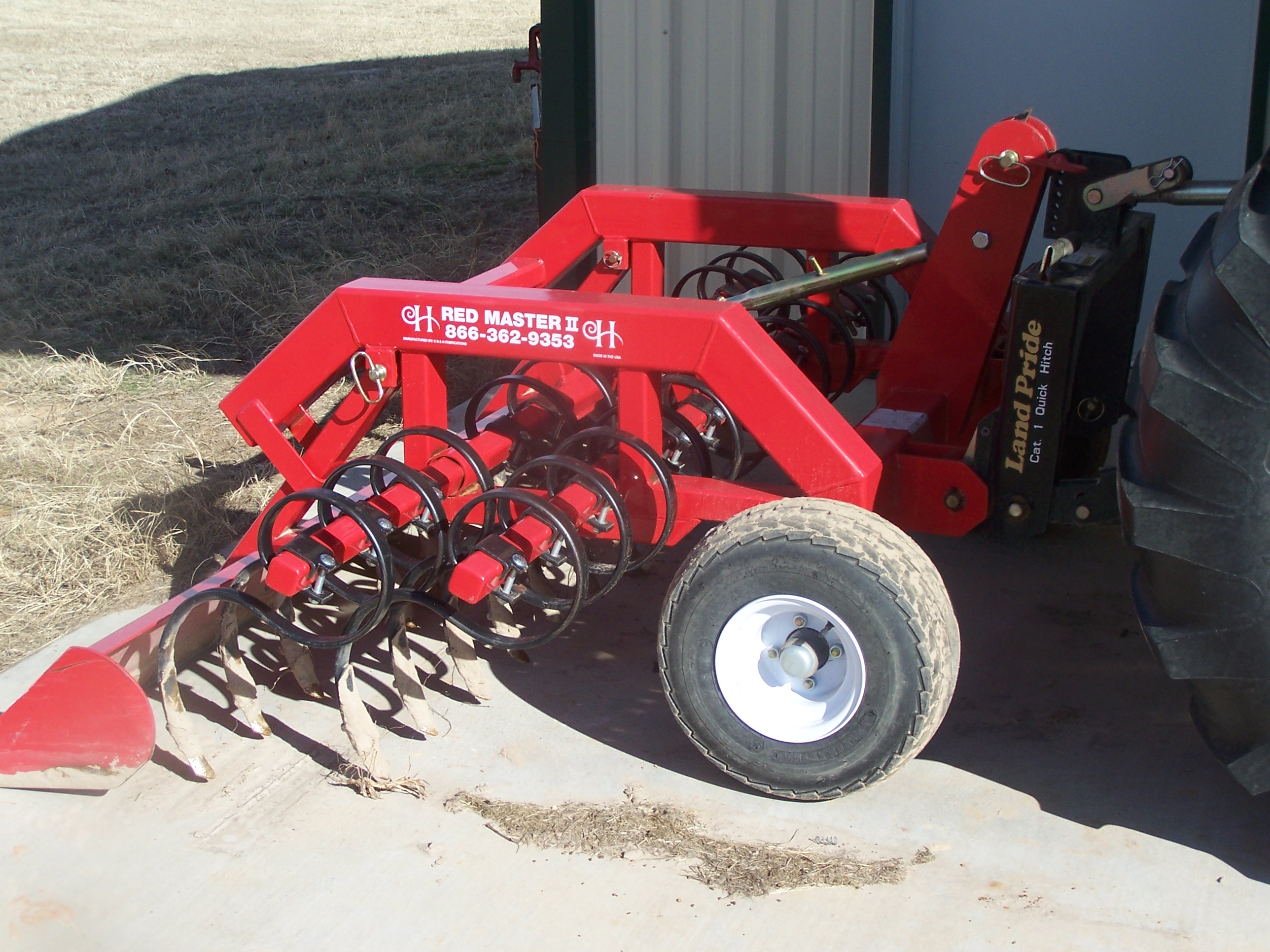

It's not a cheap solution but my Red Master II arena drag harrow smooths out the ground next to the rail. I have an 8' model so there is 1' outside of the wheels.
Red Master II & III - Arena Drag
