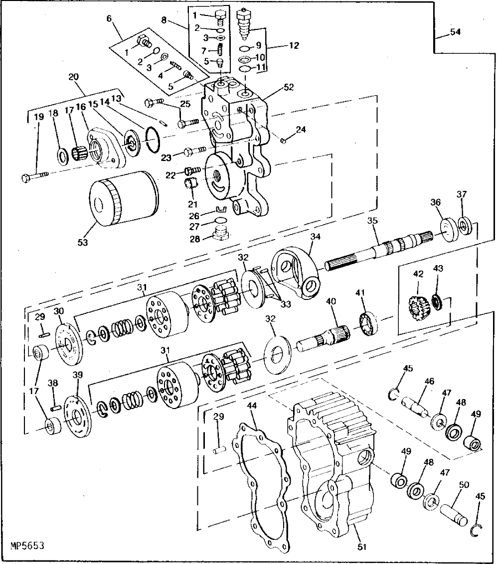

I recently have acquired a JD 318 with a hydrostat transmission. It does not run at the moment and I need to move it from its current location. I cannot find a release for the transmission. Can anyone tell me if there is one, or can you push/pull it without damaging the tranny? thanks.
   / Moving JD 318? #2
On my 314 there's a knob to turn that releases the 2 check valves(parts key #12)on the top of trans.
