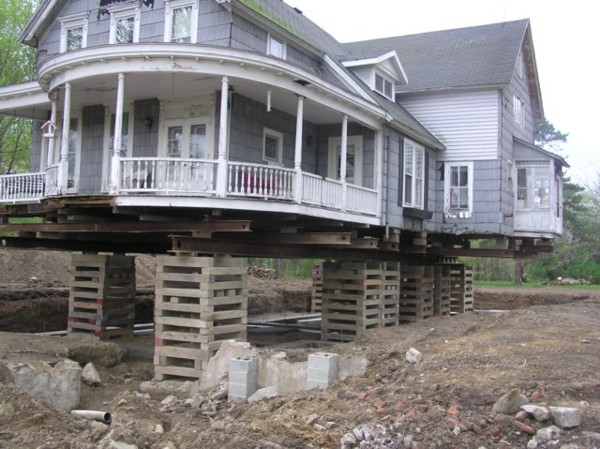

here is a pic. of a house about a mile up the road from me. they jacked it off the foundation, dug a big hole behind it, poured some concret footers to take the cribbing, then moved it back 60 ft . then they jacked it way up in the air so they can pour the walls and set in on new foundation.
