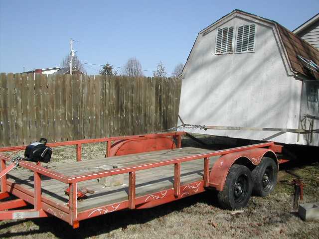

Unlike dclymers building, I am taking mine across the county. It is about 8 ft wide and 16 ft long. Here is my saga. I plan on getting it on top of the rails of my 16ft trailer. First I jacked up one end and removed the blocks supporting that end. I stepped in the doorway and tilted the building so I could remove the blocks on the end that would go on the trailer first.
   / Moving a storage building
#2
Once I got the building pointed up ever so slightly I backed my trailer under it slightly.

At this point I have the shed started on the trailer. A few weeks ago I bought one of these little dinky winches from a Homier tool sale for $29. It is rated at 6000lb rolling load, 2000lb stationary load, yeah right. I can't complain much for $29 dollars though. Anyway, it took 2 straps and 1 chain to get around the shed. I also placed a 4X4 under it to span the trailers width. I hooked up the winch and it pulled a little and stopped. My wife comes out and says, "too bad you don't have some grease to grease the rails with". Doh! why didn't I think of that? Got some grease and pulled a little more.

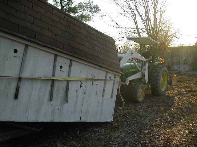

Now the going is getting slow. I jack up the tail end and winch a little and jack and winch. I get to the point where I have about a foot of cable left on the winch and a bunch of shed hanging off the trailer. My tractor is across the county where the shed will be. My trailer has a shed on it so I can't run get the tractor. I go over to get my neighbors 48hp Deere and loader to finish the job and he has it at his other place. I ran out of time Sunday to finish the job so it looks like I will finish up Saturday. A buddy of mine is going to get my tractor with his trailer. I am going to try to use the 3 point to raise the shed up enough to get another couple of 4X4's under it and then we will push it the rest of the way on the trailer.
