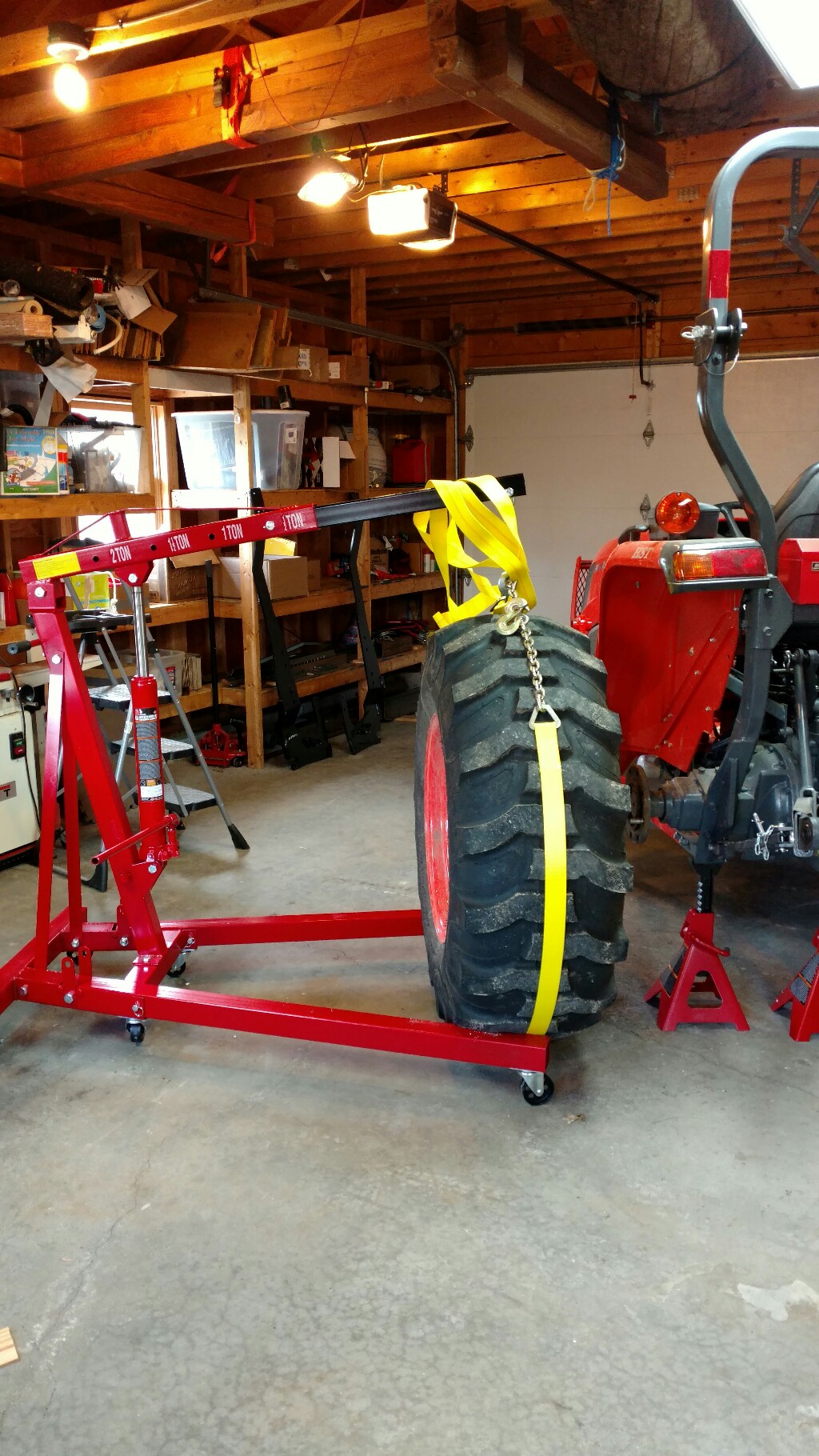

When I changed the loaded rear tire last on my M4700 we used a farm jack from Harbor Freight and a pallet jack on a concrete driveway. If I do it again I might use an engine hoist and the jack or a dolly on a concrete floor.
The first time I used 2 muscular 25 yr old plus sons and a friend on a rough lawn. It's easier on concrete.

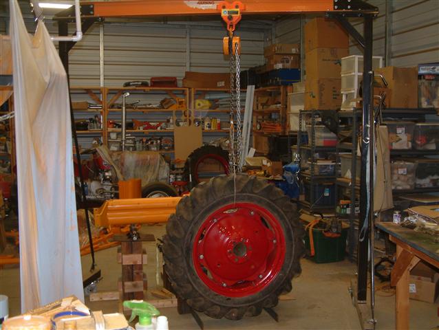

When I was restoring my 1951 Minneapolis Moline BF tractor, I used my Harbor Freight gantry crane to handle removal and reinstallation of the rear wheels (38" diameter). Saved a lot of time and also saved my lower back from a pulled muscle.
Good luck and be careful out there:thumbsup:
