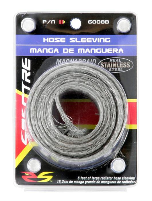

Let's call it a year ago.... wife freaked out as we had a puddle coming out from under the dishwasher. Pulled it out, looked at it, could not ascertain from where the water was coming.... decided to fire it up....and found it.
The discharge hose on the unit is pleated/corregated and a mouse had bitten a hole on the 'inside' of the pleat (or between two peaks)
Replaced hose and life was good....until this morning. Wife calls in panic, "come straight home, water is everywhere"
Long story short, a mouse had chewed on the hose again however this time, it's had a week or so to munch and it's not a mouse 'bite' that is leaking. It's more like a shark had taken a bite out of it. Drop everyti8ng, get it taken apart, and prepared to fix. I already know I'll have to order the hose as they don't stock what I need.
So now, I'm looking to fight back. Since it's a drain hose and not really pressurized, I felt little chance of finding a stainless WRAPPED hose....and indeed, found nothing.
Think of a 'sock' that covers a hydraulic hose. Meant to protact it from chaffing. Well....what are mouse teeth but little chaffers?!!!
I want to encase the hose (amazingly cheap plastic if you ask me).... anyway, I want to try to mouse proof it and am looking for ideas.

if you check out auto speed shops like Summit you can find stainless over braid hose covers.
Could this work for you?

If you look at your box store, you probably can find some rodent proofing material that is a woven copper mesh. It is actually a tube, (3"+/-) so you can put your dishwasher hose in it pretty easily. You could also use aluminized fiberglass wire loom, but that's pricier.
However job 1 is probably to foam all the openings (drain, water, electrical, anything 1/4" or larger) into the dishwasher cabinet to keep mice out in the first place...the copper mesh above is great for filling big gaps and then foaming in place.
