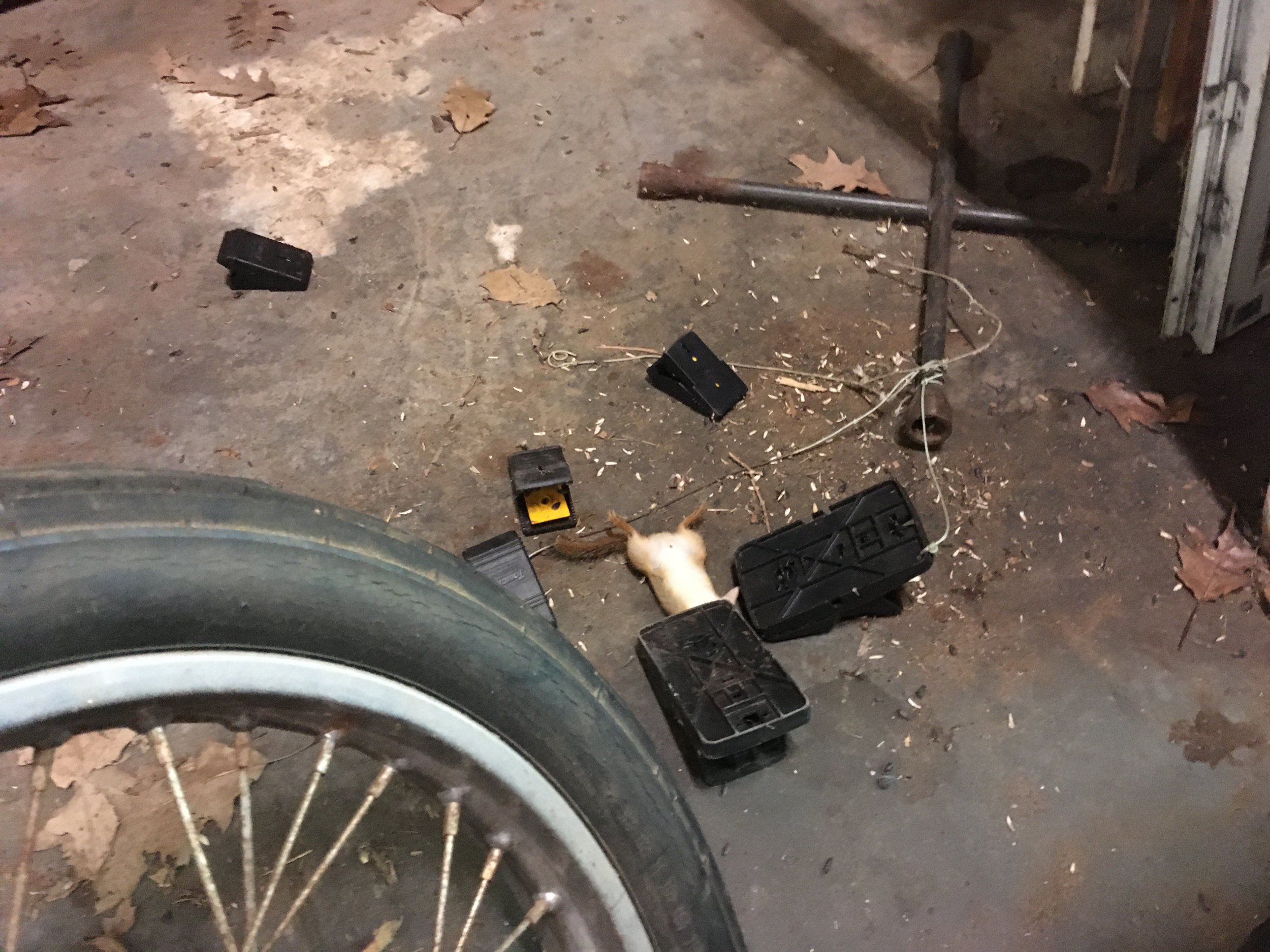

I prefer the 'Last Supper' method for dealing with rodents of all sizes. Works year-round in truck, trailer, barn, & garage.
I set both sizes SxS to keep little pests from robbing bigger traps. Sunflower seeds are best bait 24/7/365 unless you want to add mold or ants as attractants. (Use RV AF in bucket/roller traps up North)
btw, IMO trapping in corners like poisoning just isn't the best way/place to accumulate bodies. Set where inspection/access is easiest for you and recognize that a scent highway will accrue. I toss rodents out to feed the local critters that stay out of my chit vs use as bait for the sake of killin' or for having a recipe for skunk or 'possum. Never expecting a tip for setting a table for a variety of clientele.
