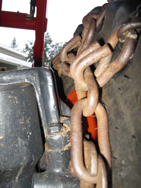

Leonz, it sounds like your front chain situation is similar to mine. I fixed it by shortening the crosschains to make the sidechain ride higher on the tire and thus clear the frontend components. I had to keep the crosslink chain hooks high to maintain clearance. Here is a photo of my DK35 front chain:
Are your chains 2 link or 4 link? 2 link sidechains will ride a bit higher on the tire than 4 link. Regardless, you should be able to estimate the number of links by laying the chains on the tire with the inside sidechain at the required position and removing the number of links to make the outside sidechain ride at the same position.

I laid the tire chain over one tire on thursday and by the looks of things I can lose
two cross links so weather permitting today I will get started on the task.
Thanks for the photo of your set up; I should have no issues with my installation.
