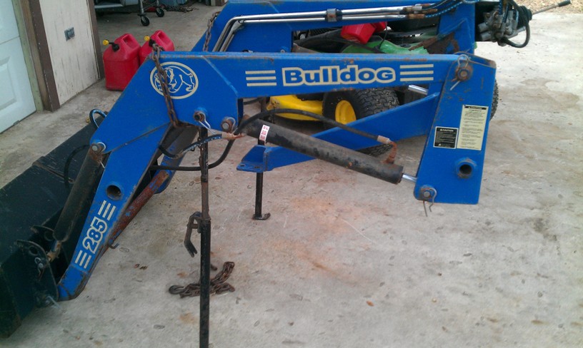

Can anyone tell me what distance from the ground the rear mounting pin on a Bulldog 285 should be?
I am trying to mount this loader to a New Holland 1920 and have to modify the mounting brackets.
   / Mounting Bulldog 285 Loader #2
It's a quick attach model, bit is missing the lower brackets. It looks like someone added a bracket to the main beam while addapting it to another tractor.
I have the lower brackets but it is for an Iseki. I have a fabricator that can modify them to fit the NH1920. The other bracket looks original and goes to an adapter that bolts to the tractor frame. I have read about them breaking because of the way they are bent and one of them happens to be broken right at the bend. Once I know the height I will have new front bars made out of rectangular tubing.
