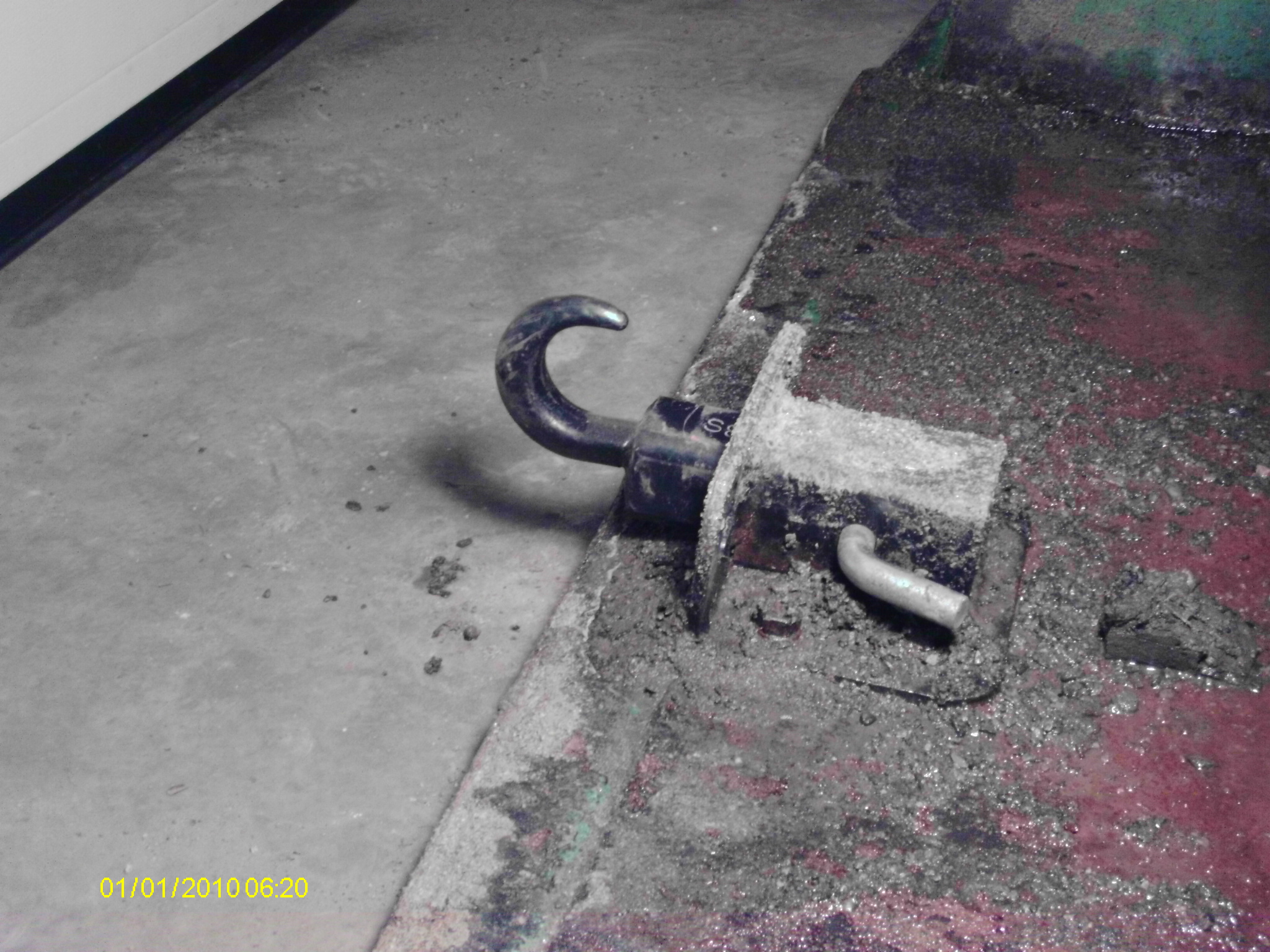

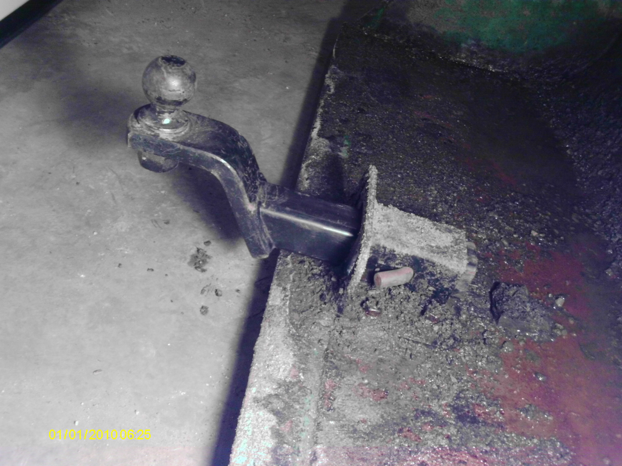

The small trailer now may turn into a large boat trailer. or your six place snowmobile trailer,or your six cords of firewood. Bad to get into a tipping condition. I have a 64 horse tractor that the previous owner torched a hole on the buckets floor for a 2and5/16 inch ball. Never would have done that but it has it's uses.

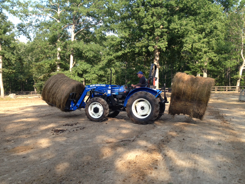

I built a tph mover for my new tractor out of 2" tube with a receiver on the bottom in the middle and a gooseneck ball at the top. It works great and is worth changing. I will post a pic from the app. I have a 40' horse trailer and it is too much for my tractor. It will pick it up no problem. But it sure jerks the tractor around.
   / Mounting a ball on my bucket? #8
The one in the middle takes the spear.
