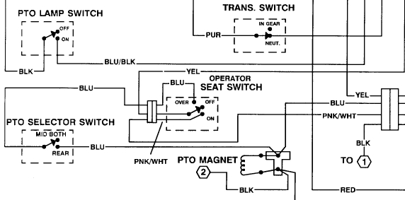

Oh and does anyone have pin outs for the seat switch.. It's causing me and the PTO grief and I want to bypass it.. It's got 3 connections.. I'm figuring common, open and closed.. But I haven't taken a meter to it yet... Way to much to do..
   / Mounting a 60" Mower on an 855 #2
When you sit on the seat one contact closes and allows on-seat PTO use. When the seat is lifted the switch can be pulled up to close the other contact for rear PTO off-seat use. That is why there are three contacts. Schematic is attached. I will look up some pictures to post regarding your mower deck attachments.
