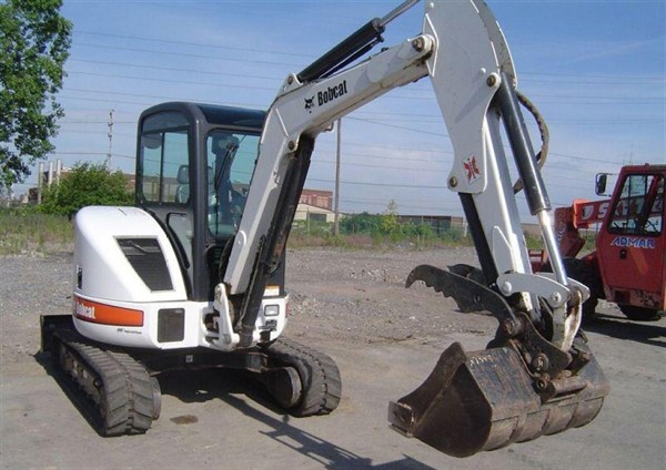

Living in the mountains myself I believe that you need something on the order of a Bobcat Mini Excavator with a grapple. A tractor would not be my first, second, or third choice for the type of work you are looking to do.
I have a neighbor with one of these machines creating a trail for me on my property which was hit hard by the Southern Pine Beetle 10 years ago. The area was almost too difficult to climb through to set the grade. Had to crawl over and under downed trees, leaners, hangers, etc.
The Bobcat has been able to make its own way through the woods; knocking down trees, digging up roots tearing down vines and low branches, dragging leaners off of the hardwoods, cutting the trail in the mountain side, grading the road as it goes. The grapple is worth "the price of admission" alone. Picks up and places trees and limbs out of the way, then later we pick them up relocate to the slash pile.
Working on the side of a raw mountainside with a tractor is a harrowing experience at best. In the best of situations you are already on a significant grade and then your wheel falls into an old tree stump hole or bounces on a hidden root or limb. That gets exciting quickly. Make sure your life insurance is paid up.:laughing:
BTW a grapple on a tractor is handy but cannot compete with a grapple on an excavator with its 360 degree rotation, 15 foot elevation, root cutting power. They are amazing to watch with a good operator. When you finish the clearing with the excavator then sell it and buy a tractor for maintenance.
