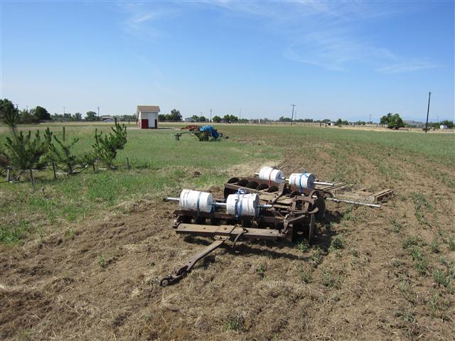

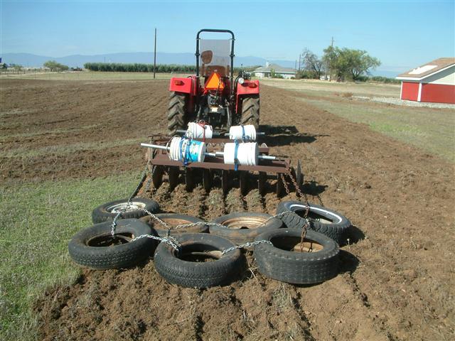

With that thin topsoil, I'd use an offset disc as the primary tillage implement. You don't want to flip the soil with a moldboard plow and bury the good stuff and bring the bad stuff to the surface.
Here's the disc I use on my gravely loam soil that is pretty thin ~6-10 inches of good soil over clay. It's an old 6.5 ft wide Towner offset disc with 20-inch dia pans. The white things are concrete weights (120 lb each) to get the disc to bite better.

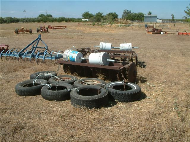

I use a tire drag behind the disc to bust up the clods and level the field as I go.
You need to pull discs like this at 5-6 mph. My "puller" is a 2008 Mahindra 5525 (54 hp engine, 45 hp pto, 2WD, power steering, gear tranny 8F/2R)
Good luck
