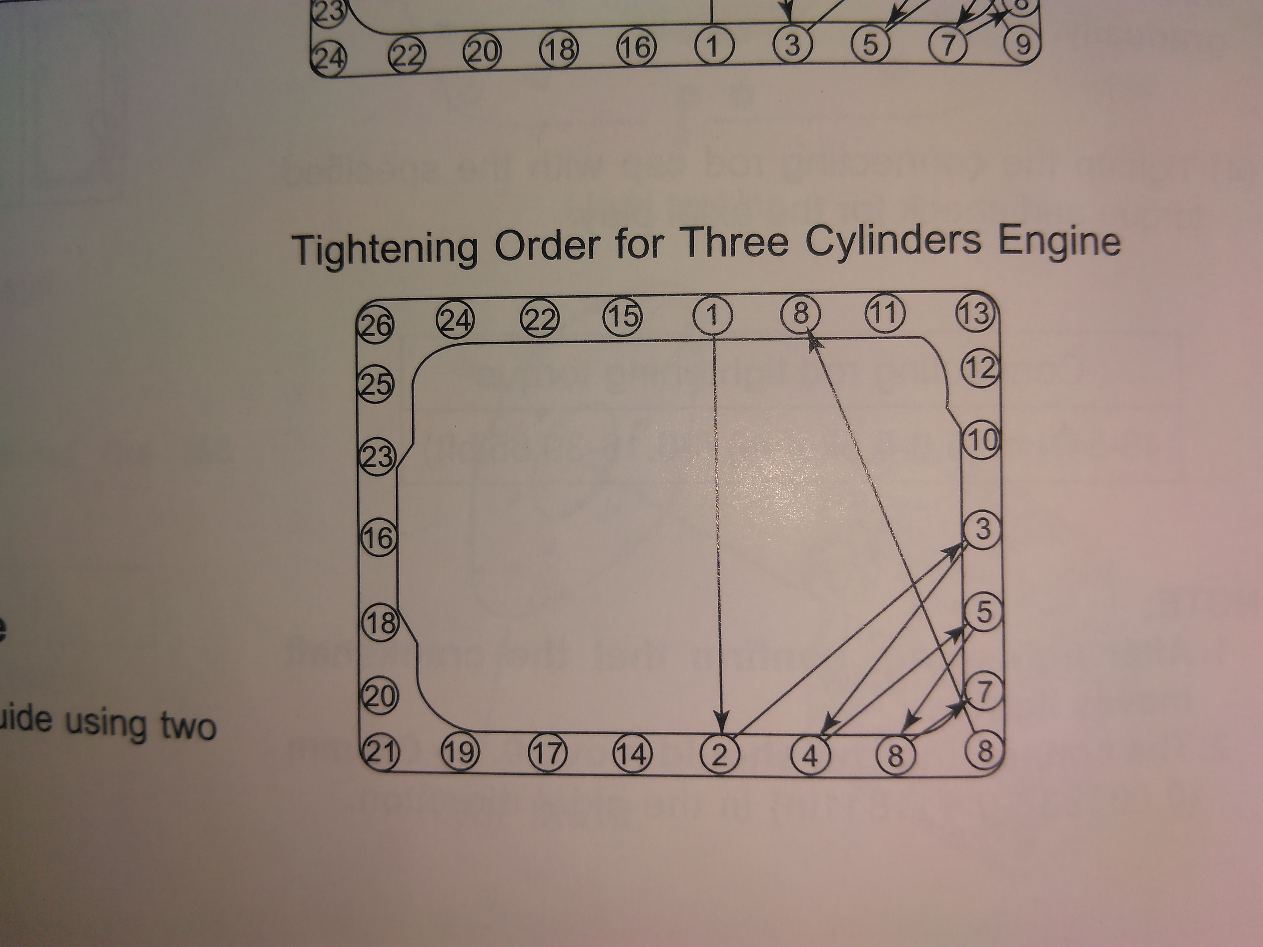

Are you sure your oil leakage is coming from the pan and have you put something under the tractor to locate the leak. Myself I use a washing machine tray and paper or better yet cardboard. The other thing is do you still have the washer installed on the drain plug?
It always possible that the oil ias coming from another area and just setting around the pan, just a thought.
From service manual there is a pattern for tightening the oil pan and bolt torque is 7.38-9.59 lbft
