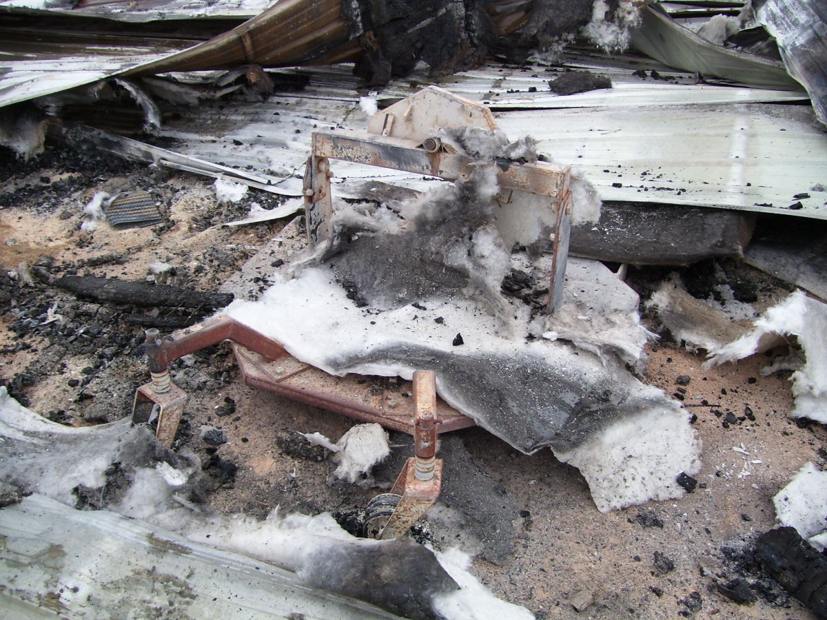

We lost a 48" brush cutter for a 425 in a fire. I think we can save it with some new wheels and a new motor. Can anyone tell me what the specs are for that motor? I realize that Power-trac needs to make a living too, but I can't justify spending double the cost of an off the shelf motor just to buy it from them. Any Help would be appreciated...

Sorry about your loss.
Several years ago, someone replaced one, and I believe it was a 3 cu in Danfoss motor.
Found the post.
06-16-2004, 10:01 PM #10 (permalink)
kludge
Join Date: Jul 2003
Location: Earlysville VA 22936
Posts: 15 Re: Brush cutter hydraulic motor
If we have the same Danfoss motor the one on my 48" brush cutter is a Danfoss 151-2121 Series DH-50. I have not looked up the specs but this comes off the label on the top of the motor. I bought mine 1 year ago. I had to replace the original motor under warranty. The new motor was not painted black so the label is still legible. When my unit arrived the first motor ran for about 5 mins. Terry sent me a replacement and I returned the original.
