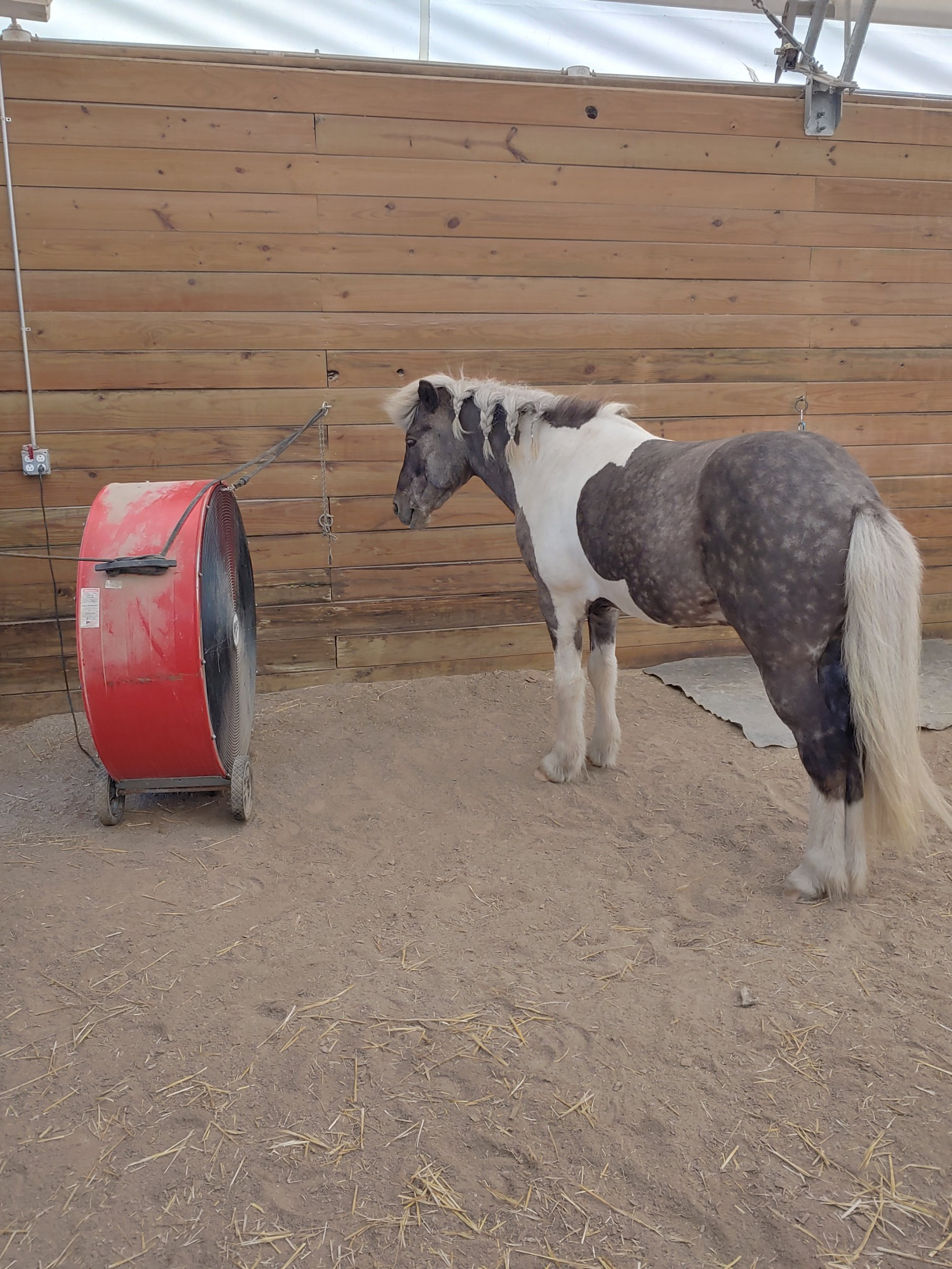

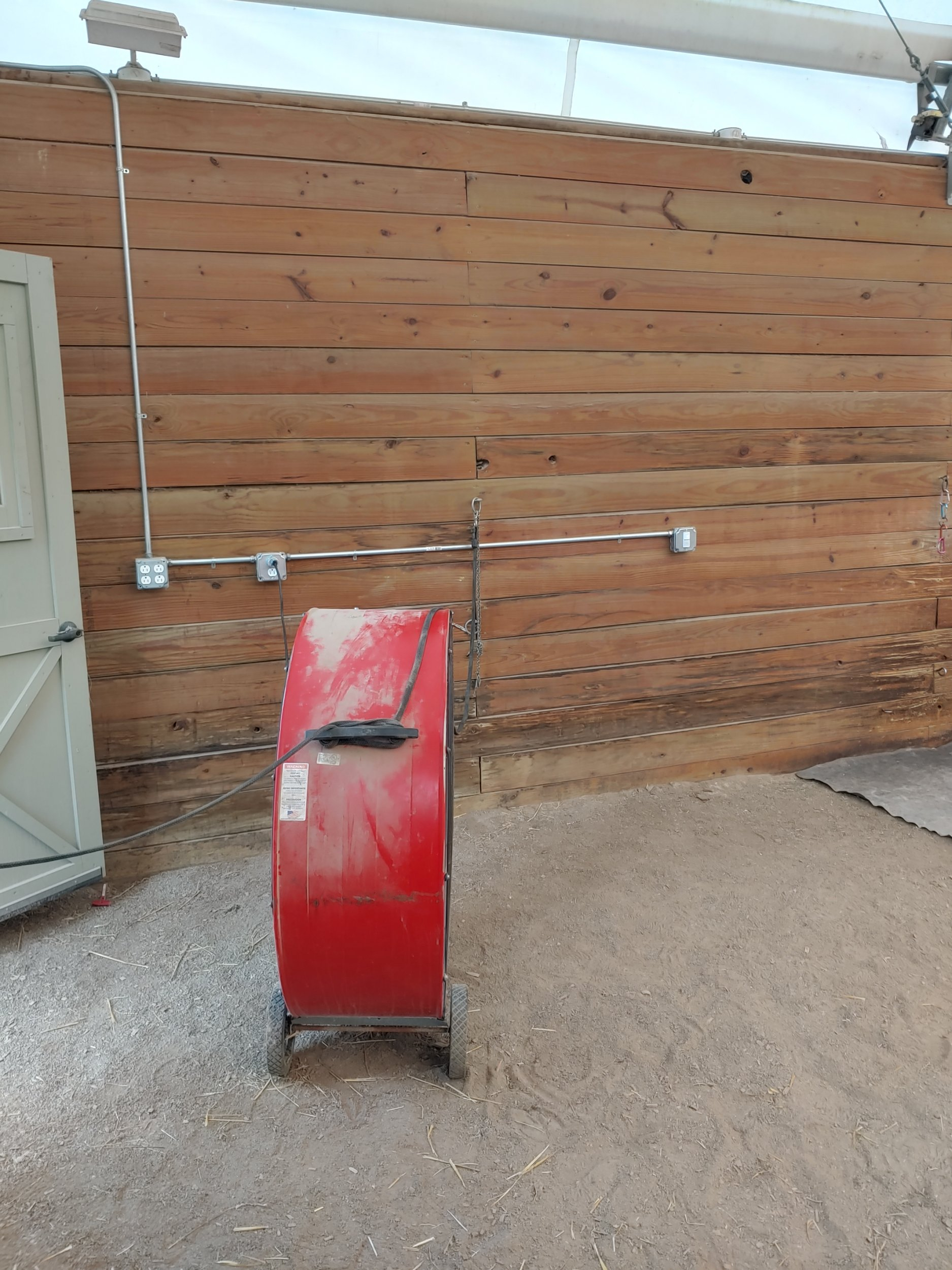

Our horses only stand in front of their barn fans part of the day, the rest of the time the fans just use power doing nothing. Is there any kind of motion detector I can use that would stay on as long as it detects motion, like the swishing of the horses tail or moving their head? They don't give a clear answer on whether they will stay on during continuous motion or whether they will shut off and then switch back on when they detect motion again. Also, many of the switches I've looked at don't handle enough power, the fans draw about 800W. Most of the switches seem to top out about 500W.
Or is there a better way to do this? tnx

What your looking for is an occupancy sensor. We use them in office buildings. They will stay on as long as either infrared heat signature or motion is sensed.
youd have to check with manufacturer as to amp load for them. we usually only power a few light fixtures. I have no idea if these will handle barn moisture and dust conditions.
heres one with 1000 watts

Thanks, didn't know what they were called. That looks like it is exactly what I want. Barn is dry but pretty dusty, worth a try though. We have to brush the lights off with a dust mop, we can do the sensor at the same time.
