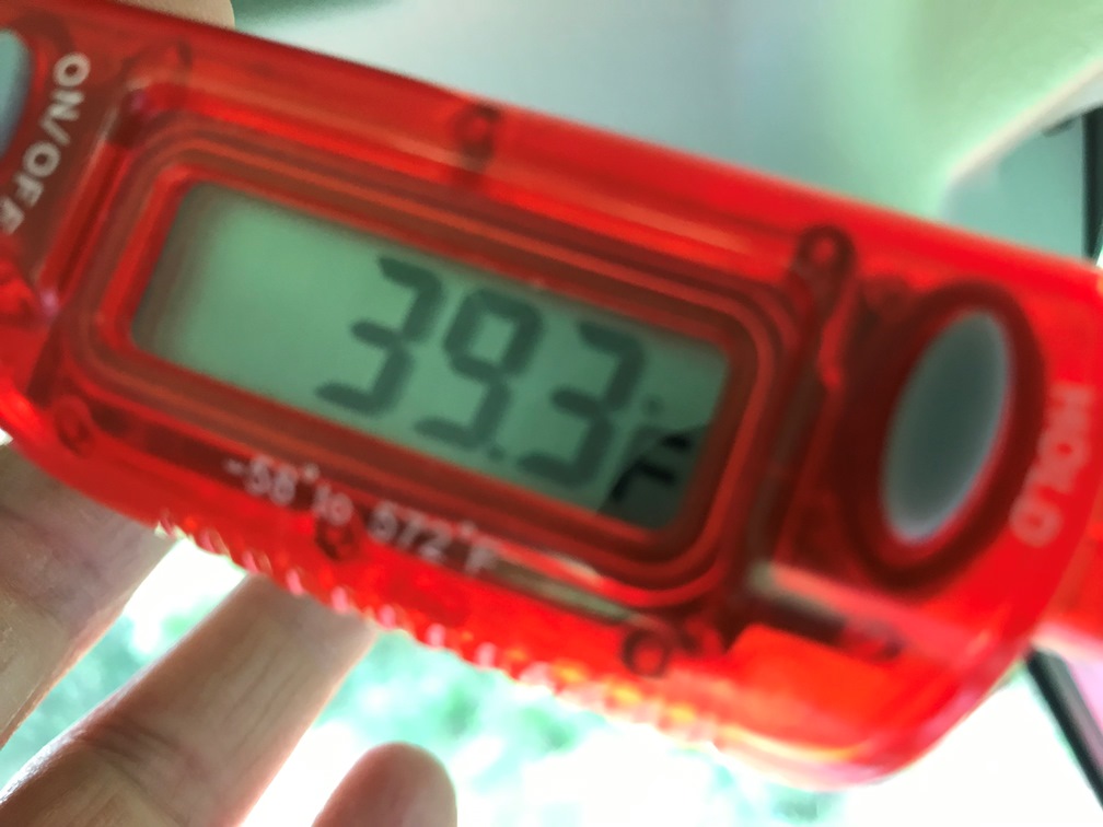

Bought a used L4240HSTC at the end of December 2018. This will be my second Summer and the A/C works well. With so much glass, it's like driving a solar panel and the way the various air outlets are adjusted makes a difference in how well it works. Here's a picture of a thermometer stuck into one of the outlets. Throttling back fresh/recirc so it isn't trying to run on 100 percent outdoor air when it's 90 degrees in the shade helps.
