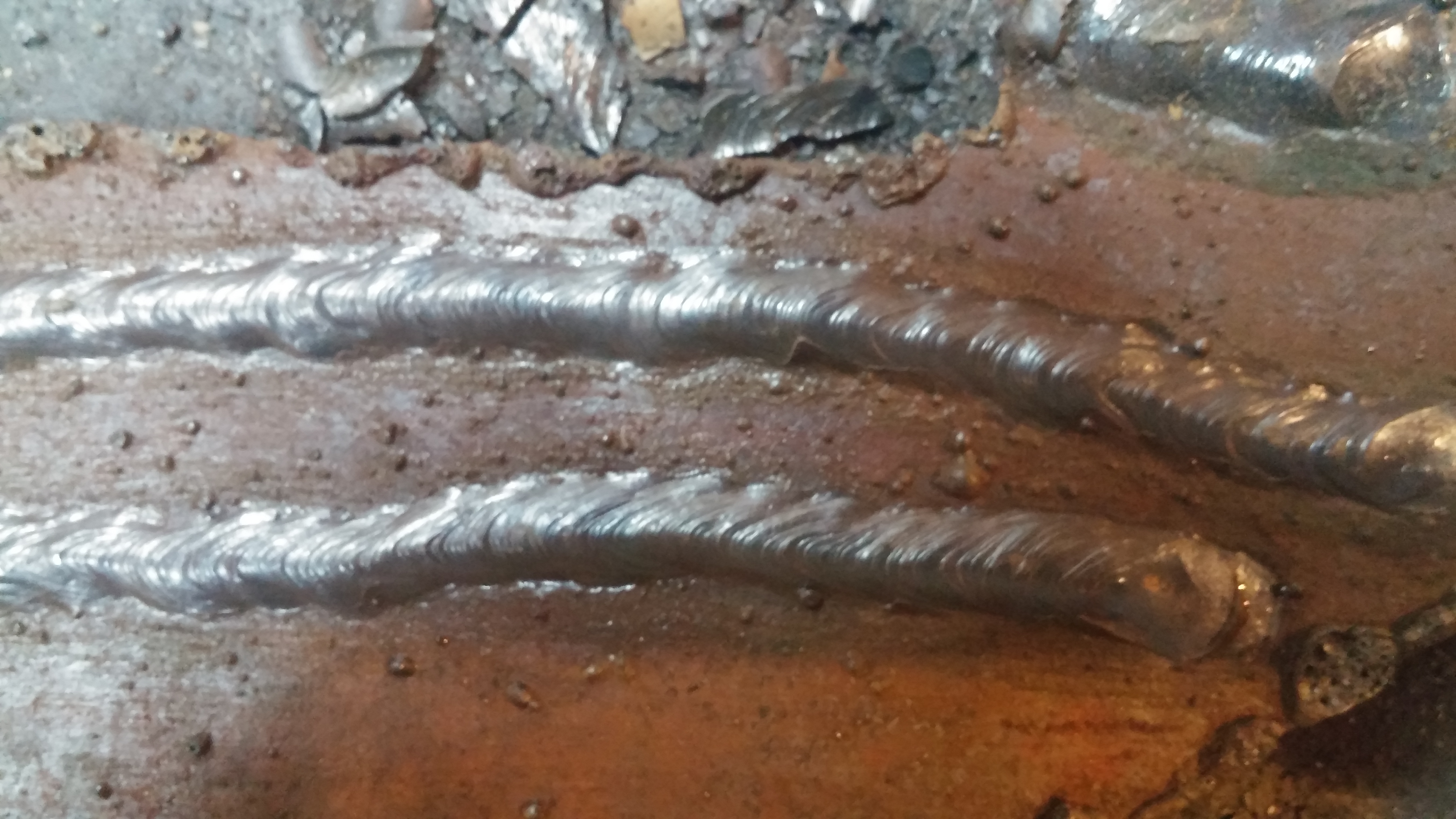

I just bought a used Miller Dialarc. It's been several years since I used a stick so I laid down a couple of beads to collect your thoughts. Thoughts?

Based on the straight down view, that looks like pretty good welding. The toe is fused in well, the casting is smoothly laid, no porosity seen, no crater cracking at the weld end. I think you bought a properly functioning machine that is being handled by a competent welder.
