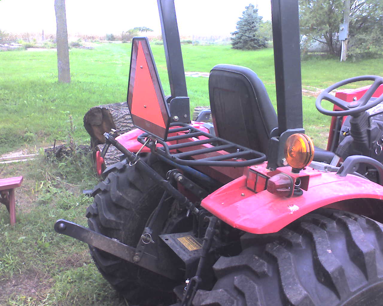

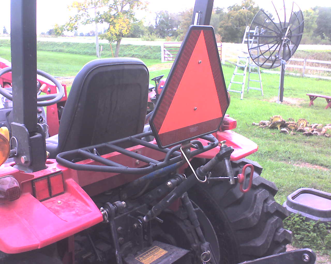

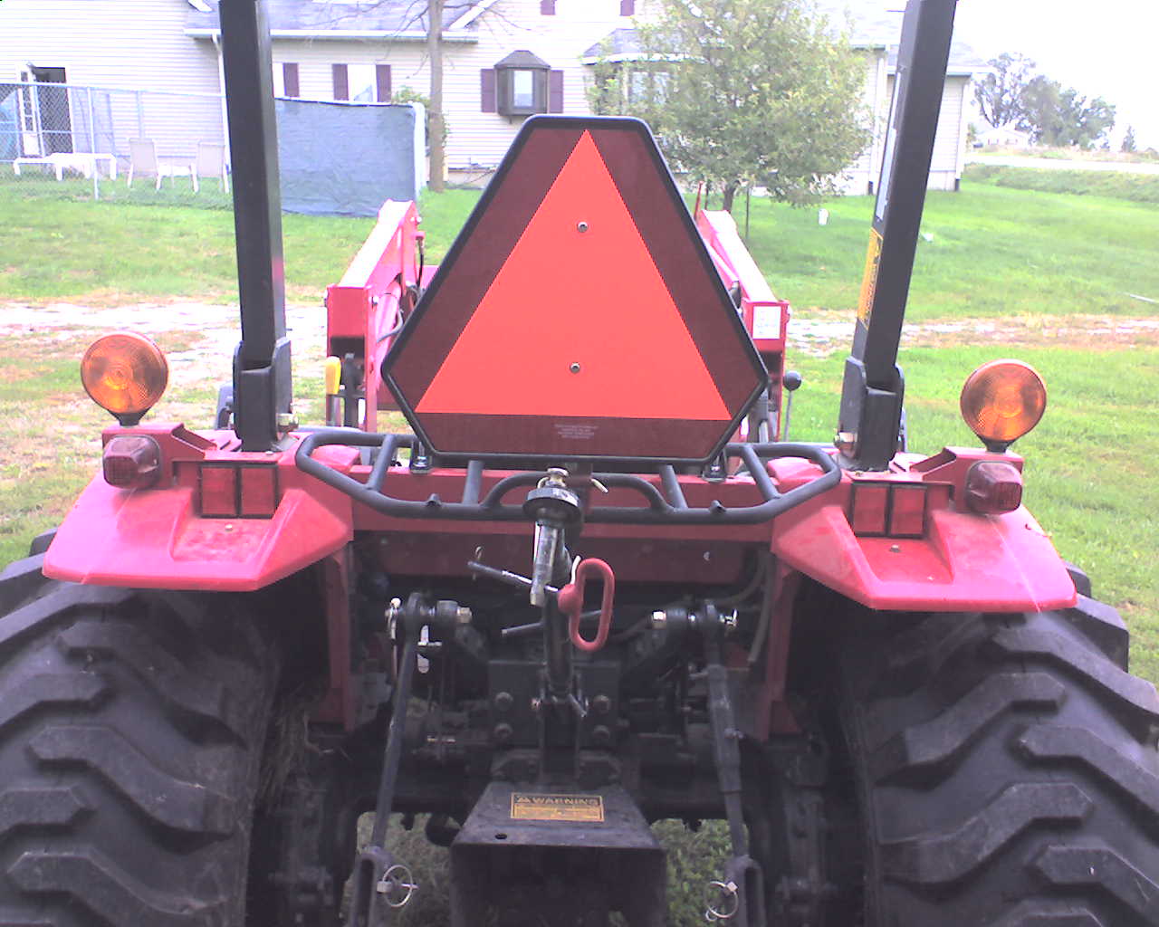

I finally got tired of not having a space for storage/toolbox on my tractor so I
finally decided to add something to the tractor....total cost about 25 dollars when using used parts. Here are some pictures of my new storage rack.:)

   / More storage for my 2815 HST
Harvey7 said:
Looks like a rack from an ATV, is it ?
Looks good.
Yes, it's from a 1987 Kawasaki Bayou Front ATV rack that I purchased on Ebay for 9.00 dollars, new cost about 75. I went to 4 different dealers with tape measure and checked out different models trying to find the right size and shape. What's nice is it already has mounts for the bolts, just drill holes, the only other thing I did was cut off the handle so it would clear seat.The rear brace is an old section of pipe from a hog feeder that I reshaped and then drilled and taped the frame to attach it. Total cost was less than 25 dollars. Now I can mount a tool box or a wire basket made for an ATV so I can carry my tools and chain.
Maybe someone from Mahindra will add this setup to their tractors as an option!
