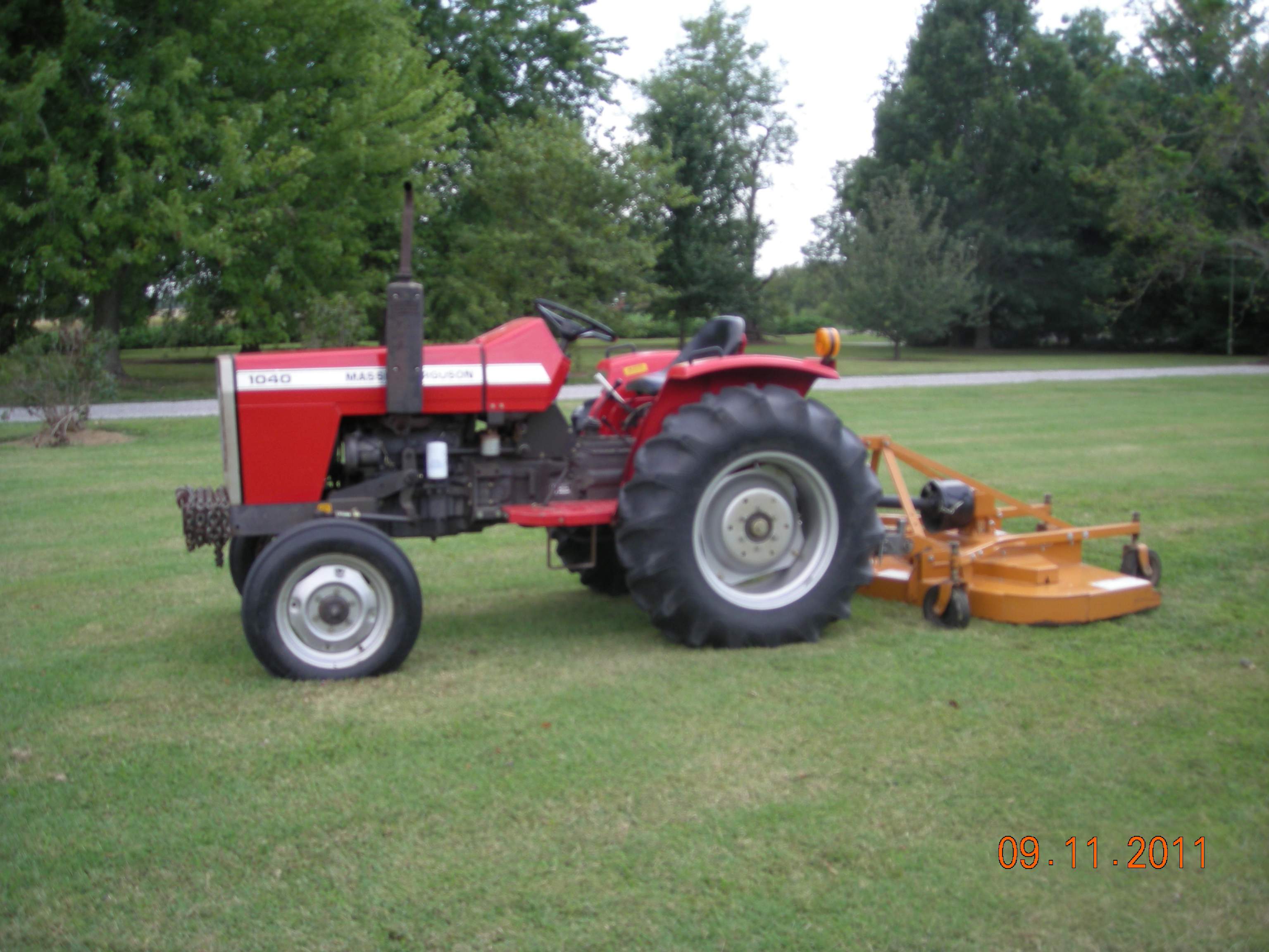

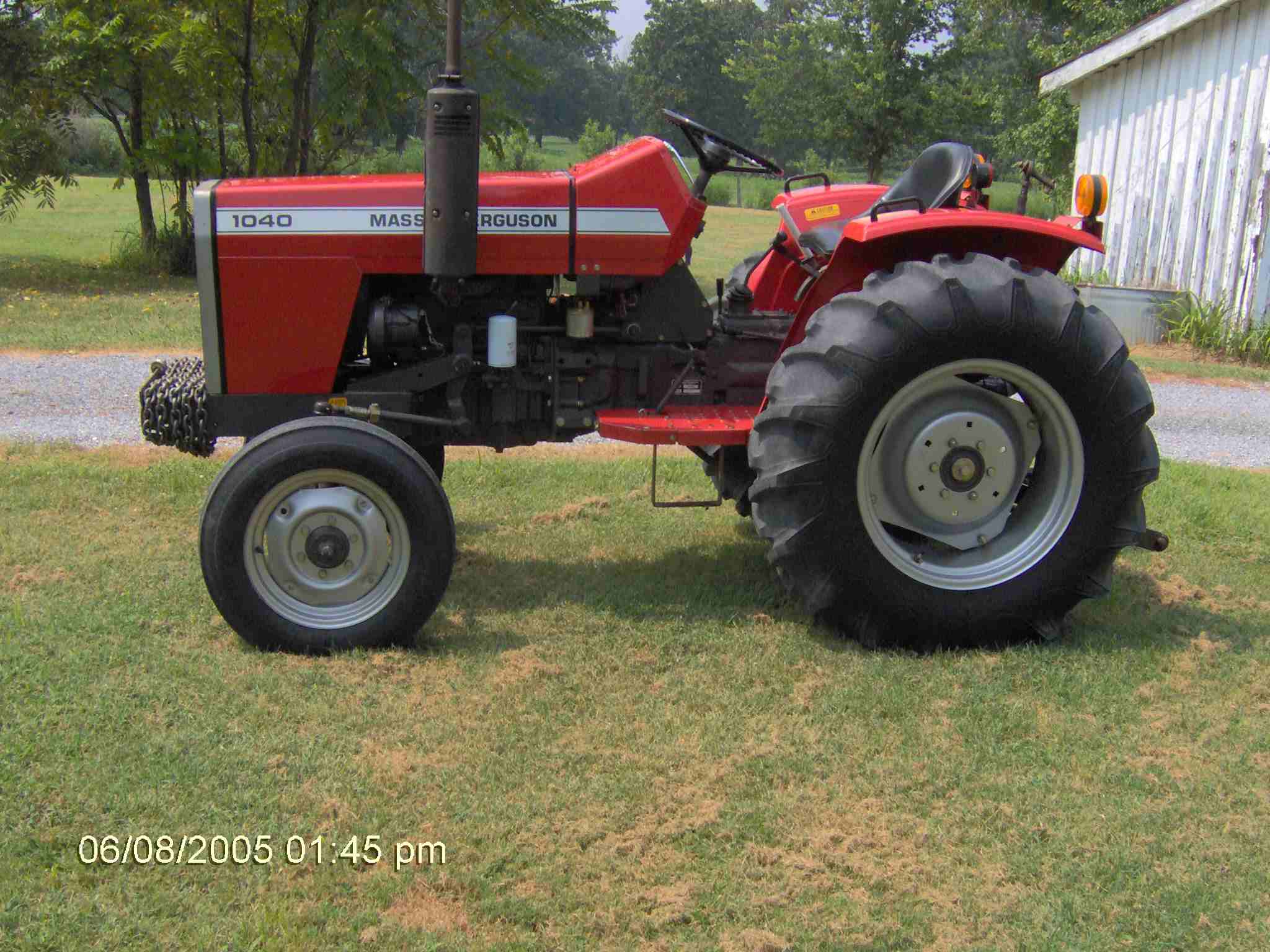

it should have wet brakes. My 1986 1040 has wet brakes( that was one of the many reasons I chose it to buy over JD, Kubota,Case, and others at the time. The MF1040 was just beefier built. I have the shop manual for mine( it covers the 1010,1020,1030, and 1040 models)

on the amount of hydraulic fluid.......when i changed mine.....was the largest mess i have ever made in my garage. I had 2 five gallon buckets ready....NOT ENOUGH!!!!!!!!!!! that day cost me a lot on the stupid tax. It will be a LONG time before i forget that day! IF i remember right, I went with tractor supply for the hydrolic oil as it met the requirments that massey specified back in 1986 and
I believe i changed the oil 12 to 15 years ago. that tractor has had no problems except for needing 2 batterys over the years
