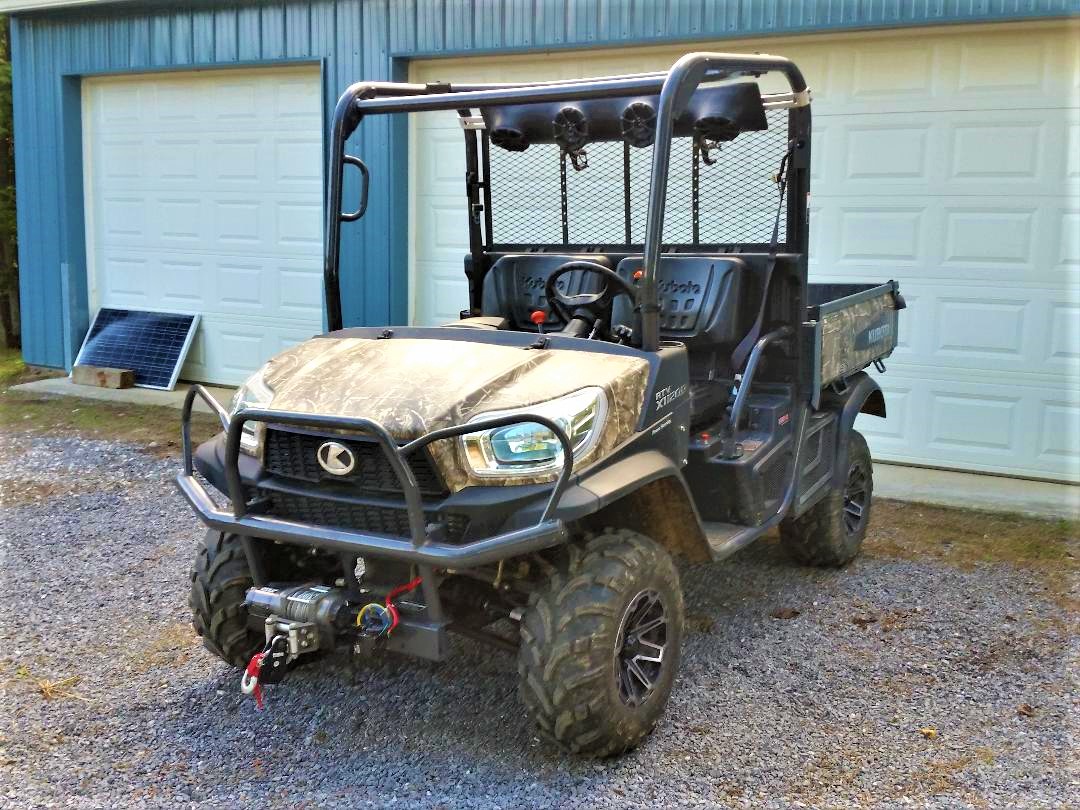

Fellas, I bought a Kubota RTV D-1100 Last summer and am disappointed with the lack of power that it has. It seems to run fine, no hesitation, pulls up hills OK but...on my two long hills it only goes at 11MPH. Even on the road it goes about 24 MPH and it takes a quarter mile to get to that.
I see lots of Diesel pickups that somehow modify their computers, exhausts or intakes and almost double their power. Is there anyway to gets some more output for the RTV?
Thanks

The problem is not your engine output. The problem is the inherent characteristics of the HST transmission.
((11-mph does seem abnormally low on hills. Check level of hydraulic fluid in HST transmission.))
Diesel utility vehicles are workers, not sports vehicles. If you want speed, sell the diesel and buy a gas utility vehicle.

11 mph is pretty normal on a decent hill. I have five RTV-X’s. Two 900s and three 1120’s. The 1120’s have a little more power but not much. They definitely use a lot more fuel, relatively speaking. We run them 12 hours a day. The 900’s can go two days. The 1120s do maybe 1.25 days. Still much better than gas units which often we needed to refuel mid day.
We have not found anything to boost their power. They are tanks not sports cars.

Read some reviews on the turbos for the RTV. They are not that impressive and mainly help with high altitude situations. My dealer has installed a couple and he said he didn’t think they were worth it.

It boils down to they are what they are. The limitation is the HST transmission. The turbo kits will help for high altitude operation but not much at normal altitudes. I have a 1120 and I love it for my needs but for those with a need for speed I’m sure would be disappointed. I found that I increased my pulling power by installing the factory hand throttle kit. By opening the throttle that way the foot control is just the transmission. It acts just like a hydro tractor.
   / More power from Kubota UTV DIESEL #10
Yes I second the hand throttle kit, mine would go about 9 or 10 uphill, with the hand throttle I get like 15 on the same hills. It's supposed to be for the broom attachment, but it works great for my needs. I paid like $90 at the dealer and installed it myself, pretty easy to do.
