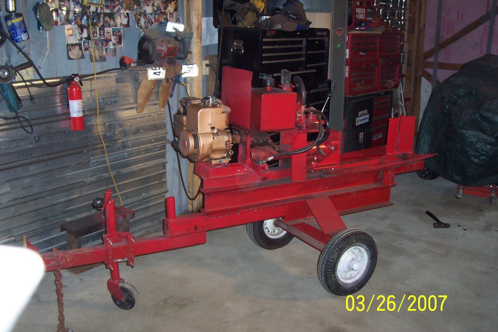

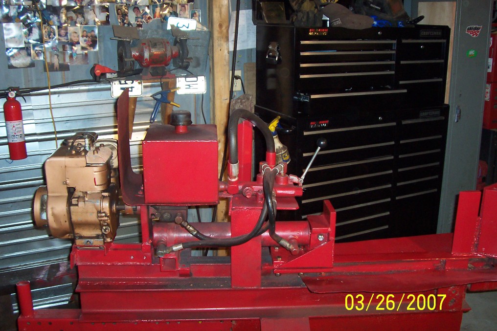

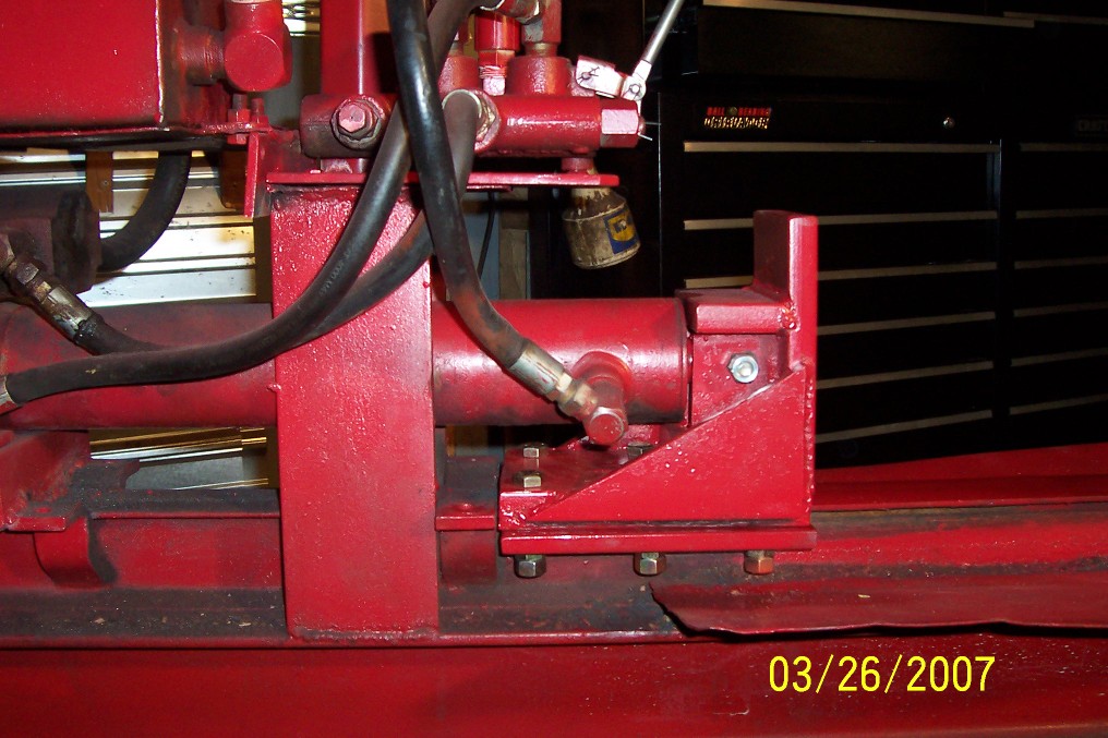

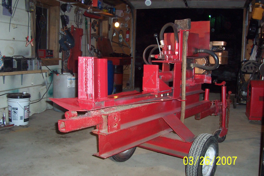

Thought id show off my splitter ive been working on for 15 years.:D It seems i modify it each year to make it easier,faster.I started with some scrap i beams and a boat trailer axle,that i shortened.The small i beam the pusher runs,the piston,and the 5 hp briggs, on was a tiny splitter that i bought for 75 bucks in a garage sale 15 years ago.It sat about 4 inches off the ground.:D Well i put all this togeather to make a respectable unit.a YEAR OR SO LATER,I ADDED A NORTHERN two stage pump.detent handle,and bigger hydro tank.It became a very strong and fast splitter.The wedge use to be on the trailer hitch end,but the wood fell between the atv and the splitter ,and required moving it.I cut things up a couple years ago,and reversed it.At the same time i added another beam so now i stand perfectly straight when operating.I dont touch the split wood now,it pushes itself up into a neat pile,and when it gets 5 ft high or so ,i simply move the atv ahead a couple feet and continue.This year,i made a new taller and ruggeder pusher,so i can split two halved peices again at once.Ibelieve i finally have perfected my design the way i want.Most of the materials for the frame are scraps from work etc.SO i dont have alot in it.It will split most any thing.I can split through about a cord an hour in good wood,its very fast,I would recomend NHS two stage pumps.I have towed it behind my jeep and hauls nice[just remember to put sandwich bag unde hydro tank vent cap:D :D ]Its a nice splitter to get around in the woods with my atv.In pic 5 you will notice an axe on board.The wedge only comes within 1 inch of the wedge.99.9% of the time the angles ,beyond the wedge force the peice open ,but every now and then ill get one little bit hanging. I also have killed alot of snakes under the wood with it:D :D onThought id show it to you and the design,and reasoning for it.There is another pic in another thread here,i never used a cutting torch,its all grinders,sawzalls and welder.ENJOY

Thanks for sharing the pics. I always enjoy looking at others ideas. Looks like a very useable splitter!!! I recently built a 3pt PTO splitter. Nothing beats a good splitter!!!

Afternoon Alan,
Well that looks pretty darn good to me but Im still using my 8 lb maul ! :confused: BTW arent you still supposed to be out on that snowmobile ???
Nice job, I see you use the old beaded x trick on your ram plate :)

Nice..very nice Alan.
Like the height,and must be easier on the back.
