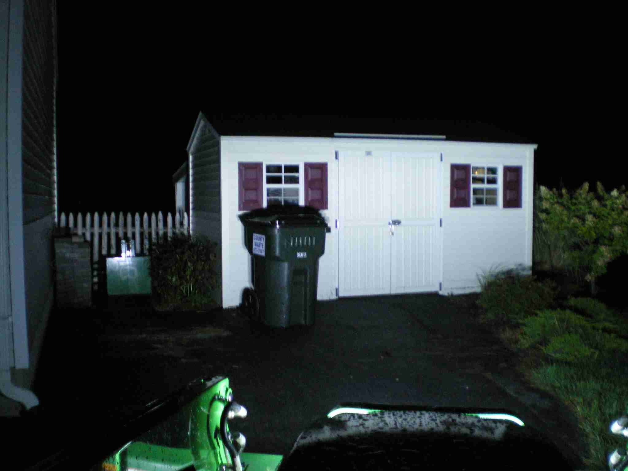

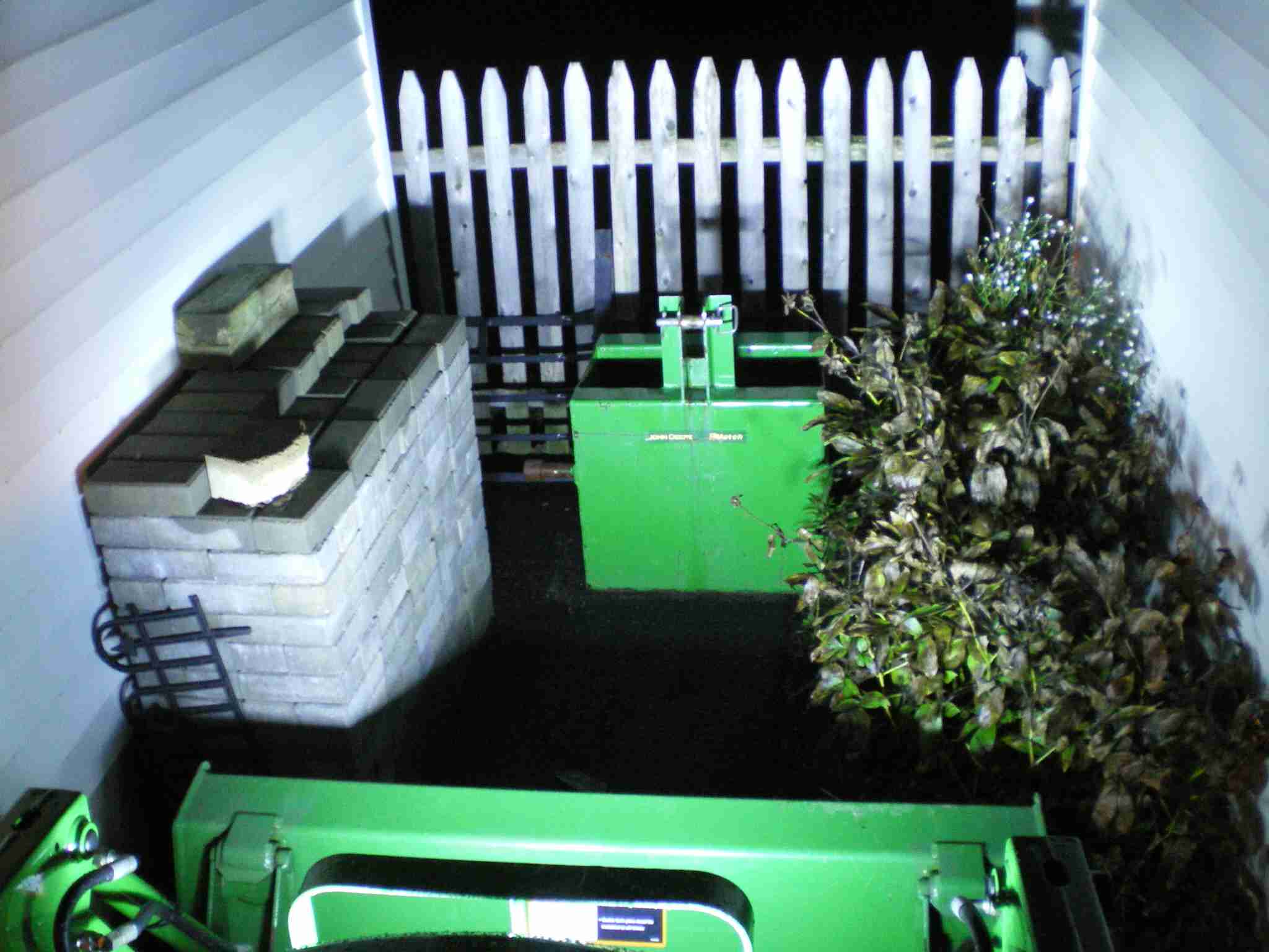

as our days get shorter it is time to add more light
My 2210 has low beam H4 bulbs and glass
i replaced them with 10K HID kit bulbs
the goal was usable light, not pimp
link for product only do not know the vendor
Xtreme Hids
draw is 35w vs 55w per light
color is very white
my kit came from my jeep(hella H4 glass) so i swaped the high and low beam cables on the hid assembly that plugs in to the existing headlight plug so low beam is now high beam
no cutting of the wiring harness
i put the xformers between the battery and the grill
my cost $99 plus shipping

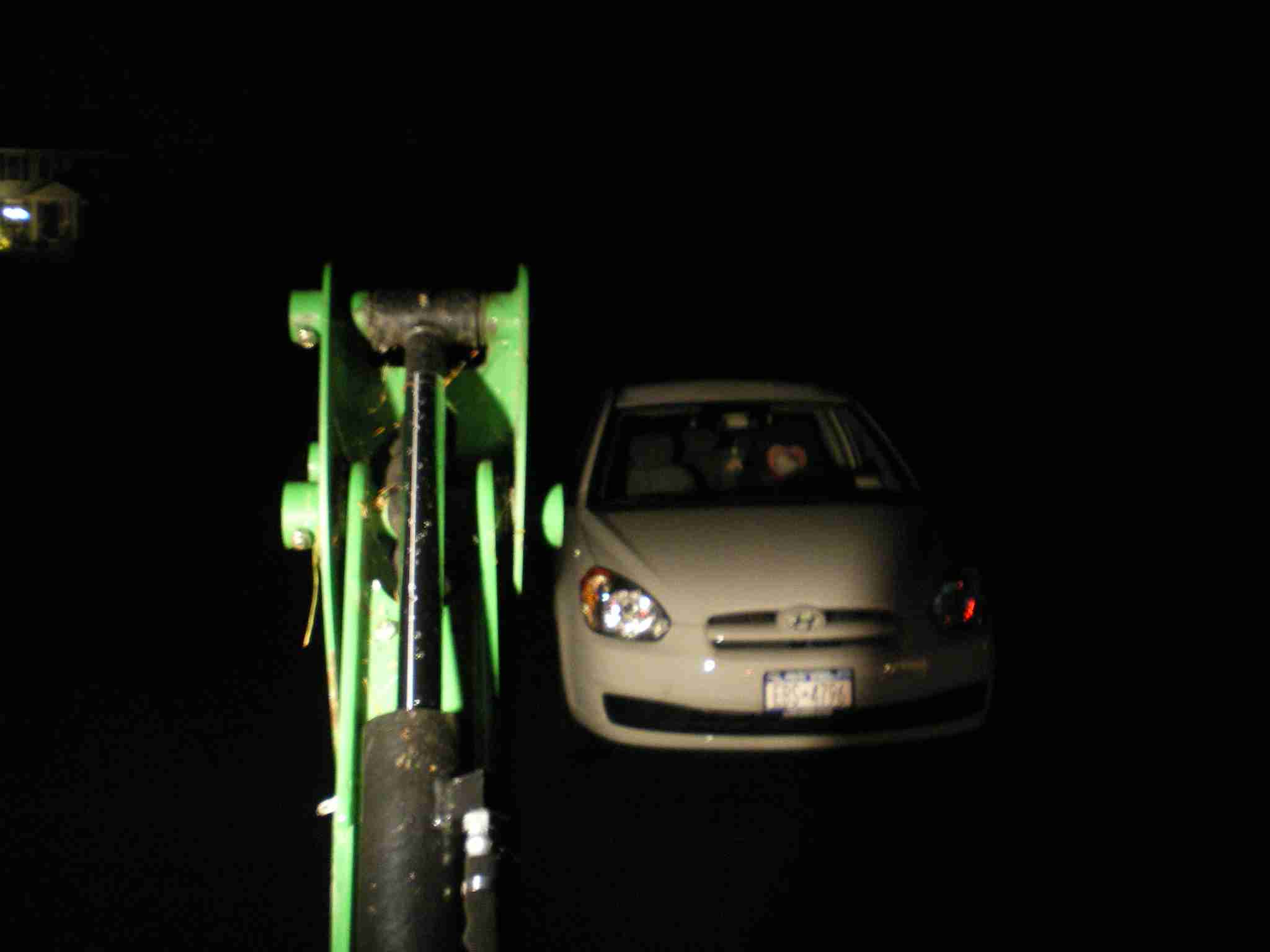

pics are no flash point and shoot
the front view is 10K HID
the rear is JD 688 work light
