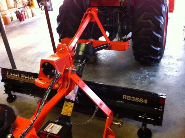

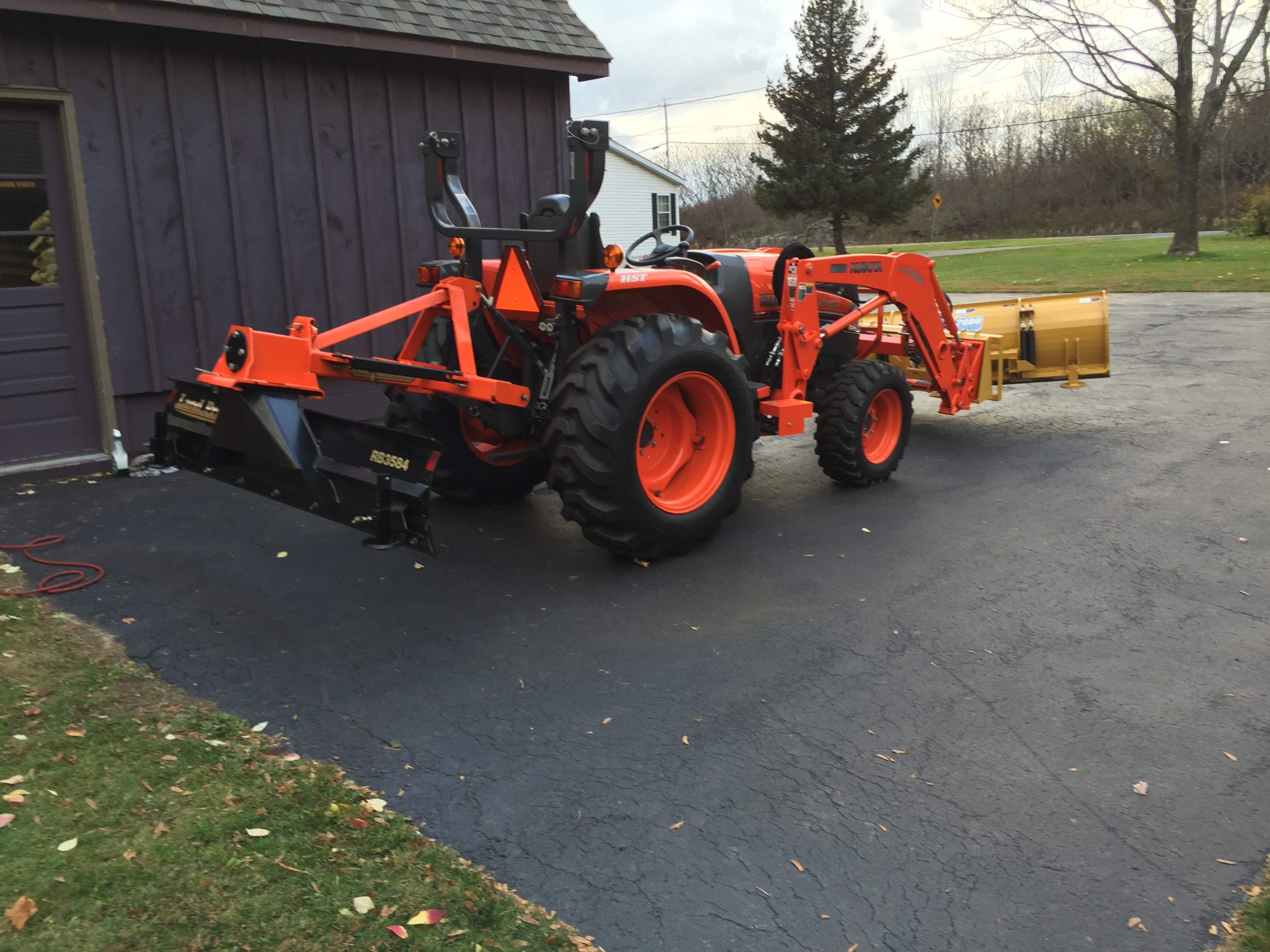

No matter what you use it's going to leave some marks on blacktop and or dig into un-frozen ground whether you use a tractor or pickup truck. That being said you can limit the scuffs, damage by trying different sized skids/shoes on your plow set up.An 8 foot plow weighs in quite heavy, I use a L3584 BB to clear less then 10" of snow on blacktop, but if I push and I said push with the blade reversed I have no issues on the blacktop with shoes/skids adjusted so blade is 1" to 1 1/2" above the blacktop. But if I push that snow onto the lawn the shoes/skids dig into the lawn, now if ground is frozen I adjust the blade so the shoes/skids are not doing anything and I can push from blacktop to lawn without any issues. It's basically the same for my HLA 2000 front plow, ground frozen = no issues, un-frozen have to be more careful . I think for you a large back blade would be the ticket.
