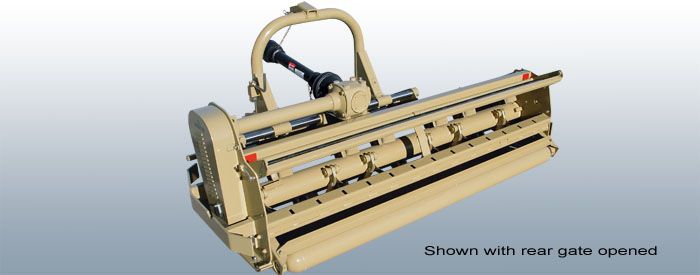

I wanted to share a bit more information about flail mowers in general and upload a picture of the heavier Landpride unit with its rear gate open to show how you can mow with it that way
and also change knives/hammers on both frame size flail mowers.
This unit has a worm gear shaft that allows the mower to be manually adjusted from side to side with a socket wrench, box end wrench or ratchet wrench.

Which direction does it rotate, same as tractor tires when going forward or opposite?
   / more information on flail mowers #3
What's the benefit of the door?
   / more information on flail mowers #4
The benefit of the door, is it can be opened up for very heavy cutting situations where the cuttings will "exhaust" out the open area. the Land-pride also has a row of slots built across the back ( the bar across above the rear roller) they have available "spikes" that can be put in the slots to assist in making the cuttings finer by re-circulating them. Another nice feature of having the rear door opening is it makes it much more user friendly when changing / replacing cutters. Much Much easier than removing unit and flipping it onto it's back to replace cutters.
