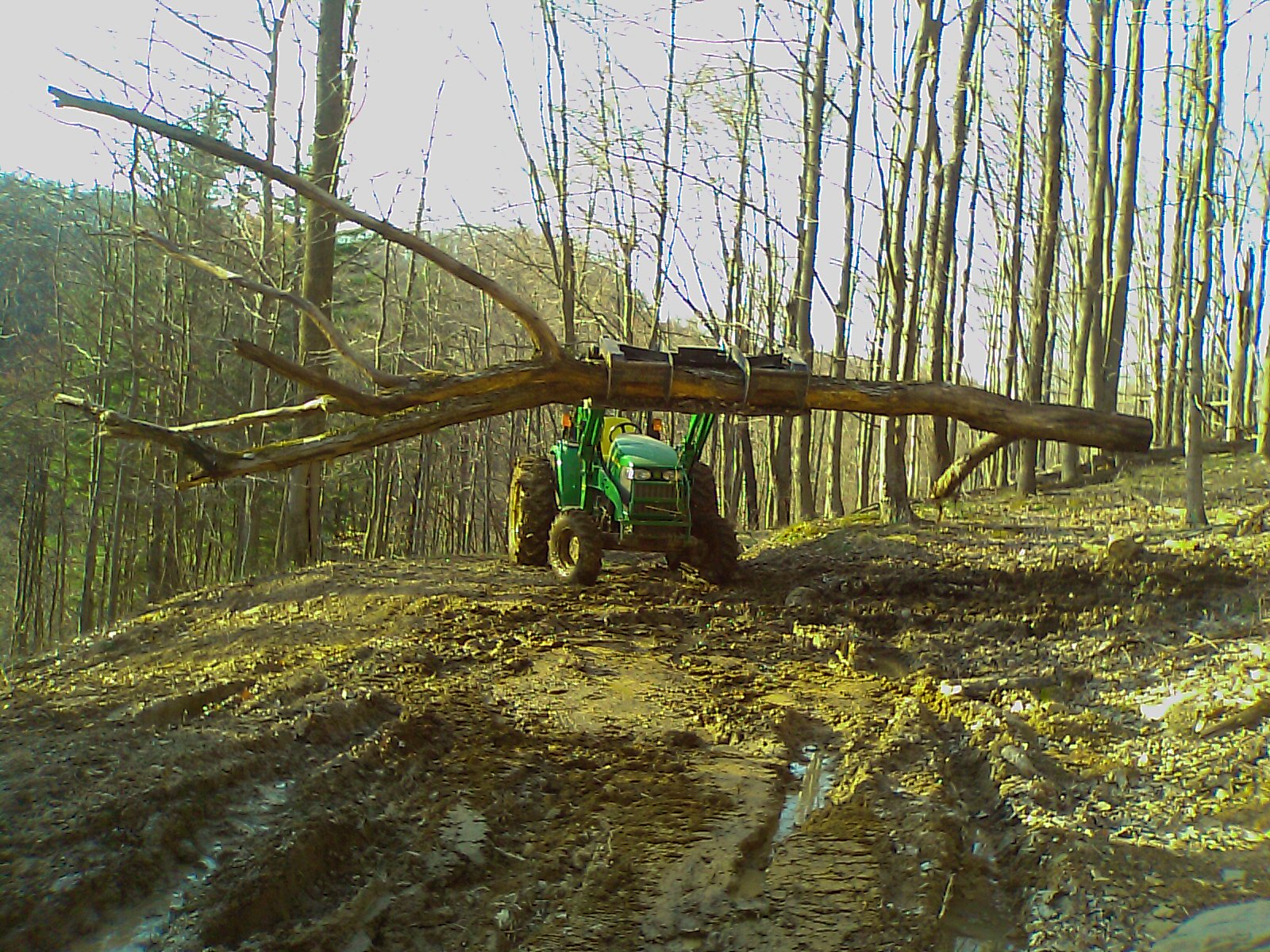

Go with the John Deere rear 3rd SVC, then purchase the JD kit that goes with hard lines all the way from rear SVC to front of bucket. The two kits from my dealer cost approx 200 & 300 each. Then I have the Frontier Grappler bucket and could not be any happier. (as picture shows) On the right side not on green fendor but below where arm is to adjust 3 point there is blank slot (just below) there where the lever goes to adjust the 3rd SVC.
