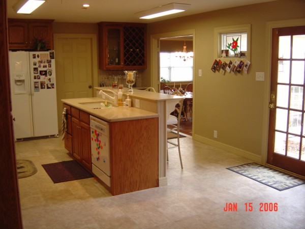

Here's the outlets on the island. Each outlet is a duplex and a switch. One switch (left side of sink) is for the recessed lights above the island and the other (right side of sink) is for the disposal.
