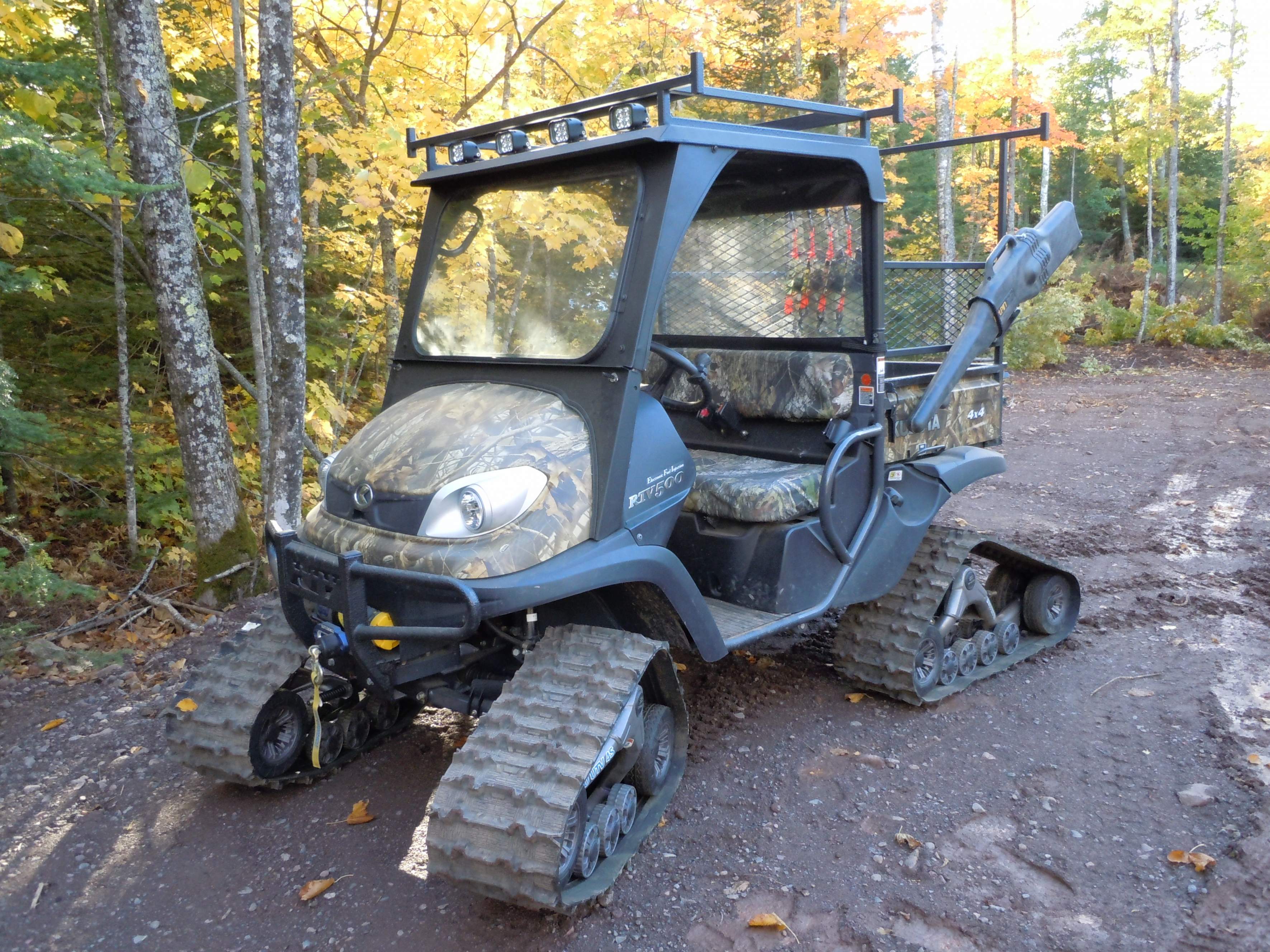

Here is a few add-ons that I've been working on this fall for my rtv500. I wanted a heavy duty cab kit so I decided to try this one from the perry company in texas (fortressatv.com). It's powder coated steel and has a nice head liner under the roof and rubber trim on the edges. The only down side is the front windshield. They have a removable piece but the hood doesn't raise much at all to access my tool box or the break fluid reservoir. This really bites as I like the dry storage under there. Other then that the price was nice, fit well and it shipped right to my shop.

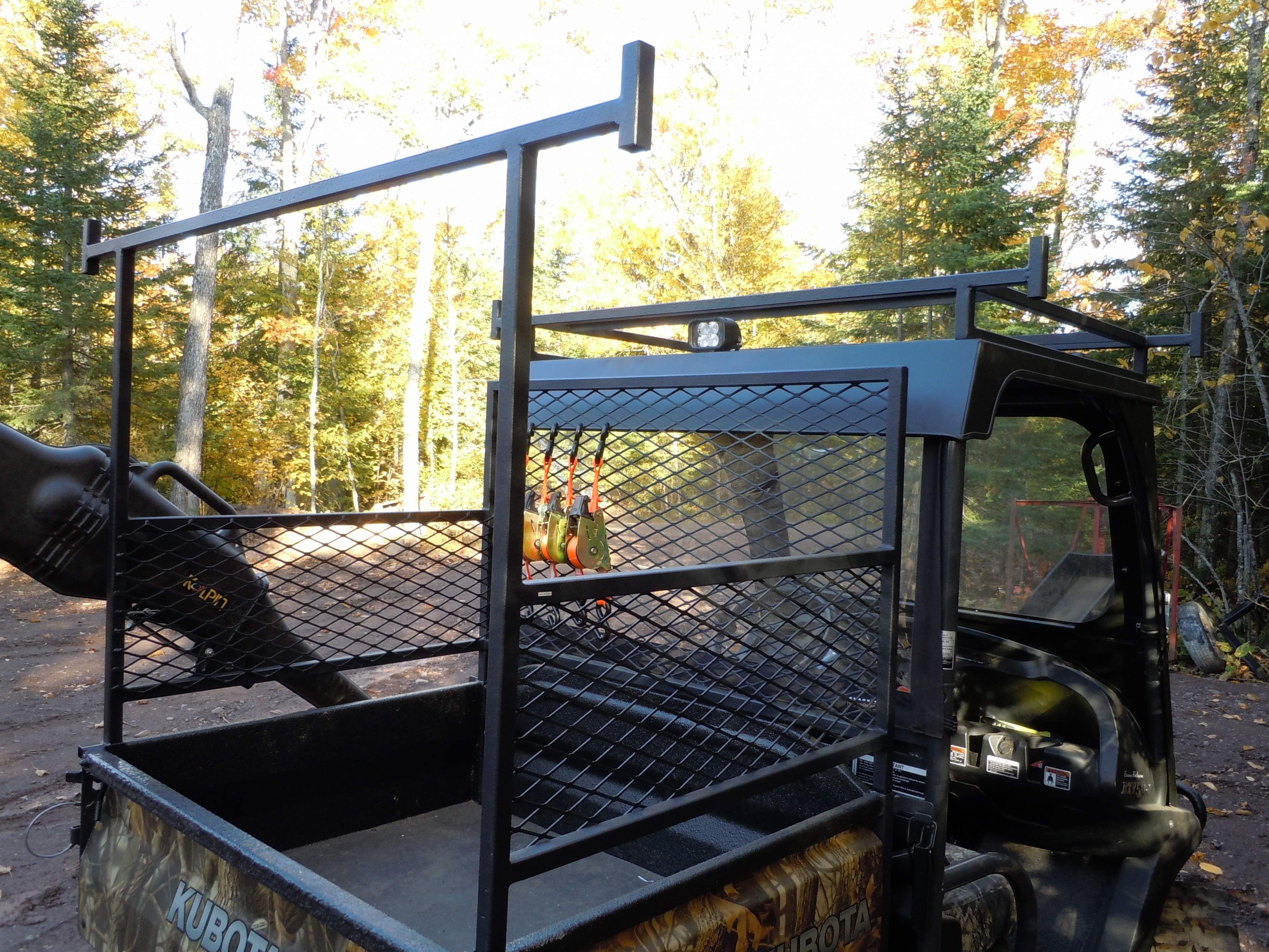

After the roof and windshield I welded up a roof rack and rear rack out of 1x1 tube and some flat diamond mesh. I used a bed liner coating to cover the things I built but I should have had it rhino lined or bought a better product because its already chipping off:thumbdown:(duraliner I think from Napa) Did manage to mount my gun case nicely to the side. The racks will work nice for hauling ladders, boats and wood.

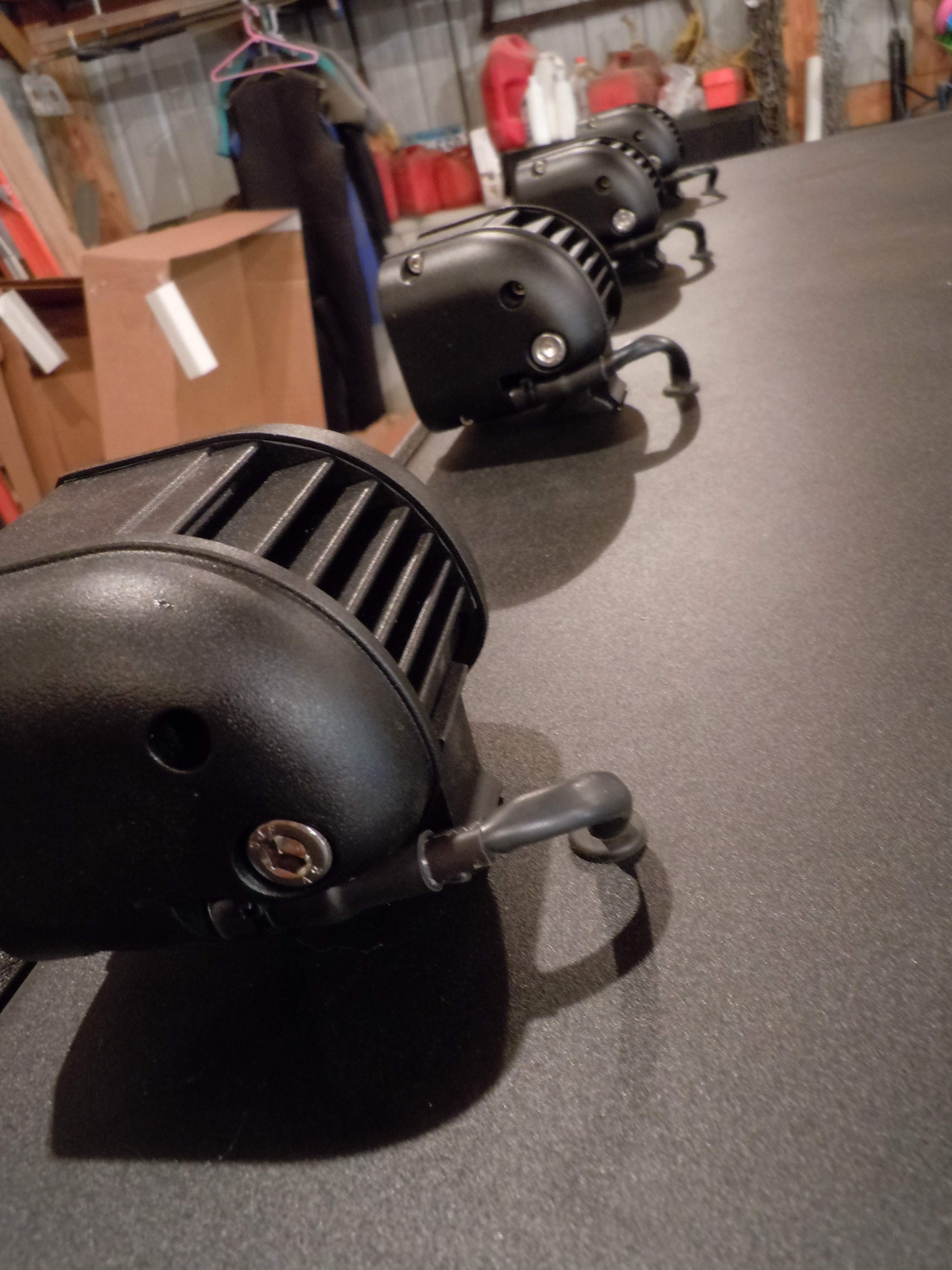

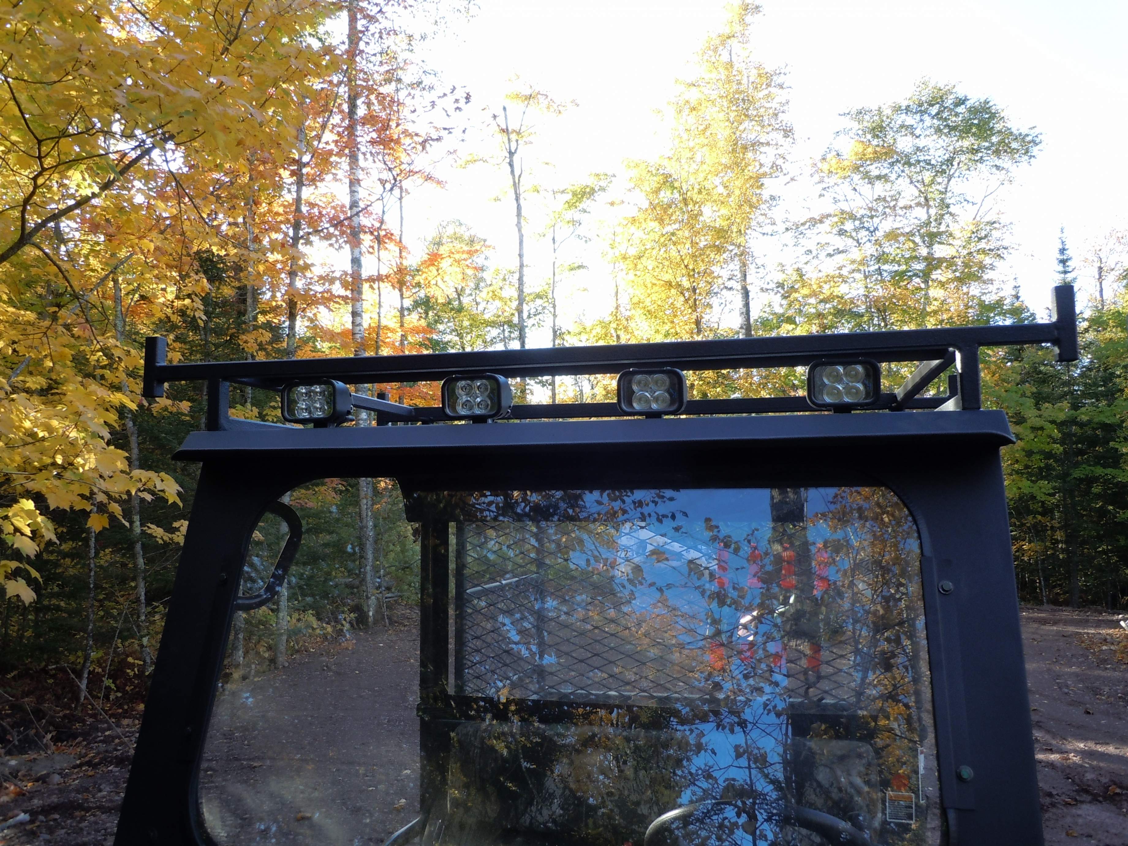

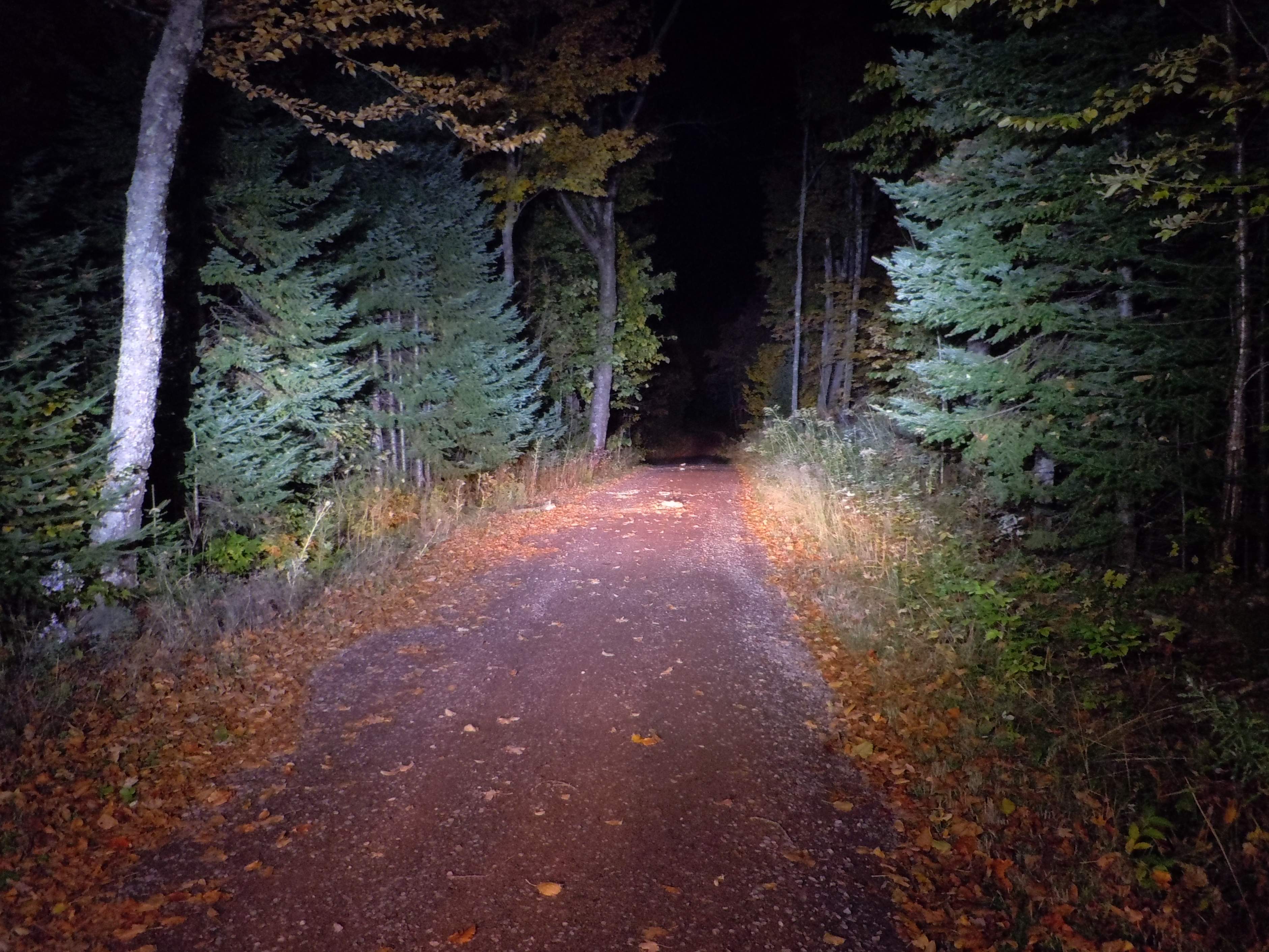

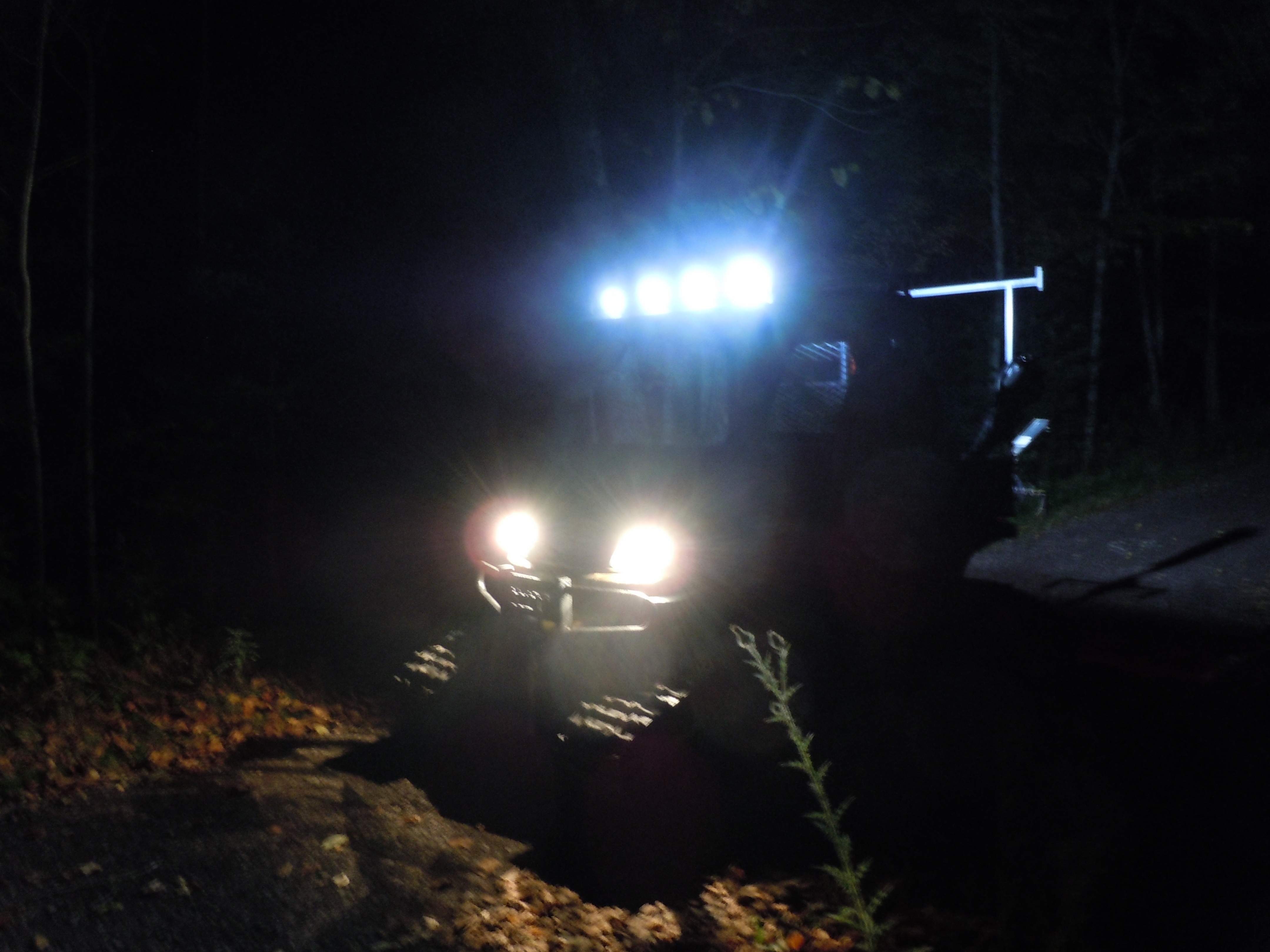

Also added lighting to the top. I bought some led's from x vision after searching the web. I like them for my use. Put 4 euro beam style in the front 1 flood beam in the rear. I took pics of the stock lights at night and then with the led's on. Inside the cab I mounted 2 red led's for nice ambient lighting. The red is easy on the eyes at night, used in cockpits for pilots i guess so I picked that for inside the cab but it's cool looking too I can't lie:laughing:

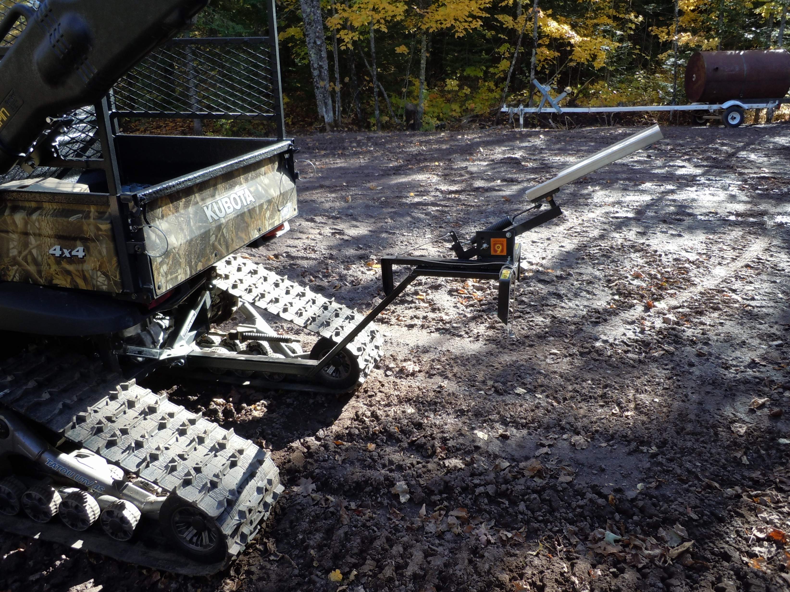

Oh yeah I built a receiver mount for my trap launcher too. Kinda fun to go out back and launch some clays sitting on the tailgate:thumbsup:

nuthingbeats them leds for light output where did you get them?been lookin to take them old halogen lights off my rhino and upgrade to leds. oh never mind i see you got them from x vision. good choice on the leds they won't let you down.
   / More add-ons for my bota
I got the x-vision leds from amozon. They are pricey but I think they are lifetime quality lights and so far they perform great. I always wondered if a 12"-18" bar would do the same. I see those every now and then on razors but decided to go with 4-4" so I could direct them for a wider field of view. Let me know what you end up with Tommy!
