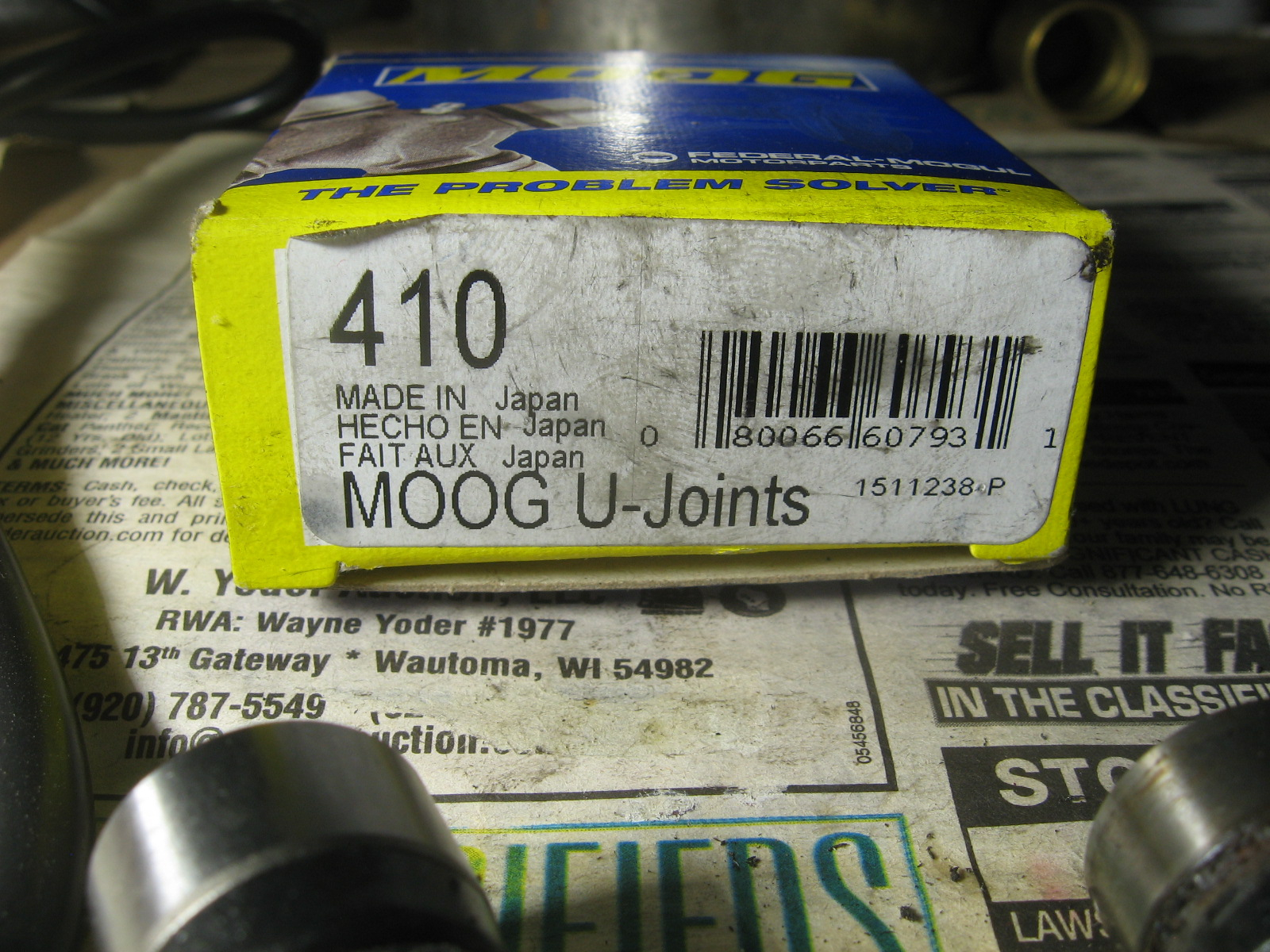

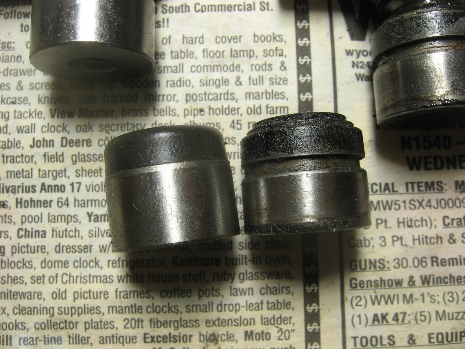

Some conflicting info out there about Moog 410 u joints being an acceptable substitution for the OE M802832—they aren’t.
Key difference is the retaining clip location OE uses clips that attach to cup itself (see groove in second pic below), where the Moog is designed so the retainer is installed in a machined groove which does not exist in the OEM design.
Some slight dimensional differences as well
........................................................... Moog............................... OE
Length without caps installed ............ 1.960 in ......................... 1.972
Length with caps installed.................. 2.156.............................. 2.187
Cup OD ............................................. .789..................................788
The individual needle bearings are also different lengths
Moog has a grease fitting that screws into one of the caps. OE has none.
   / Moog 410 U joints no go in 4100/4110/4115 #3
"Some conflicting info out there about Moog 410 u joints being an acceptable substitution for the OE M802832"
The only conflicting info is that the MOOG 410 is a replacement for the M80283. The M80283 is the 4wd driveshaft u joint. The 410 is the u joint for the main driveshaft not the 4wd driveshaft. They work fine for the main driveshaft. I put in a set yesterday.
