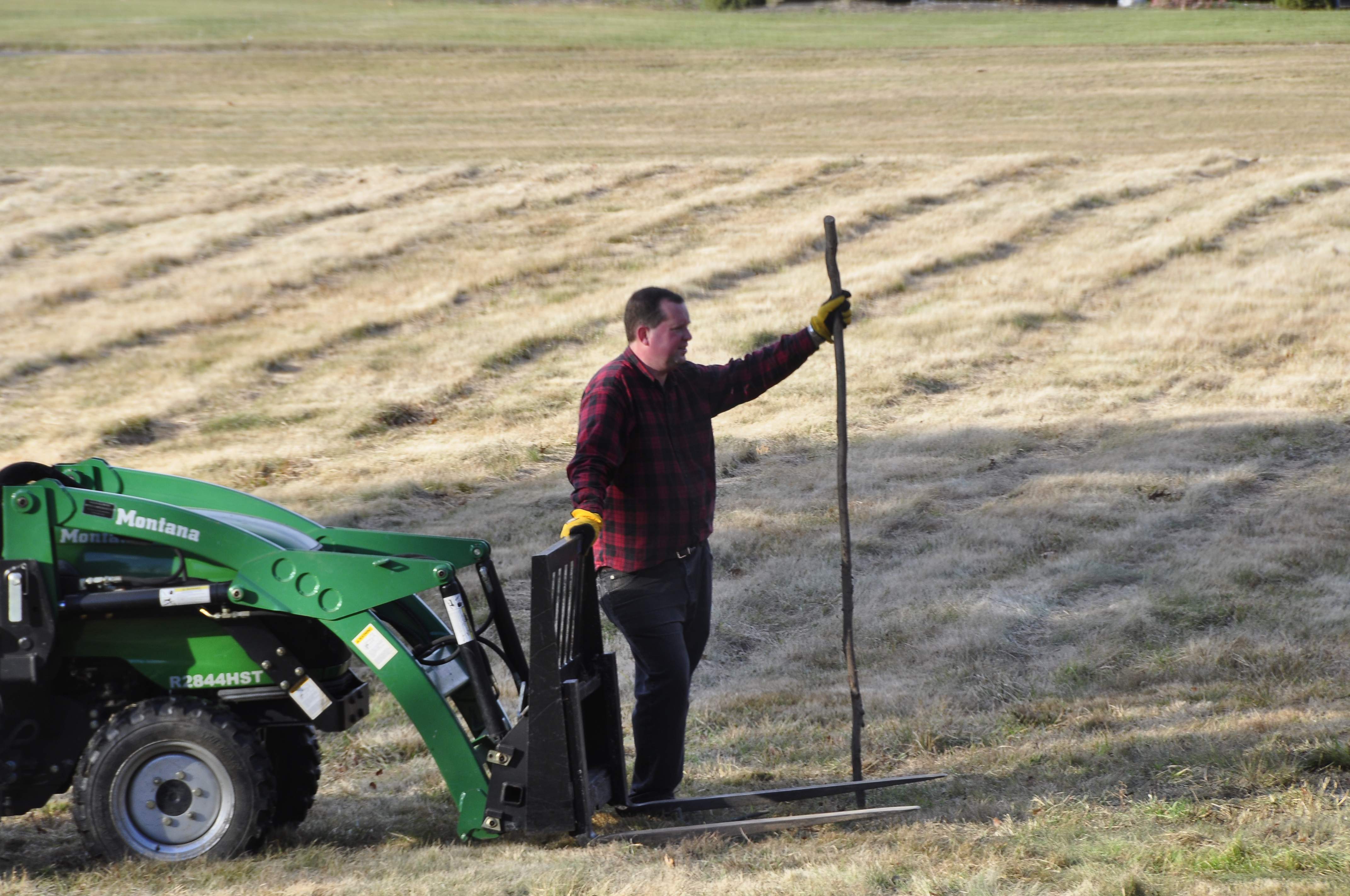

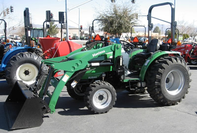

Do you know if it is the T100 loader. Look at the pic of my Montana tractor on the left side of this post. Does it look like that with the curved arms? As far as I know the T100 was the base loader used by Montana. It is a great loader. The biggest issue I have is keeping the rear end on the ground. I have loaded tires and keep a 750lb tiller on the back and can still tip it forward. Here are the specs on it.

   / montana loader on a kubota b9200 #3
Trying to load a better picture.
It has the curved loader arms but has a 54" bucket. Thanks for the specs! Much appreciated
