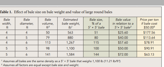

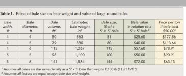

   / MONTANA 545 HYDRAULIC PROBLEM #9
Here is your tractor data.
FarmTrac 545 DTC with Specifications
It says your 3pt should lift about 3080 lbs at the the hitch points.
How much does a hay bale weigh?
The lifting weight depends on the length of the load also.
Can you find a place to install a hyd gage and check the relief pressure.
That will tell you if the hyd pump is up to the task.
Check it with no weight and hold the lever up until the relief sounds or engine rpm decreases.
The seals on the 3pt piston might be worn, causing a loss of pressure..
