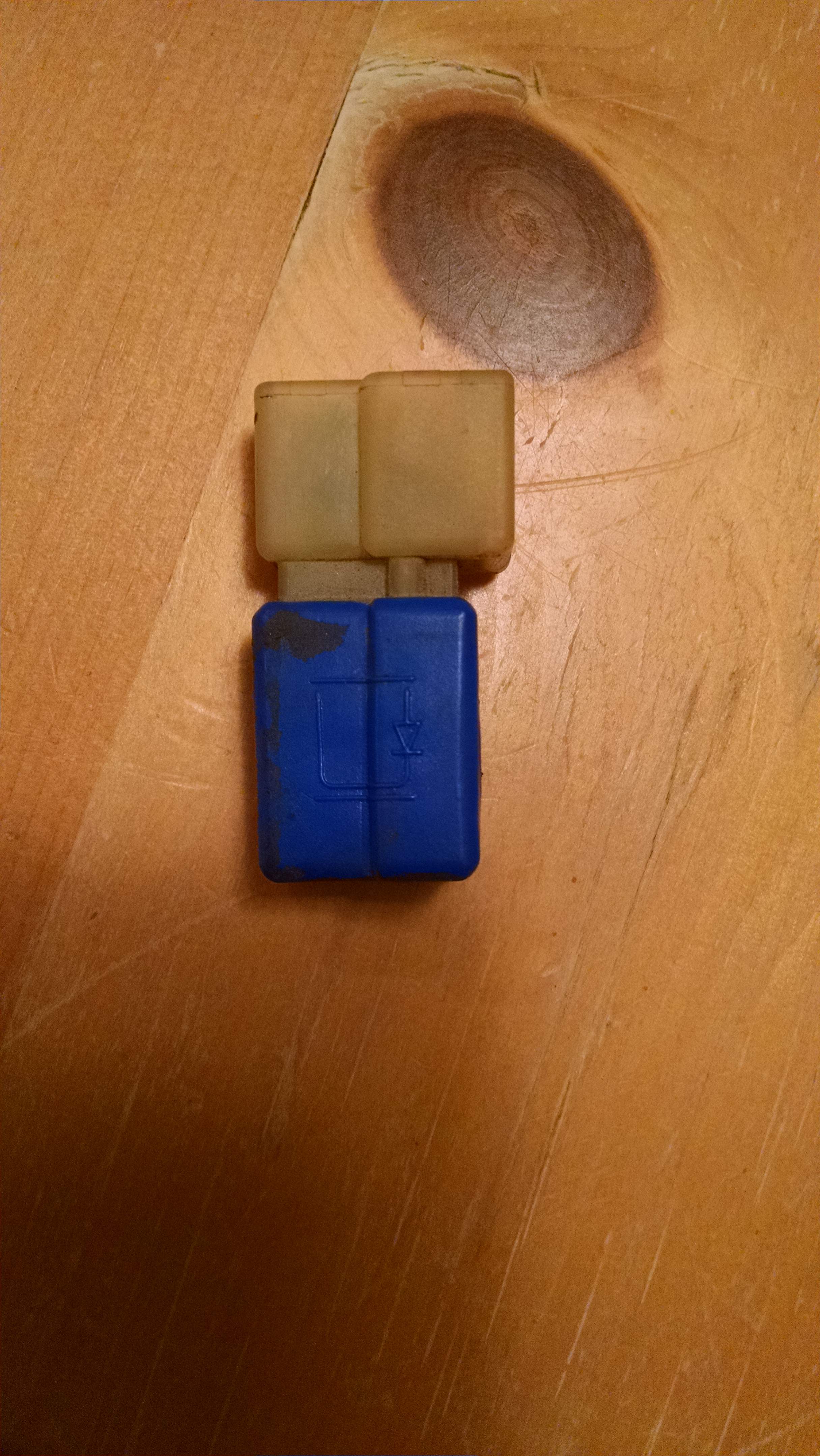

I checked for the fuse and found what appeared to be a relay of some sort taped right to the wiring harness just as you suggested. I unplugged it but I am not sure if it worked yet as I have removed the entire wiring harness. I am going to attempt to ohm out every wire and try to find the short. It is going to be a mess though as quite a few wires are chewed up.

How many terminals were on this "relay"? Any relay would have a minimum or 4 contacts. I bet you found the main fuse(2 contacts) Did you ohm it out? Was it a dead short (therefore good) or was it open (therefore bad, ruptured, blown)? I feel for you, with the chewed up harness.. That can be a handfull for someone who is even familiar with that particular harness. Nasty rodents.

There were only 2 terminals so i would agree that it is a fuse. It was wierd that it had the electrical symbol for contact and not the fuse. I am going to ohm it out tonight and I will let you know what I find out. Looking at the parts diagrams I cannot find a replacement part number for this fuse.

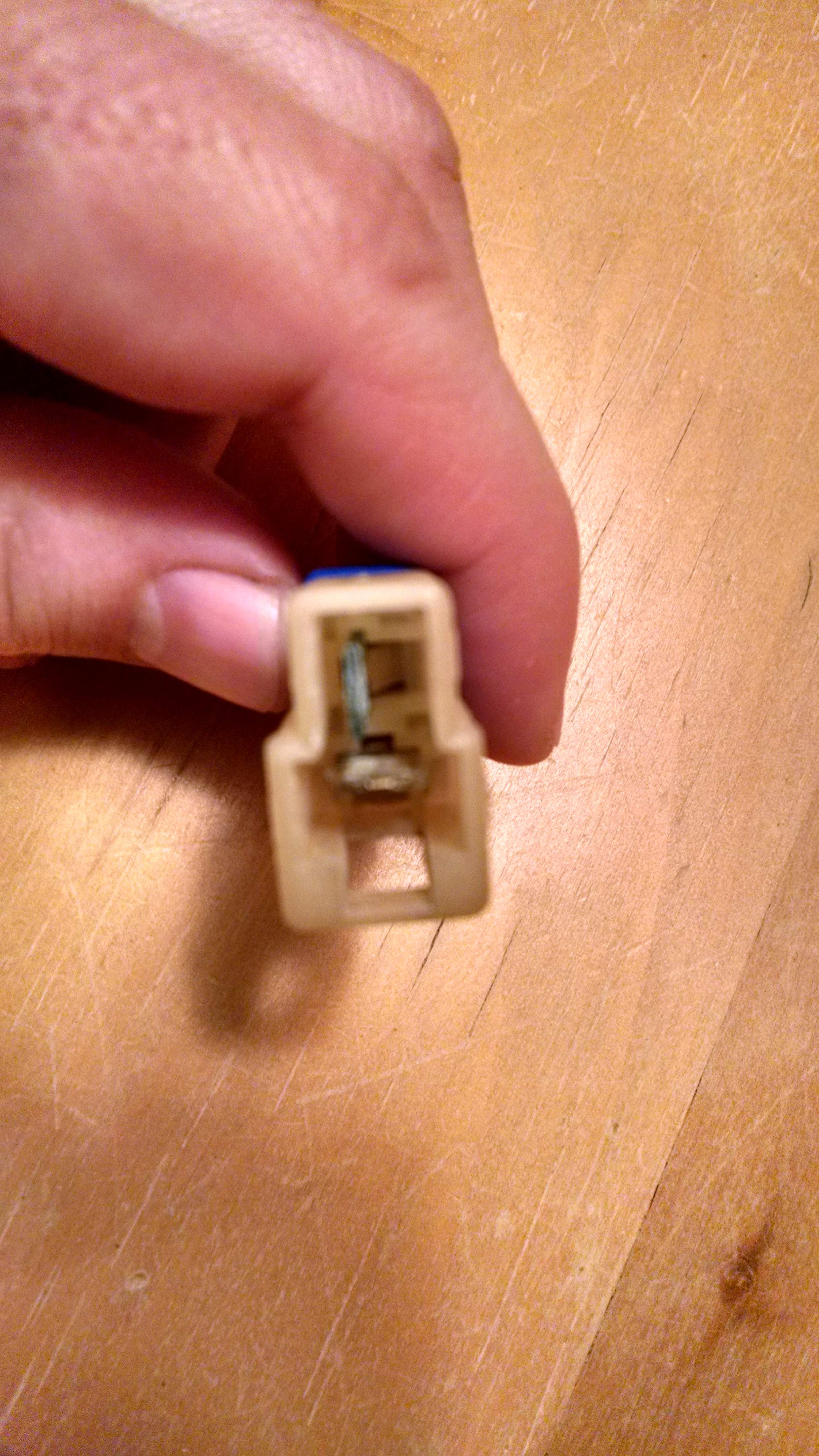

Ok I just made it to the barn to check this fuse. I pulled it off and its not a fuse its a diode! I am assuming it is for the charging circuit between the alternator and battery. My meter did not have the ability to test a diode but i will get one today at work and test it tonight. Here is the pictures of it. IMG_20150211_191042099.jpgIMG_20150211_191057570.jpgIMG_20150211_191105253_HDR.jpg

I doubt that diode has anything to do with rectifier charging voltage.. That is done inside your alternator with what is known as the diode trio. Your alternator is 3 phase AC and is rectified inside of the alternator case. Modern tractors have a lot of these diodes around the wiring harness often for relay coil "spike" or back EMF suppression (EMF stands for Electro Motive Force). When you remove a voltage from a relay coil the built up magnetic field collapses and a reverse polarity pulse or spike comes out of the coil into the electrical system. These suppression diodes are biased to short out this pulse. These diodes can also be used for other purposes.
If you would like fun filled experiment, take any 120 volt transformer primary winding (it is an inductor or coil of wire just like a relay coil) and touch a 9 volt battery to its primary winding. now put your hand across the primary winding, and remove the battery while keeping your hand on the primary winding. It will knock the snot out of you!:shocked:
The little 9 volt battery causes a magnetic field to form in the primary coil, and when you remove the battery this magnetic field collapses, and causes a large surge of voltage to come out of the coil.
In a pinch you could test the diode with a tail lamp and a battery and some wire. First test the tail lamp by hooking it up to the battery and make sure it lights. Then place the diode in question in series with the battery and the lamp, either direction. The lamp will either light or it will not. Now reverse the polarity of the diode in the circuit keeping all other connections the same. If the lamp did not illuminate in the first diode test, and when you reveresed the diode it still does not light, then the diode is open. If the lamp illuminated on the first test and still lights on the second test where you reverse the diode, then the diode is shorted and bad. If the lamp illuminates on the first test and does not on the second test, then the diode is "good". This is what diodes do, they allow current to pass in one direction and not in the other. Good luck
