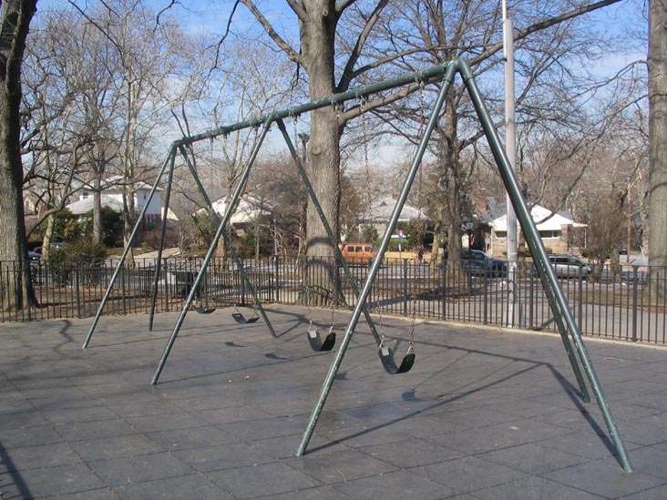

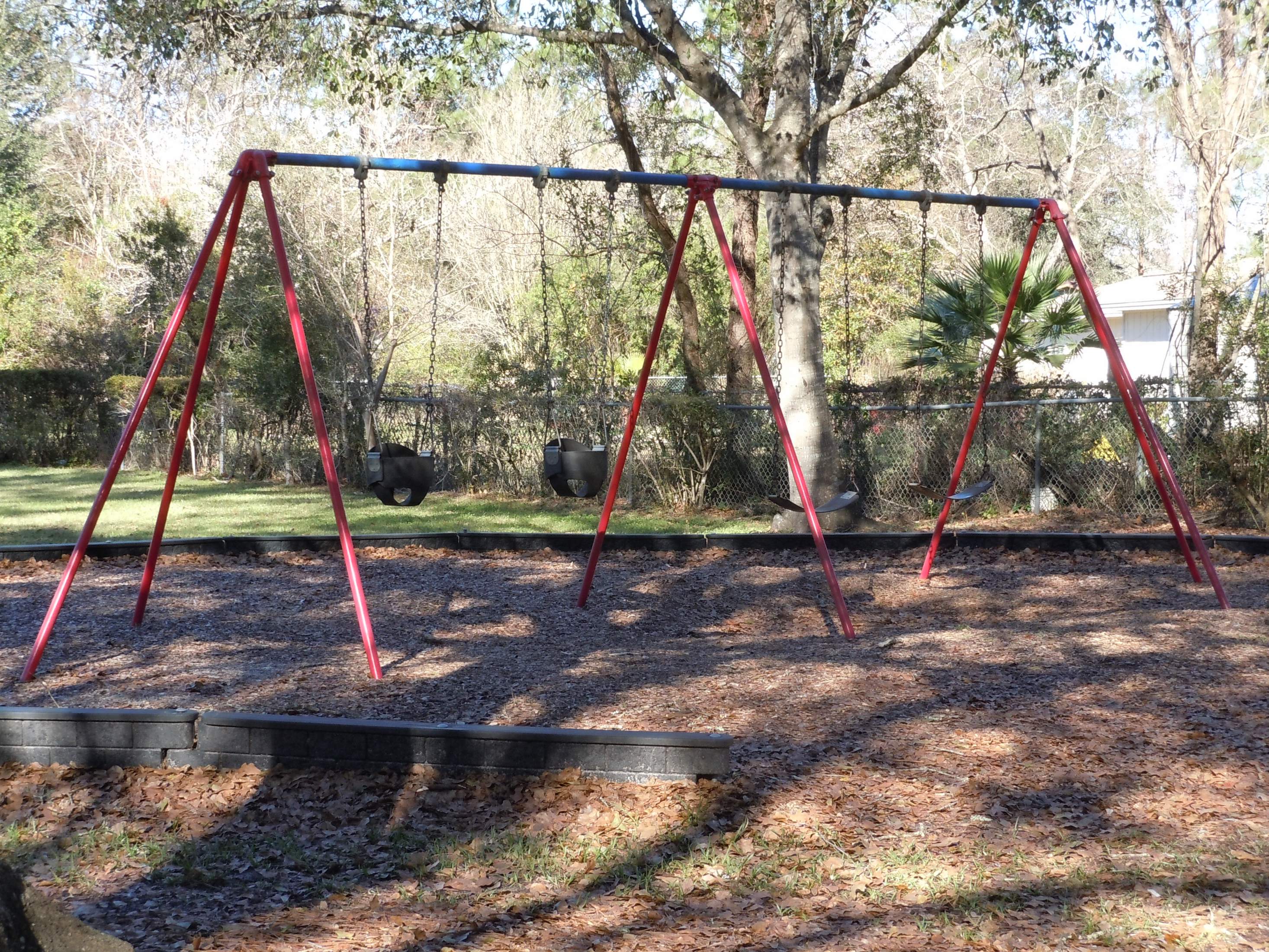

most of the swing sets that were around when I was a kid were made out of 2" pipe, some welded up by the local welder using some gussets at joints and some were kits Is my guess, like sold yet today,
but I would think an A frame set would be better than two posts, if you choose to use two posts, use large posts, 8" min for wood IMO and 6" steel pipe, set deep 4 foot min in concrete,
you get up 10 feet and have some body like want to relive there child hood and try it out that 250 pounds is amplified many times over at the top of 10 foot and moving with force at the top of the posts,

most of the swings I grew up on were like the one in the pictures below,
