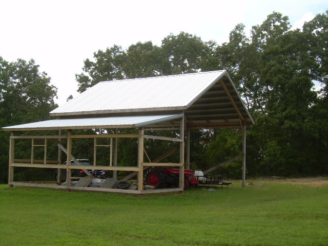

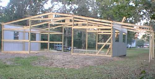

I built a socketsystem barn. this is about as far as I have gotten with it. siding, an additional right side shed and a loft are in the future plans.
The reason why I chose them was it did not require a crew to build it. My father and I did all the work by ourselves. The barn is 24'x24' with a 12'x24' shed

That Monitor Barn looks extremely similar to a horse barn I built a few years ago except I left some space for windows. I did not use any metal components except for Simpson hurricane ties and I built it completely by myself, though it would have been easier with some help. My barn was very sturdy with the posts set in the ground 4 feet and I am sure it was way cheaper to build than that one. Their video shows 4 people setting up that barn.
