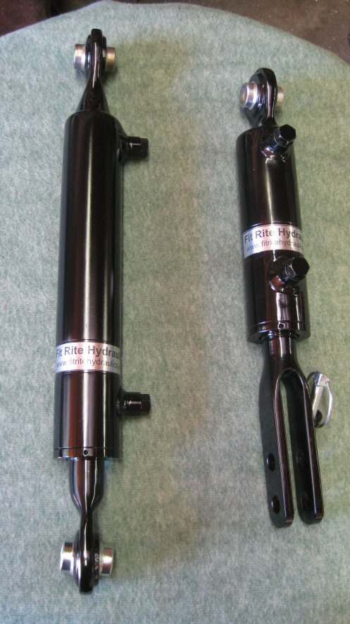

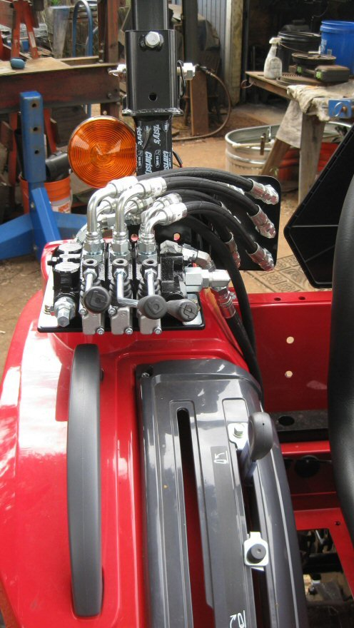

I've got most of my parts ordered and some parts won't be in for a few months so I ordered a couple others for temporary use in order to get up and going now. Cash out of pocket I may come out a little less. But if I calculated the time alone spent on research and shopping parts, It's way way over! That don't count time it will take to put the parts together that Brian does, welding the cylinders for the right size, making up hoses to fit from valves to qd's, making brackets, painting cylinders and valves, etc.
In case you didn't get my point, ordering it from Brian now is a whole lot easier! and I'm fairly decent at put'n stuff together.

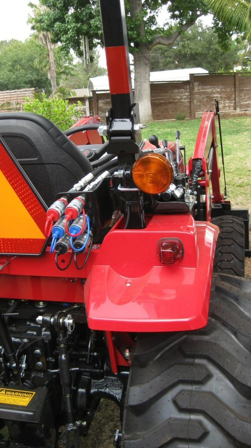

I have extra top links for using tiller/flail with or w/o PEC on the draft arms depending on which tractor one's moved to. No big length adjustments, just selecting one for each application and maybe a tweak when checking that the lock-nut is secure.
Two CUTs have hand-crank leveling boxes (~$120?) on the right lift link. I count handle turns CW or CCW to tweak during a job. On the one that doesn't have that I set to ~level with the middle hole on the RT lift link. When grading I move to top or bottom hole for a quick tilt in either direction, not much more to do than say moving top link up or down at it's anchor.
I wouldn't hesitate to have Fit Rite supply any/all my components (y) just might not want to add everything they offer esp all at once. Lead time could be used to save up for any gotta haves if the luxury bits aren't as much immediate necessity as nice to have. I'd have trouble deciding which machine to 'deluxe' up to top level.
btw, alternately, nearly $3k might buy a nice grapple and FEL diverter 'kit', chipper, splitter, stump grinder, blower, generator, etc I might not need T & T in tough times or emergencies, and for me climbing on/off to use/adjust is good exercise. That besides checking fluids & tire pressures or greasing a FEL between which tasks I get comparatively a lot of seat time for my legs & butt to go to sleep mid-job. (old age, lo BP lol)
