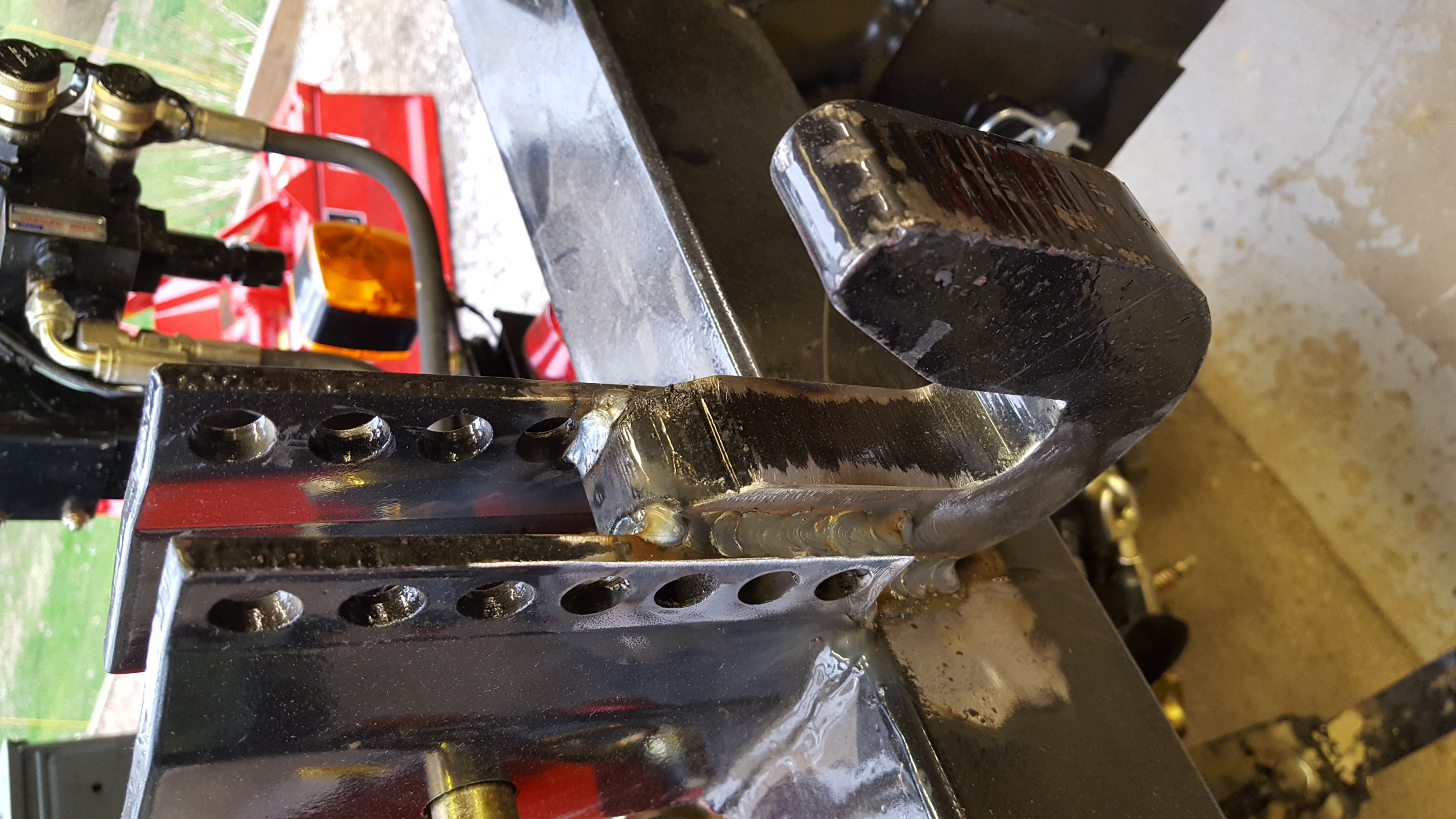

The only modification needed to the quick hitch was removing the 2 bolts from the top link hook and welding the hook in position.
The bolts made the top of the hitch too wide to fit between the frames of the implements at the top pin.

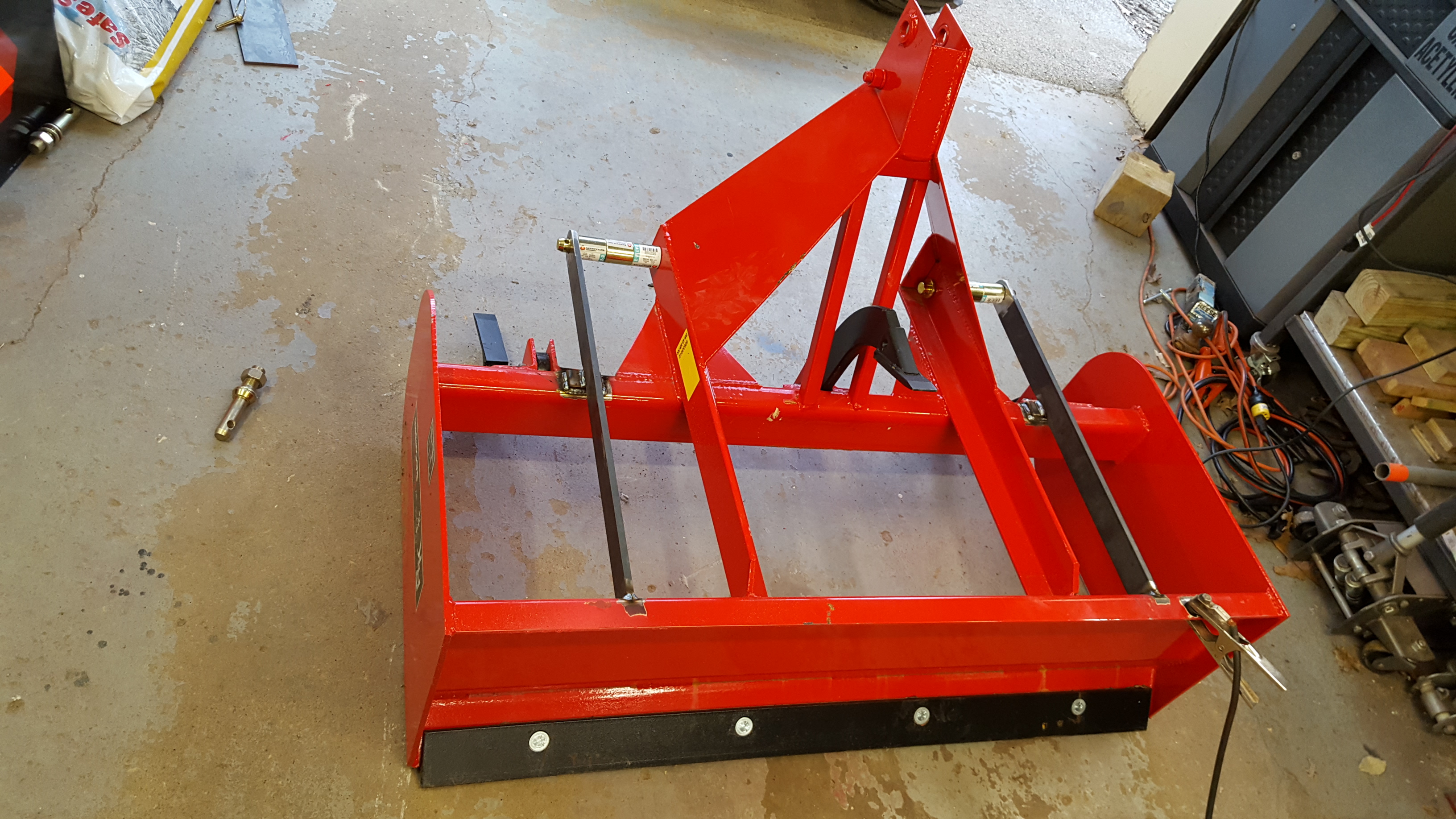

The box blade already had a quick hitch compatible top pin, so no modification was needed there.

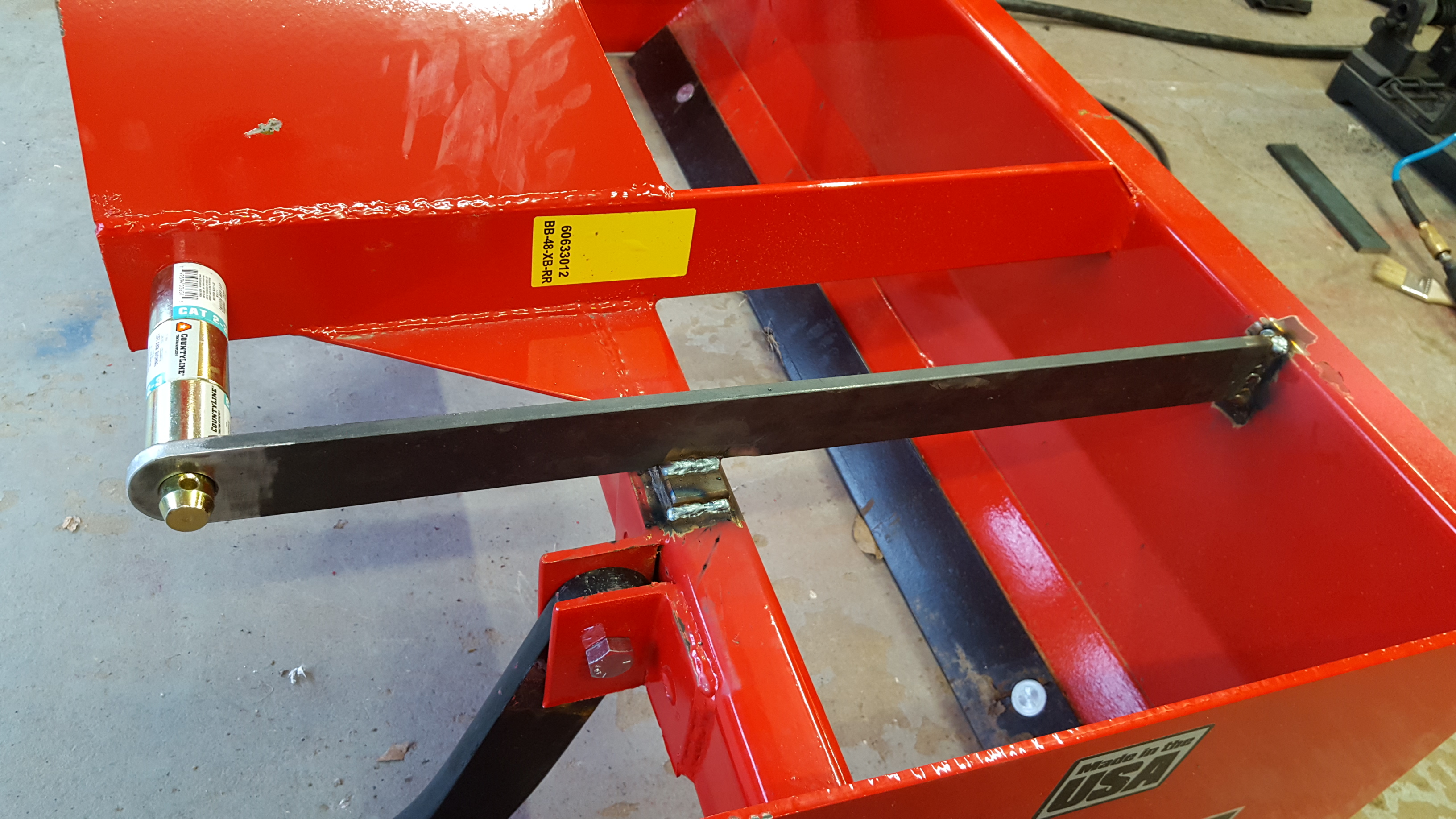

I could have simply purchased a pair of adapter bushings for the lift arm pins and been off to the races, but I don't like the idea of the outer ends of those pins being unsupported.
With ground-engaging equipment like a box blade, and the high forces involved, I was worried about the short, stock, CAT-1 pins bending over time, let alone longer CAT-3 adapted pins.
For this reason I chose to add two sections of 2"x3/8" steel to support the outer ends of the pins.
I purchased two 6-1/4"x7/8" pins, and removed the handles from them. I also purchased 12 bushings for on the pins to step them from CAT-1 to 2, and 2 to 3.
The end result is 100% quick hitch compatible, but can still be attached directly to the CAT-1 arms/top-link if needed. And in either configuration, I don't have to worry about bending pins or tweaking the frame.
Everything looks great after a couple coats of paint to touch up the bare steel.
Still to come are similar modifications to the tiller and ballast box.
Sorry for the sideways picture.

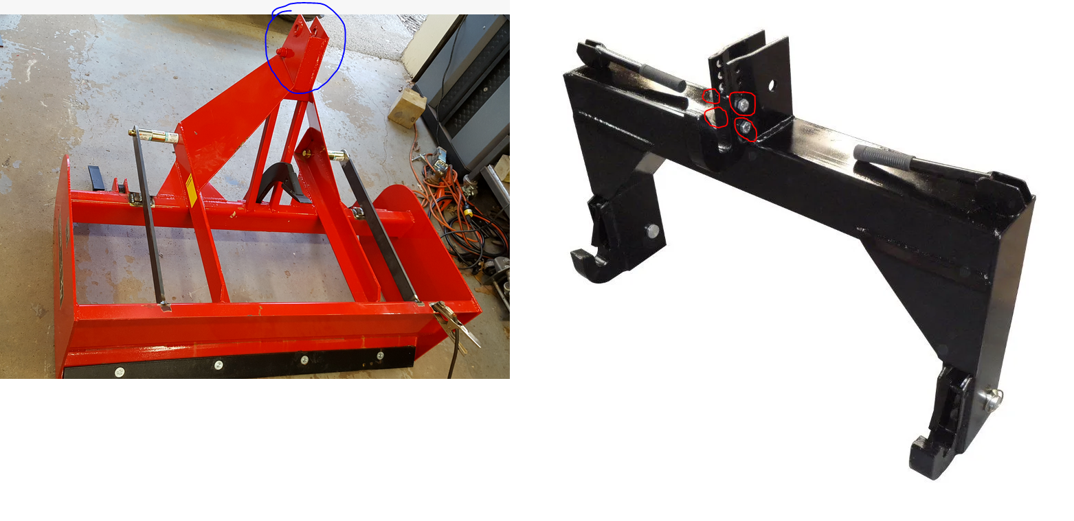

Not sure I understand what part of thr implement was hitting the toplink bolts?
Those are made to be adjustable. Mine is...bolts dont interfere with any implement I have hooked to.
By welding.....going forward, you will have to make sure all of your implements are now the right setup for the permanent hook. Which will rule out alot of older stuff. Alot of older stuff kept things pretty standard on the lower pin spacing. But the height of the toplink could vary quite a bit based on my experience.
Do you have a picture of what/how the bolts were interfering?
   / Modifying RK Implements To Make Quick Hitch Compatible
The circled bolt heads (and nuts and lockwashers) were enough to hit the front edge of the circled side plates, and not allow the hook to go back enough to catch the top link pin.
If I ever buy other attachments that don't fit the now-permanently-welded hook, I can adapt them. Also, the quick hitch cost all of $70-$80, so no big deal that I permanently changed something on it.
My thinking is, I bought the quick hitch to make hooking up attachments easy. If I have to get wrenches out and reposition a hook every time, that's not really quick or easy.
If I put a little time and effort in now to make my attachments fit my quick hitch, it will be smooth sailing from here on out. A one-time modification is worth a lifetime of easy hook-ups to me. :)
