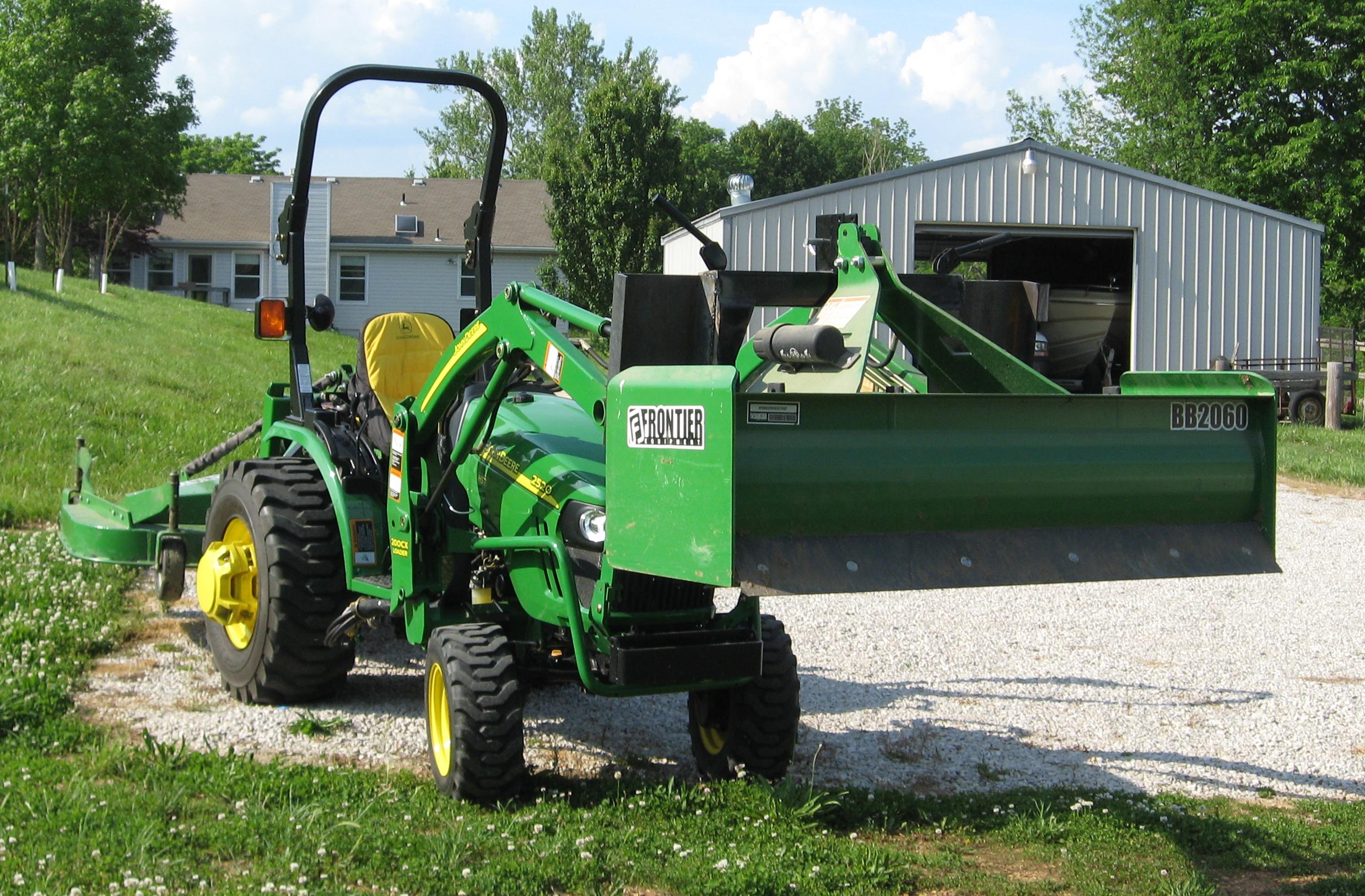

I'm in the prosess of making one now. I got a quick hitch and a quick attach plate and am ready to weld it together. I just sent a complete setup back today. Nothing was straight on it! Hmmm I'll see if i can get a pic tomorrow.

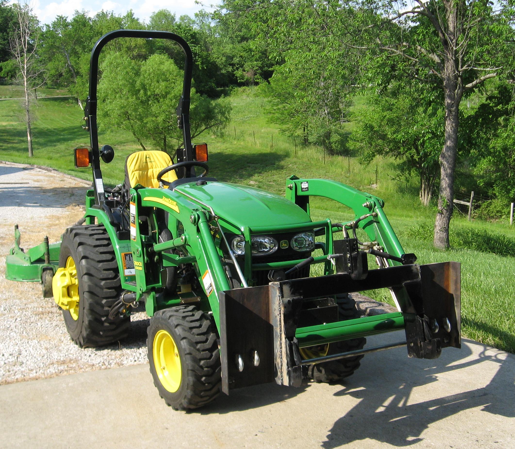

You can make yourself a loader-mounted quick hitch like this.

My only concern would be that it puts it a couple feet out past the end of the loader arms.
   / Modify rear blade to front blade and back? #8
I would be concerned about that also. I am working on a design that would mount on the Q/A on the loader and the 3PH. You could use it on the loader in the winter and the 3PH in the summer. The design eliminates your concerns.
   / Modify rear blade to front blade and back? #9
How? It sounds like the same thing.
How about a front frame mount 3 PH, shouldn't be too diffecult, just the lift and you could maybe use the loader for that?
I don't like the idea of impliments way out in front of the loader either.
JB.
