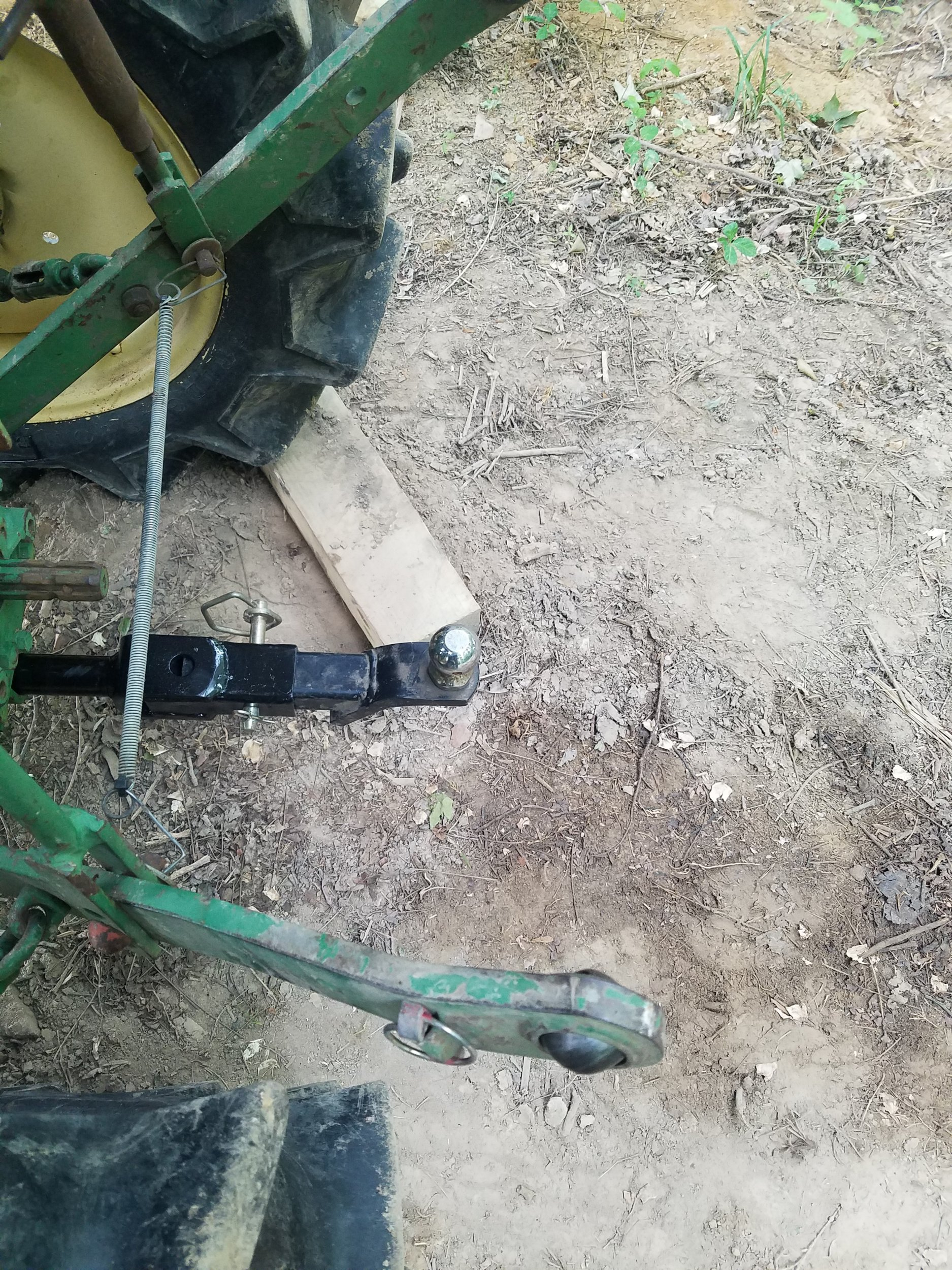

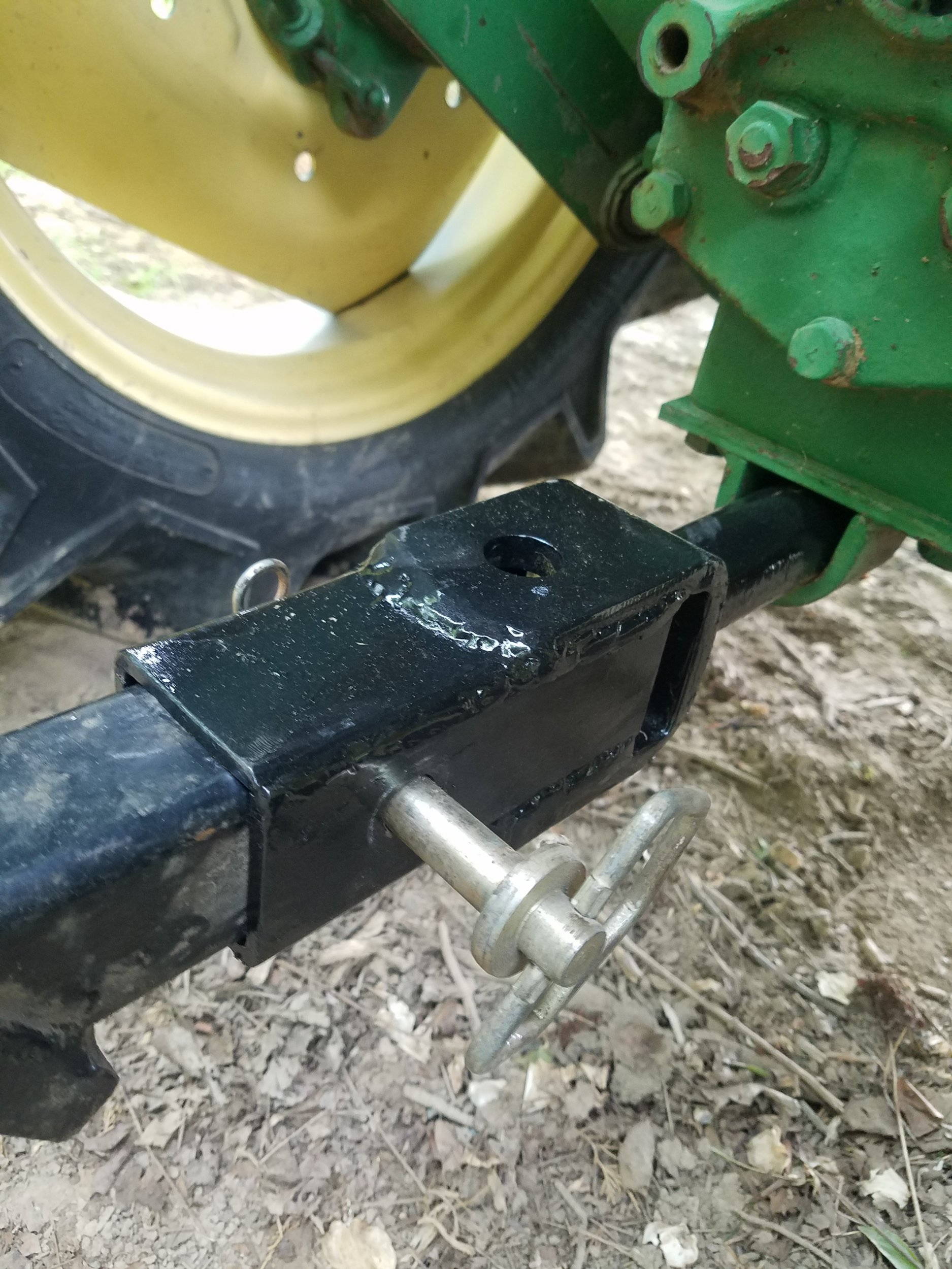

Needed to hook up to a utility trailer for serious tractor work.... hay ride for the kids.... not a fan of 3 pt drawbars and the stock one is about useless in stock form.... soooo I started cutting and welding... VERY pleased w my results....
Obviously the added length would reduce vertical capacity but I won't have more than a couple hundred lbs of tongue weight...

Forgot to mention... in the pics above the drawbar is in the extended position... can retract and use the other hole if wanted

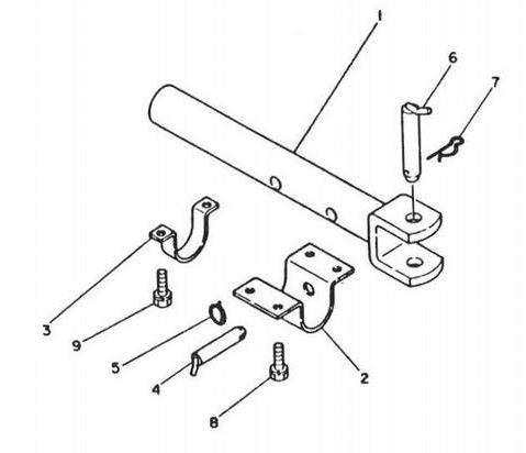

Looks as if you machine came WITHOUT the OE tow bar. Item-6 can be a regular tow-ball.
   / Modified my drawbar to actually be useful
No it came WITH it and it's still there....
Problem w item 6 is that it's too far forward and the tires get into the trailer on turns

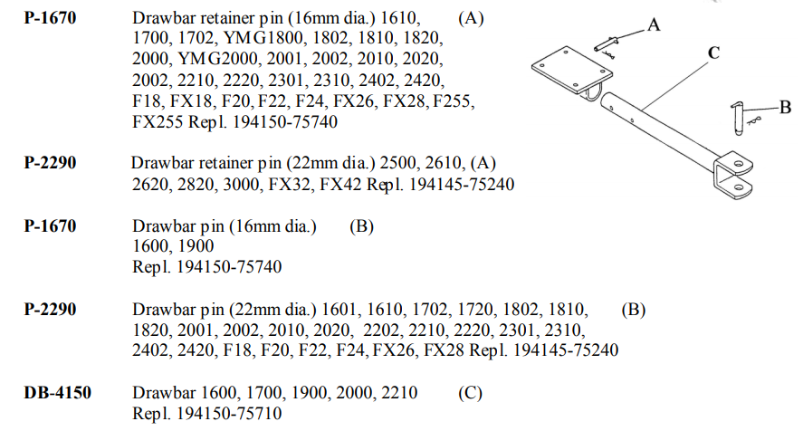

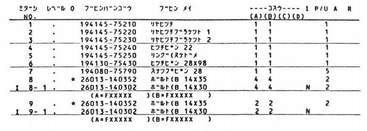

Yes, the system is designed to extend and retract. Here's all the details from Fredricks Equipment Catalog on Parts.

Notice the machine needs a PTO shield. Not only for safety, but to prevent the top-link from falling down upon a PTO shaft causing damage. I can't count how many times that simple shield saved my PTO shafts from getting banged up.

Yeah before even in the extended position it wasn't extended enough...
