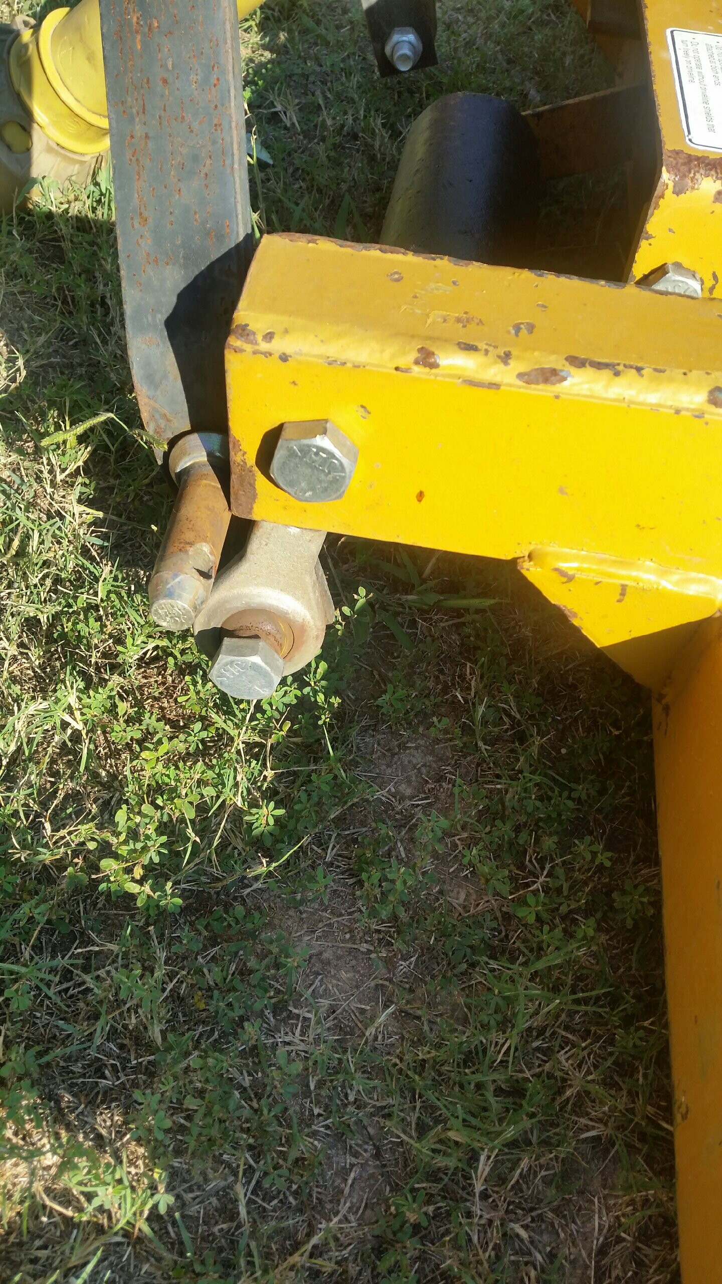

Thought some might like to see how I adapted my KK finish mower to my HFQH. I mow regularly with my tractor, but still use it for other things and the HFQH makes it a breeze to drop/hook up now that I took the time to adapt it.
Orig. floating dog bone attachment at bottom:

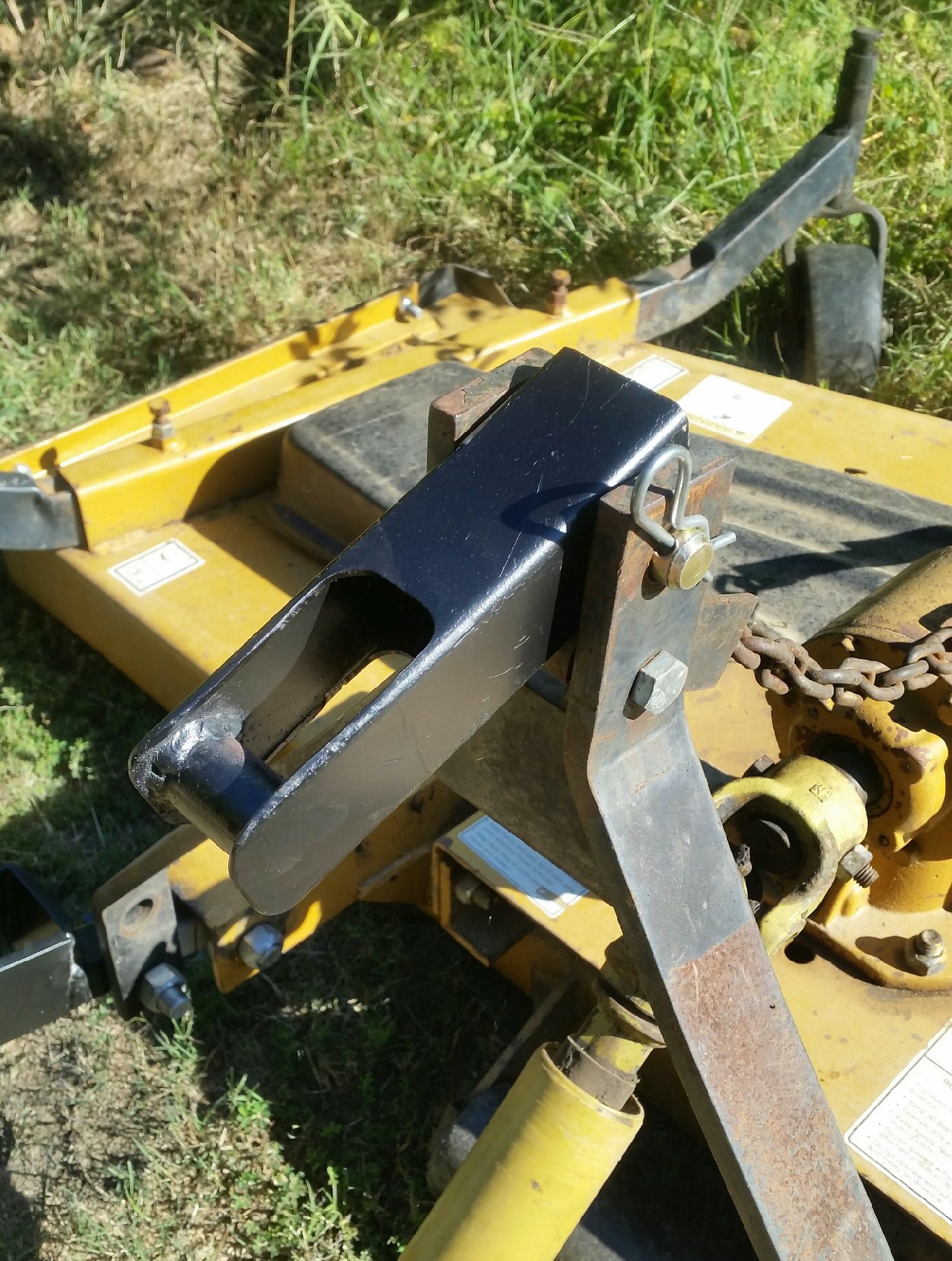

New bottom links:
New top link extension:

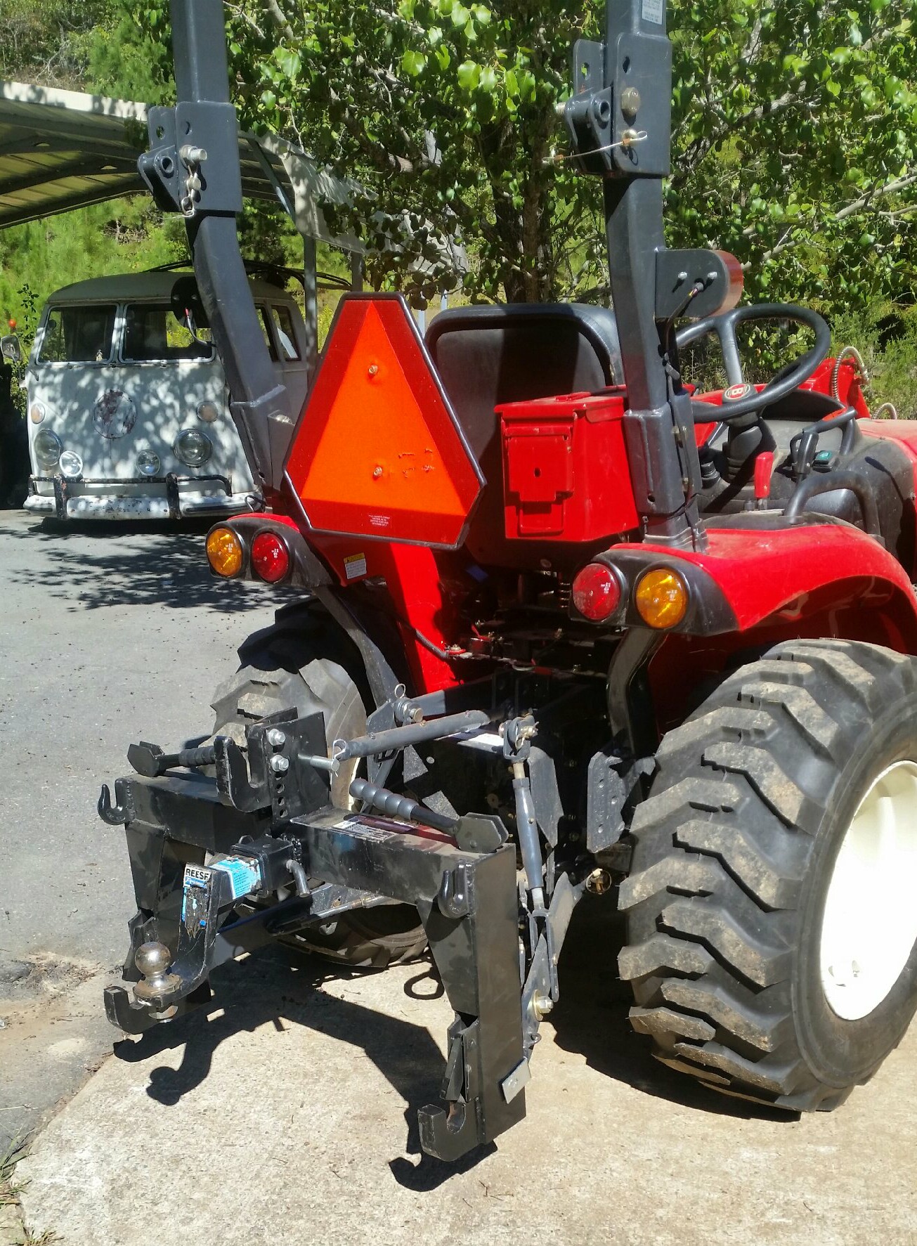

HFQH on Branson 2400h; modified w/2 weld on chain grab hooks and frenched-in receiver hitch (allows room for pto shafts):

Is the PTO shaft going to long enough? Ken Sweet
