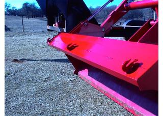

Picked up my 6000 with the new ML260 FEL installed. First thing I did was modify it!! /forums/images/graemlins/shocked.gif
I welded a 6' piece of 2"x3", 1/4" thick angle iron to the top lip of the bucket to beef it up and welded on three 5/16" clevis hooks for lifting.
I then fabricated a mount on my box blade to carry the suitcase weights that were formerly on the front of the tractor.
Now, I'm ready for some decent weather so I can get out do some dirt work!! /forums/images/graemlins/laugh.gif
Chuck

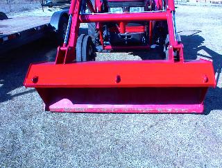

Here's another pic.....

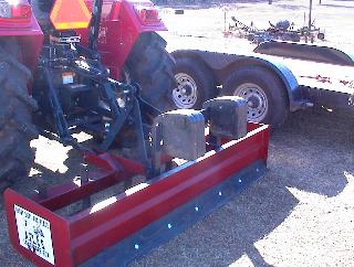

Here's the bracket and weights on the box blade.

   / Modification to new FEL w/pics. #4
Nice job !!!
looks really good. Keep us posted

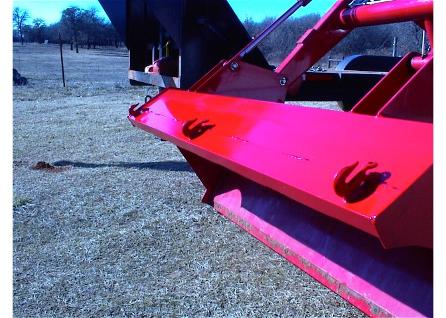

Thanks for the comments guys!!
Yeah, made the pics too small /forums/images/graemlins/tongue.gif
Here's some larger ones.
Chuck

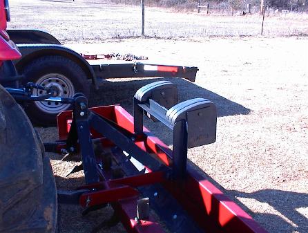

Here's a larger one of the box blade.

And another
<font color="red"> on edit: </font>
Sassafras, those are not much better, PM me your email and I'll send you the original size that shows detail.

   / Modification to new FEL w/pics. #9
Y2K-Nice work, those larger Mahindra are nice looking IMHO. Enjoy-keep the pics coming !!!
