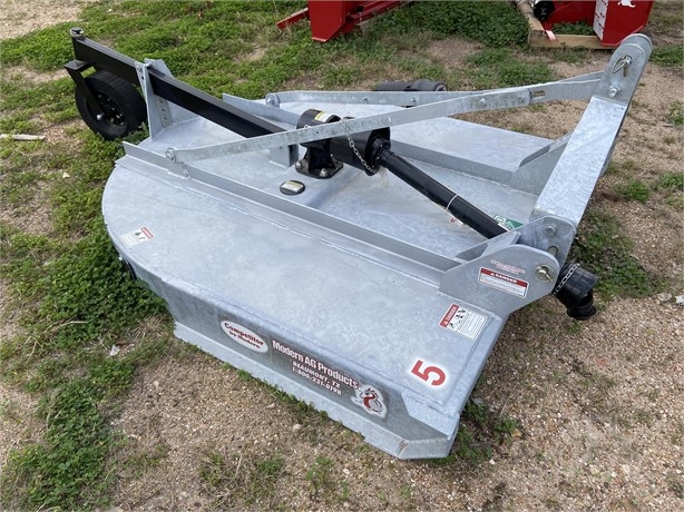

my tractor kioti ck 37 came with this bush hog.. all the stuff I read and saw videos about adjusting bush hogs does not cover this question?.. on this model for the arm lift pins on the a frame are 3 holes on each side.. my cutter was set on the bottom hole, so I raised it up 1 hole,, the manual does not mention any thing, I call the builder and talk to someone in parts who couldn't help either. so if you have a modern competitor cutter what hole is your arm lift pins at..? if I knew how to post a pic I would, thanks in advance.. c Falcon

Is this the cutter you have? Ken Sweet

not this one. I think this is a cat 2.. mine is a cat 1

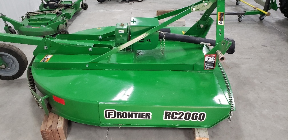

My 2060 Frontier has 2 holes. The lower set of holes are for a shorter tractor like the jd 2 series.
