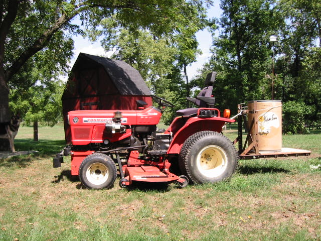

Padfoot,
Not sure if you have seen the YM 187Ds...Mine is an 18 HP, 4wd with Powershift. Don't know if the turf tires would work out real well for your horse farm, but I've had great results on my property (+/- 5 acres woods and lawn).
Rgds, Michael
