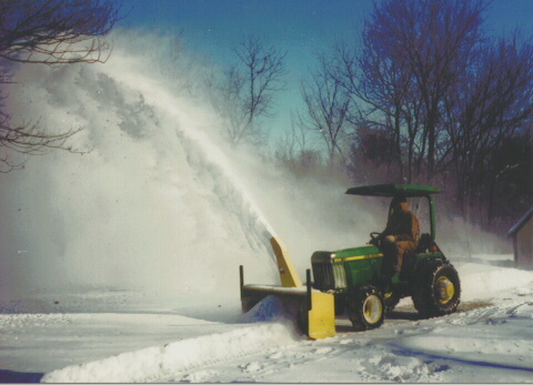

Here are a couple of pictures of my 955 with the 59 blower working a couple of years ago. You can see it sends out quite a plume. I recommend you try opening up the deflector to the widest position to see what that does. I always used it wide open. Run the tractor throttle wide open. That makes the PTO just slightly faster than 540 RPM, but it is not enough overspeed to worry about.
JackIL

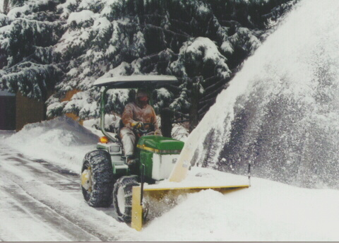

   / Model 59 snowblower #10
Another picture
JackIL
