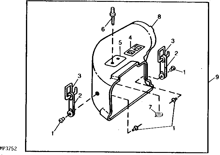

is the boot you got from the JD vaccuum system?
if so, it looks like it just holds onto the deck with
short bungy cords.
short bungy cords.
It might be the more complicated Powerflow system (where the far right deck pulley has another small pulley attached with a removable belt that powers a small blower).

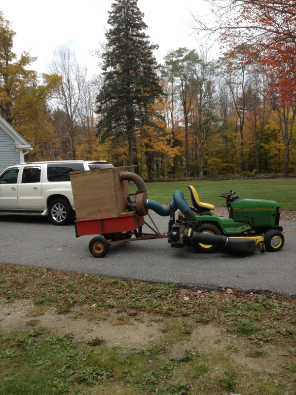

Not sure if this helps but here is my setup.... This thing never gets plugged and will shred anything!

How much ear protection do you wear with that thing - 3 engines - wow. How's your FPG? (feet per gallon). :laughing:
It is quite fun to see what it sucks up! The deck does not even need to be turning... The vac motors do like the 100LL at a rate of about two gallons am hour. Nothing but leave dust when I dump it!
