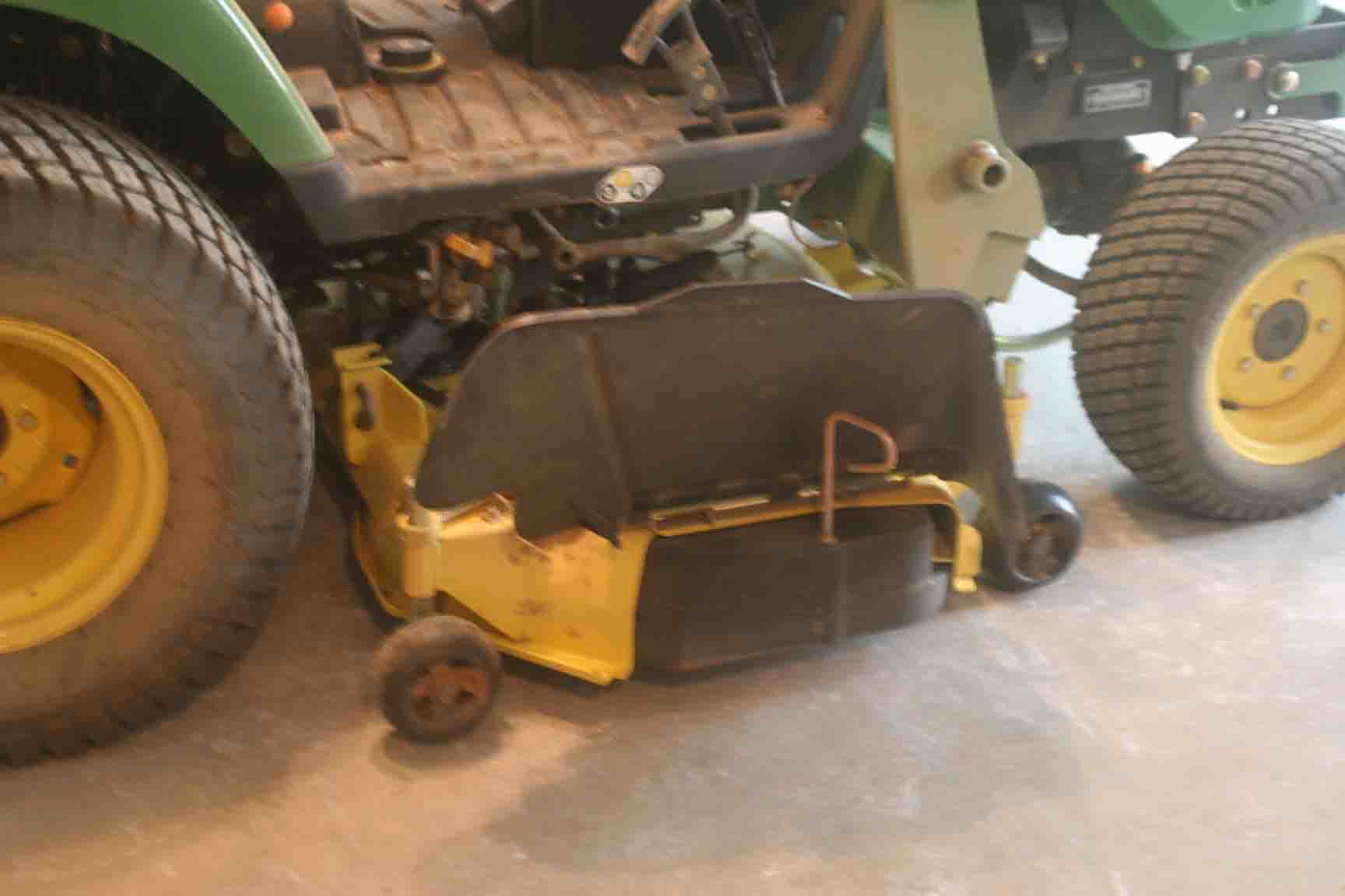

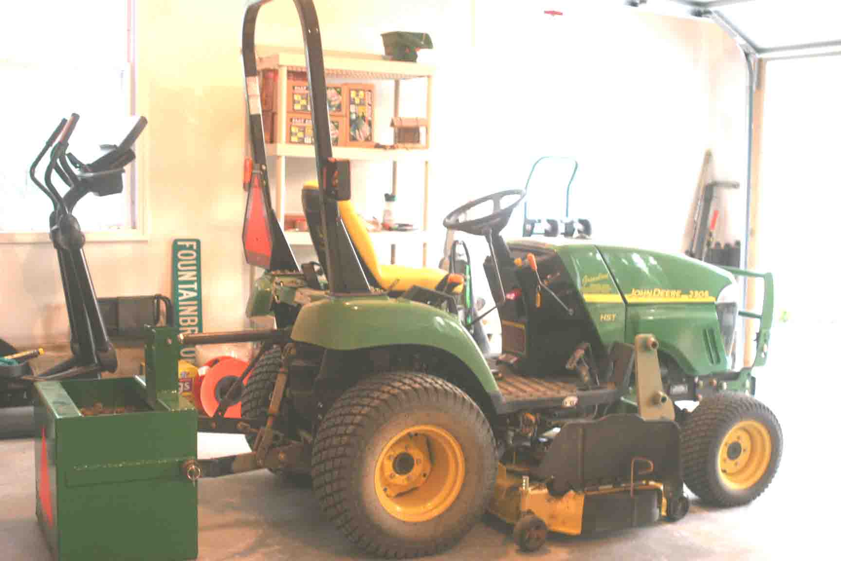

Cliff, here's the pics... Sorry it took so long to get them posted. I haven't taken off the deflector, but you get the idea.:) (The pics are blurry! I'll have to chastise the girl for that, she has pride in her camera work)... :D
   / MMM with no port
#9
Thank you for posting the pictures. Yes, this is what I had in mind. Which deck is that, by the way? Is it the 54"
Cliff
   / MMM with no port #10
Yup, the 54". My yard is small so I didn't think I needed anything larger. But I've learned since then! What did I learn, you ask? I learned that the flasher lights sound like playing cards in a bicycle tire when trying to cut under the deck. I also learned that the Hughesnet dish gongs like a bell when the ROPS knocks into it while cutting close to the stanchion. The 62" deck might have been a better option... :)
