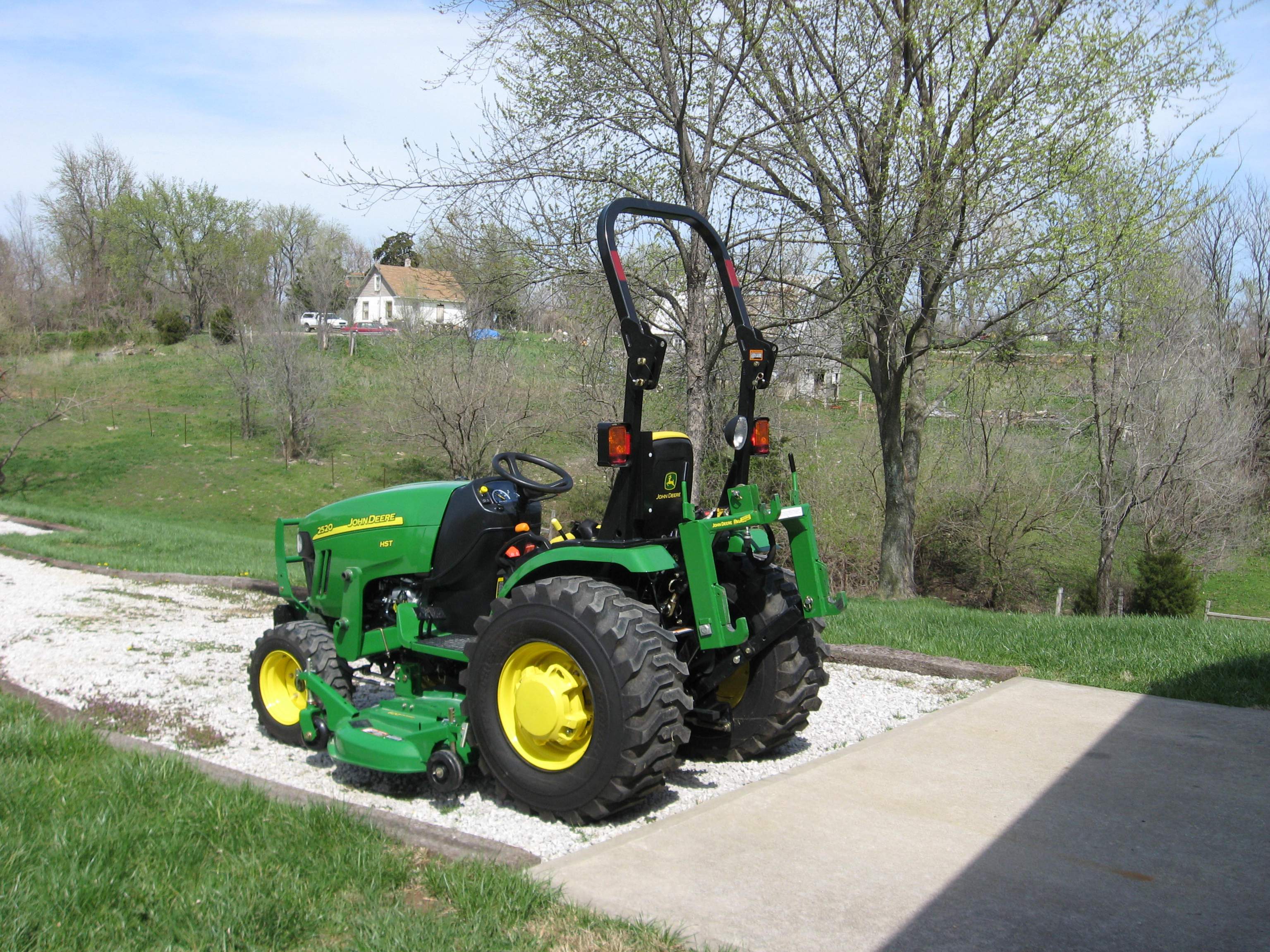

Does anyone know if you can run a MMM with the 46 backhoe subframe mounted on a 2520? I found a nice deal on a used 2520 TLB, but the BH subframe looks like it would be in the way if I added the 62" deck to it. :confused:

You are correct. You cannot have the 46 backhoe and MMM on at the same time.
However, changing back and forth isn't that bad, as long as you aren't doing it 4 times a day.

I don't know if it's the same but when I had my 2320 I had the BH and the MMM 62D deck. What a pain!. I had to take off the BH AND the two plates where the subframe pins held the BH on. Got rid of the 62D when I upped to my 2720 and bought a zero. (JD of course)

Yes but he has the BH and I found the deck, at least with the 2320, hits the BH undercarriage front mount brackets so you have to take them off too and they need to be unbolted.
Rob
   / MMM With Backhoe on 2520? #7
"Yes but he has the BH and I found the deck, at least with the 2320, hits the BH undercarriage front mount brackets so you have to take them off too and they need to be unbolted."
I did not see any interference between the MMM and the front backhoe brackets on mine.

Deere may have corrected this. I noticed on the newer 2000 series tractors (my 2320 was a 2006) the mounts are different.
