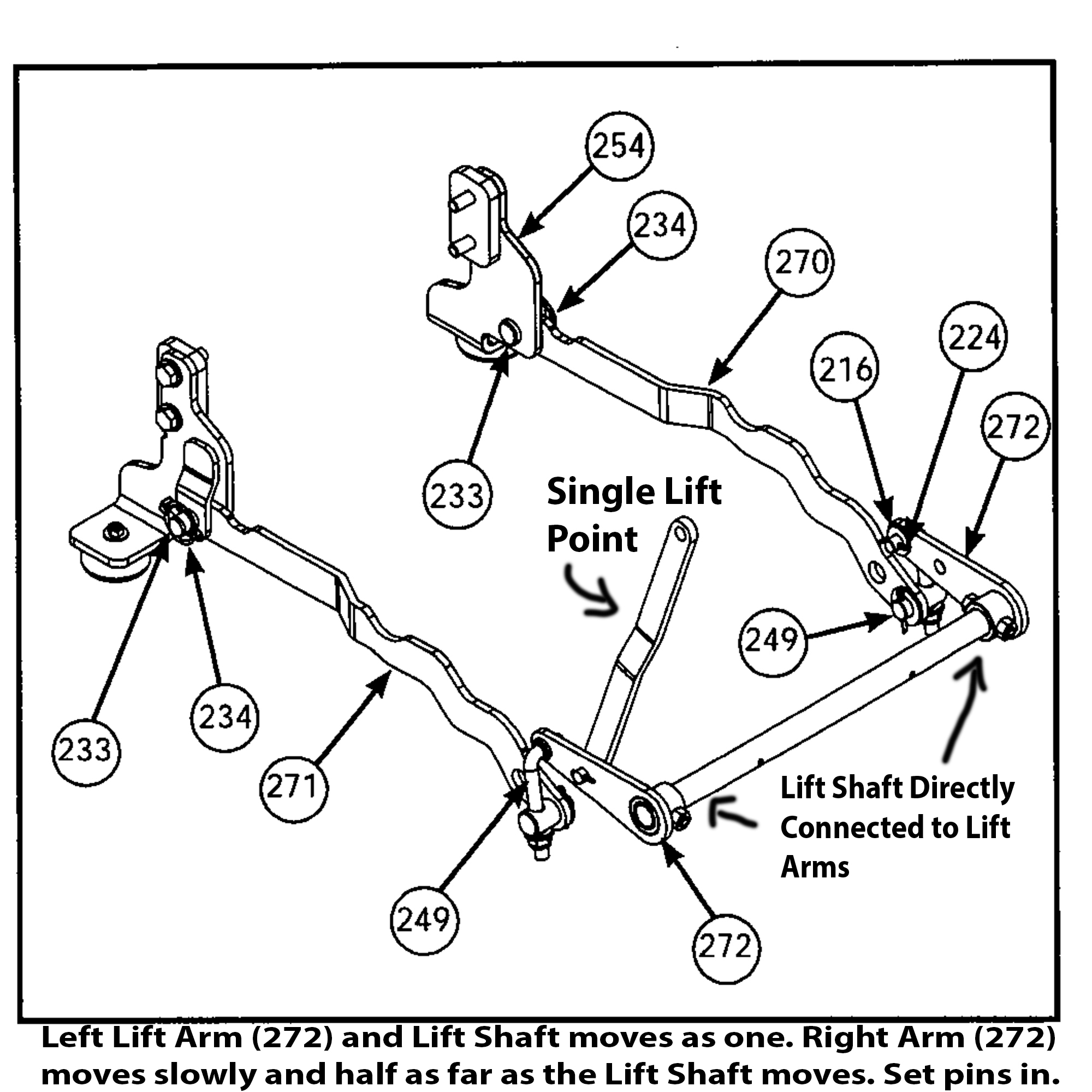

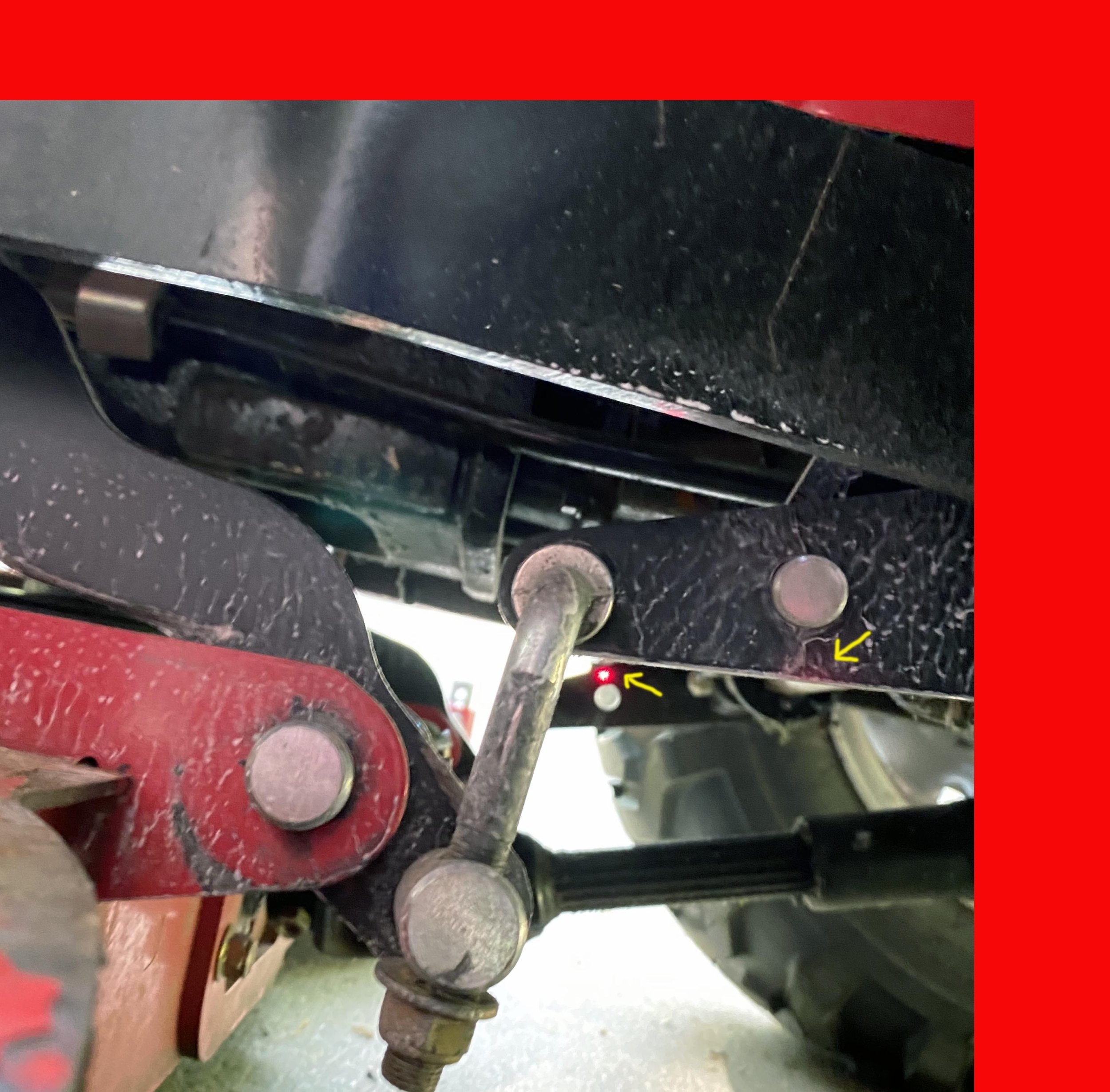

Ok, found something interesting. With the front bracket removed, I get full movement of the left rear MMM bracket and only half on the right rear MMM bracket.
The 3PH has its MMM attach point on the left rear side only, that moves a shaft, supplying lift to both rear brackets.
This shaft is not split, so equal movement on both ends would need to take place, and was confirmed by observation. The right rear bracket is properly attached to the shaft and pinned into place. Yet, does not have full travel. If the attach point pins were broken on the right side, the weight on the MMM would not allow any movement at all for that side.
Using a Laser Plumb, it's absolutely obvious that the right side bracket arm (attached to shaft) moves later than the left and only partially.
Somewhere, most likely at the shaft and attachment arm on the right side is a damaged pin or something.
FYI: The laser plumb is pointed exactly across from both attach points. The camera is angled to better see the red dots.
